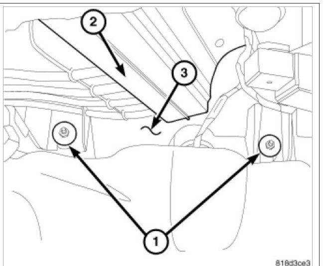

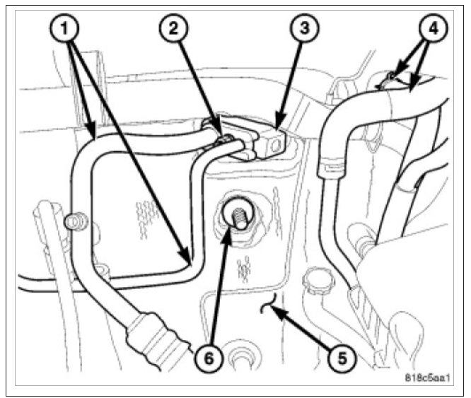

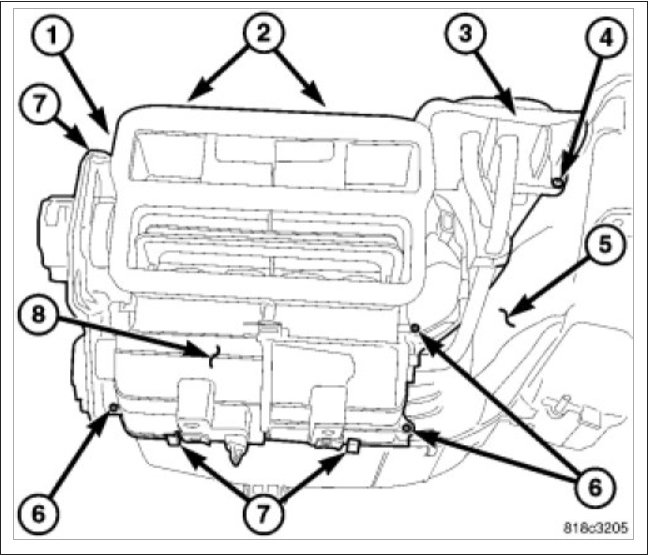

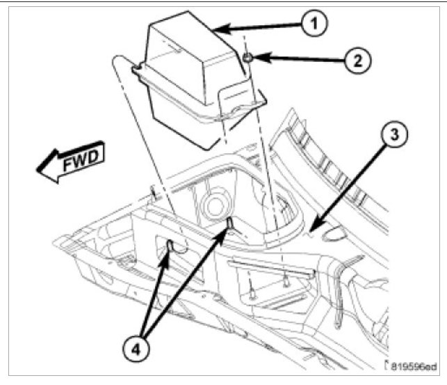

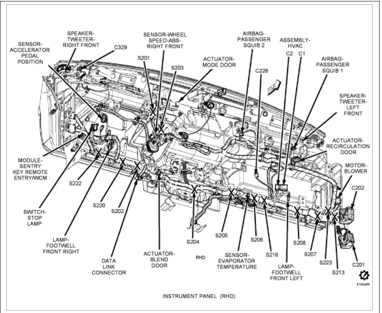

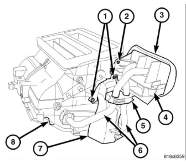

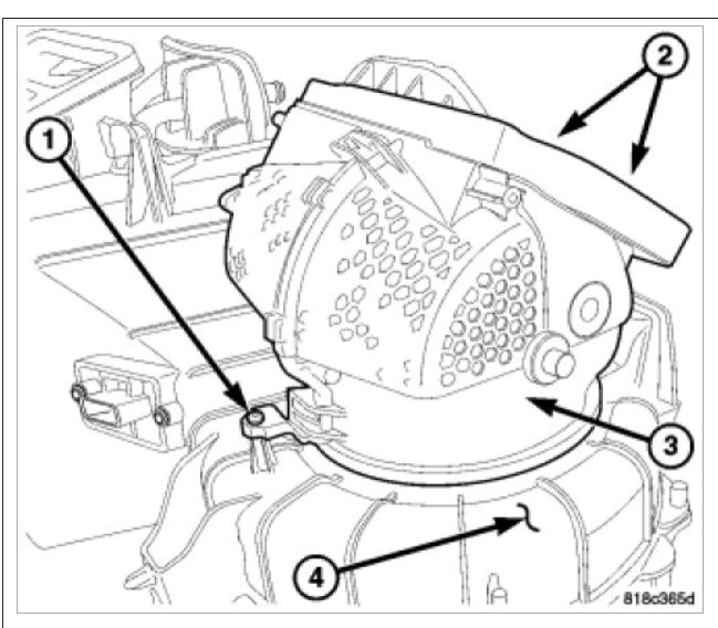

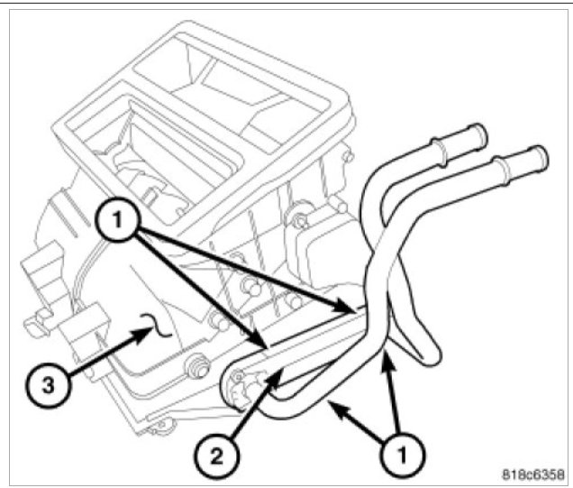

Thanks Ken. I need to replace the heater core. It seems like the whole dash has to come off. Please assist with picture from guide. God Bless, thank you. Kind Regards, Goolam.
Aug 16, 2018 at 11:45 PM
  • CAR REPAIR CONTRIBUTOR
  • 54,334 POSTS
Yes, the heater plenum with need to come out to replace the heater core. Does the car have AC? If so you will need to vacuum down and recharge the system.
and
https://www.2carpros.com/articles/replace-heater-hoses
Here are some below that will give you more detail not the same car but the procedure is very similar.
