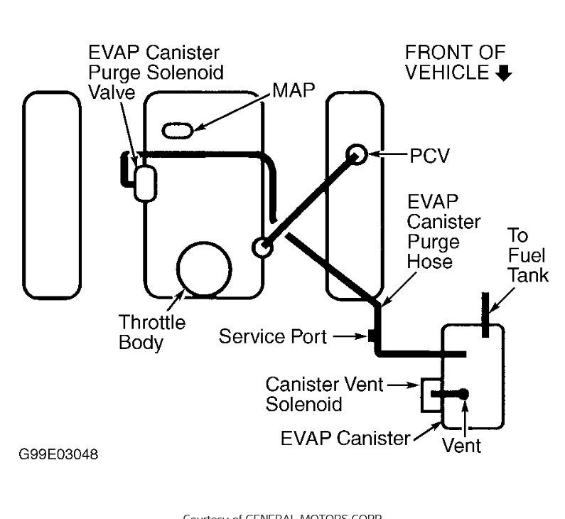

The PCV runs from the valve cover to (I have no idea) a black thing that has a vacuum tube running out of the top. The vacuum hose coming out of the top is broke off flush and I cannot for the life of me figure out where it goes. It has a lot of vacuum and when I put my finger over it the truck shuts off. My original issue is the truck has been running badly. I had a scan run and says number five cylinder misfire. I have recently replaced plugs, wires cap and rotor. I have good spark on number five and a brand new plug. So in my mind it must be a fuel issue. This morning I decided to put a new injector in the number five cylinder. In the process of taking off the upper intake I broke the cooling line off in the intake, which took a while to fix with out damaging the threads. I ended up fixing a couple other dry rotted lines but have two I am struggling with. By the way, the truck is running extremely rough so I do not know if the injector solved anything but I need to fix the vacuum issues so I can continue the illusive misfire saga. My Monday would really great if I could learn something useful.

It would be great if you could upload a picture of what you are talking about? I have this diagram here (below) it should help.

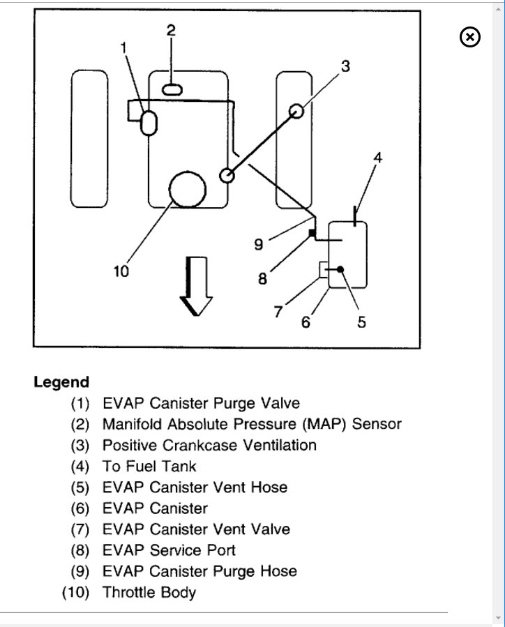

Need a picture of where the vacuum lines are routed.

There is the engine vacuum line diagrams as requested. Check out the diagrams (Below). Please let us know if you need anything else to get the problem fixed.

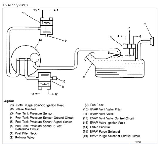

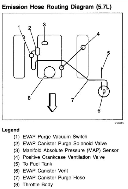

I need to see a diagram of the vacuum lines.

I've attached 2 pictures below of vacuum diagrams for your truck. Check out the diagrams (Below). Please let us know if you need anything else to get the problem fixed. Hope this helps and thanks for using 2CarPros.
