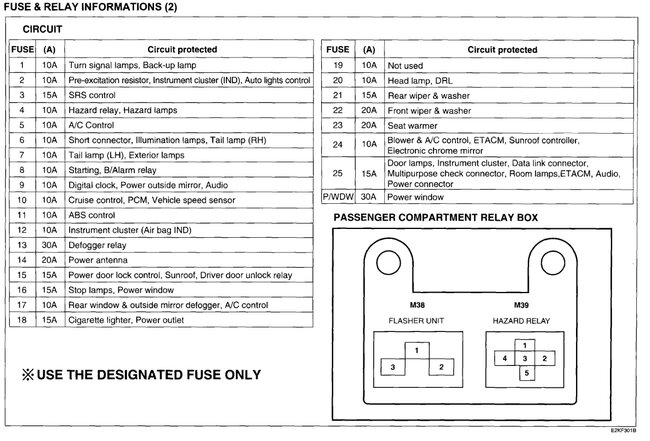

Turn signal blows when you turn the key to the on position?
2005 HYUNDAI ELANTRA
193,000 MILES • 2.0L • 4 CYL • 2WD • MANUAL
DNOLLIE
The turn signal blows when you turn the key to on position. Have disconnected all turn signals and it still blows. Replaced turn signal relay and fuse keeps blowing.
Sep 2, 2024 at 7:16 PM
  • CAR REPAIR CONTRIBUTOR
  • 54,334 POSTS
I would check the bulb sockets to make sure none of them are melted, also does this car have an aftermarket alarm system on it? If so, this can be the problem. I would unplug the flasher unit which is near the inside fuse panel. Also, this guide can help:
https://www.2carpros.com/articles/turn-signals-not-working-blinker
Sep 3, 2024 at 8:47 AM
