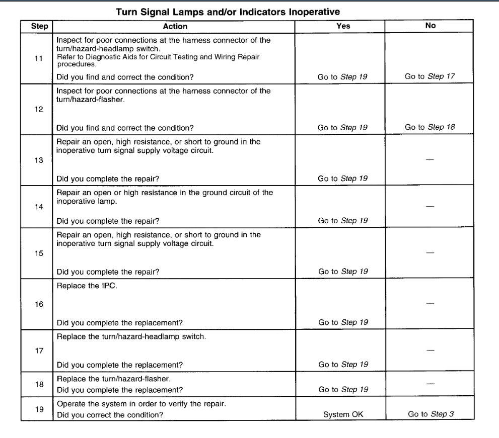

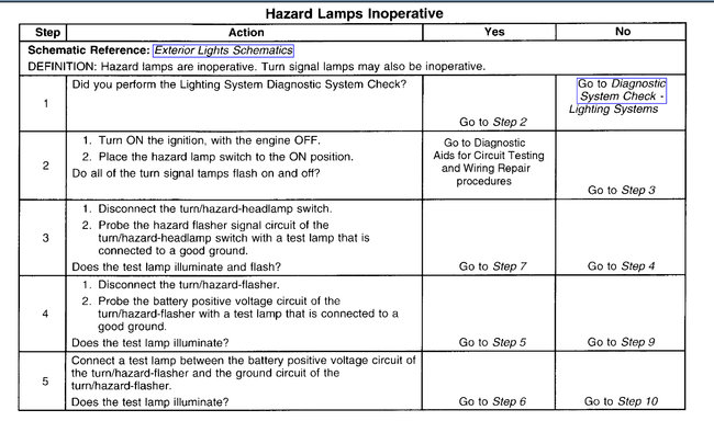

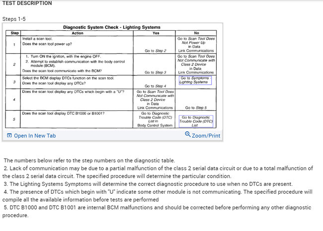

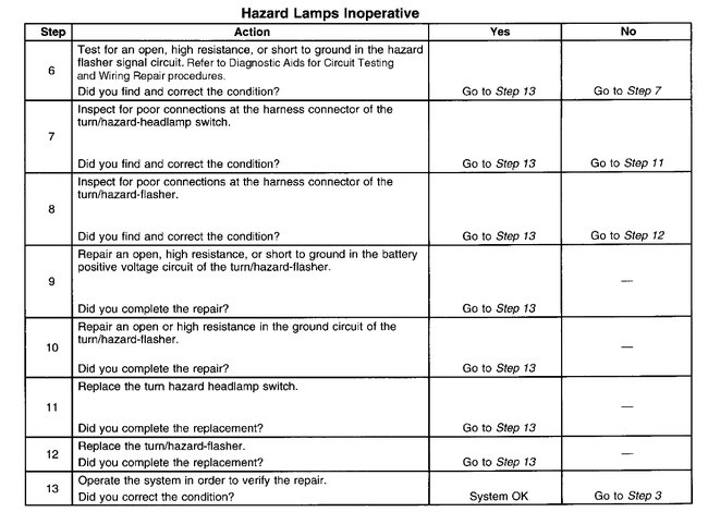

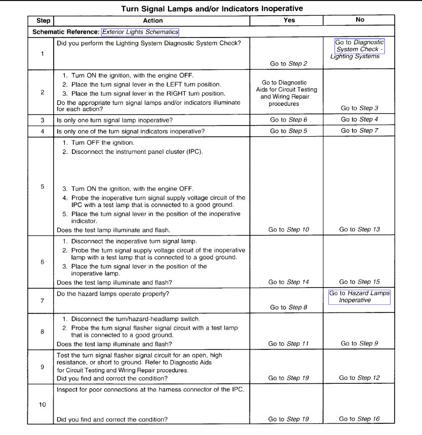

My left and right turn signal indicators that on the dash will work for a few seconds and then quit working. My blinker lights work while indicator lights work but stop when indicator lights stop.
Feb 16, 2019 at 6:21 AM
SCGRANTURISMO
  • CAR REPAIR CONTRIBUTOR
  • 4,897 POSTS
This could be a problem with your flasher module. I have included a guide for you to go through down below.
https://www.2carpros.com/articles/turn-signals-not-working-blinker
As well as a specific troubleshooting flowchart for your vehicle. if needed, down below in the diagrams. Please go through these and let us know what you find out.
