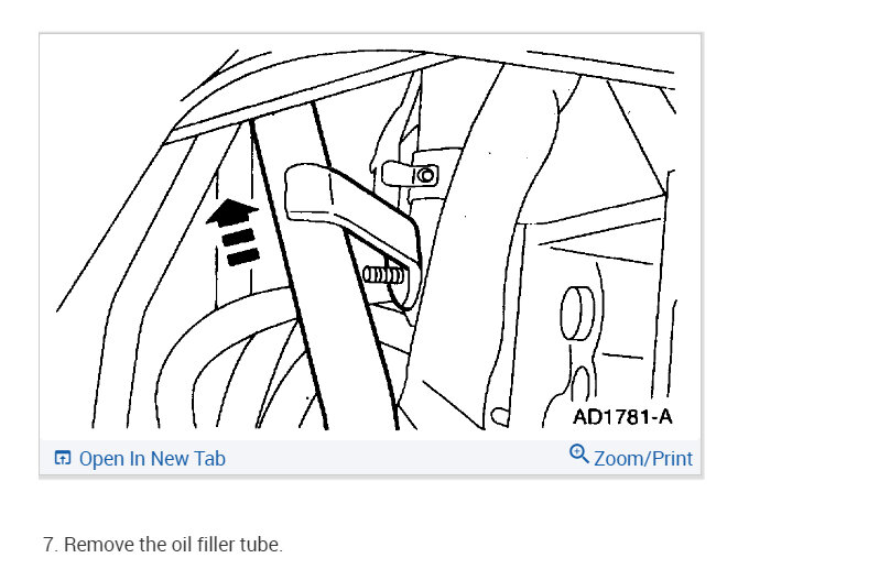

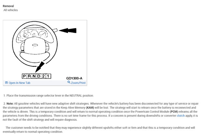

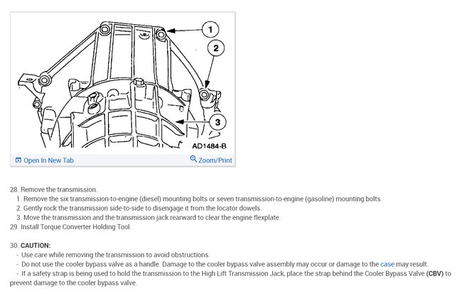

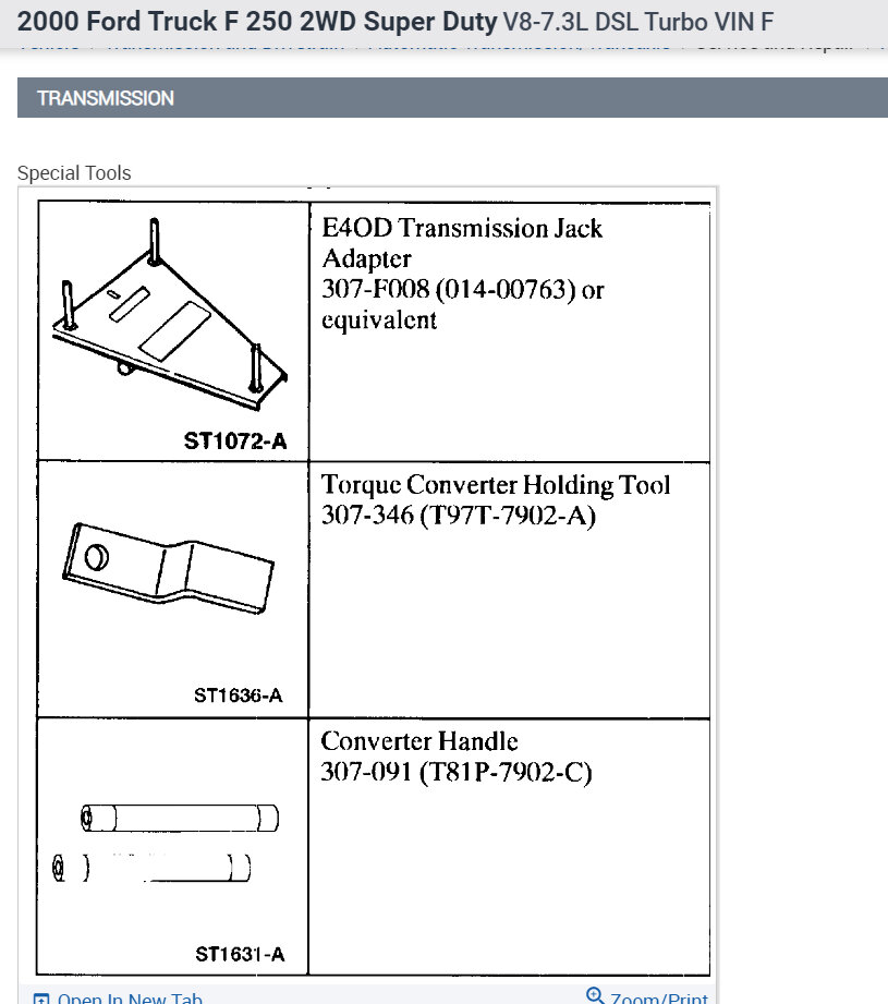

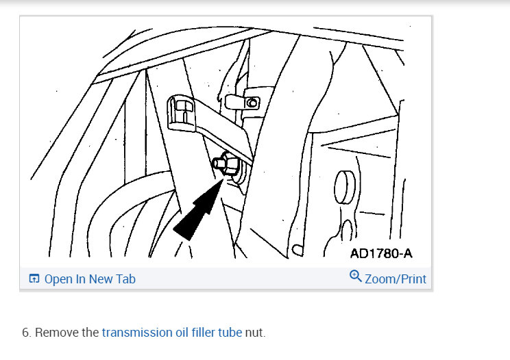

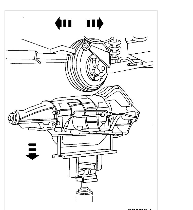

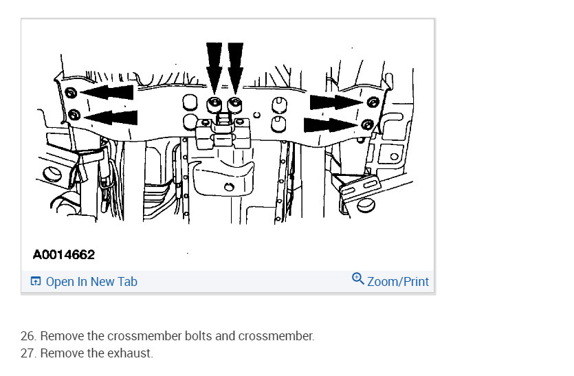

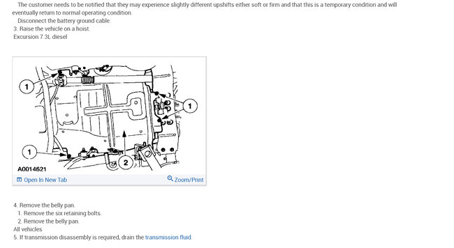

We need to scan for codes, and I need to ask when you put the truck back into park, does it make any noise? Also does it move in reverse? You may have broken the input shaft to the transmission, but I would run the codes first, this guide may help as well:
Please go over this guide and report back.
Apr 10, 2023 at 10:39 AM
ITSBAGEL
I will have my buddy with his scan tool come check for codes. There is no noise when I put it in park, and it doesn’t move in reverse.
Apr 10, 2023 at 4:04 PM
  • CAR REPAIR CONTRIBUTOR
  • 54,334 POSTS

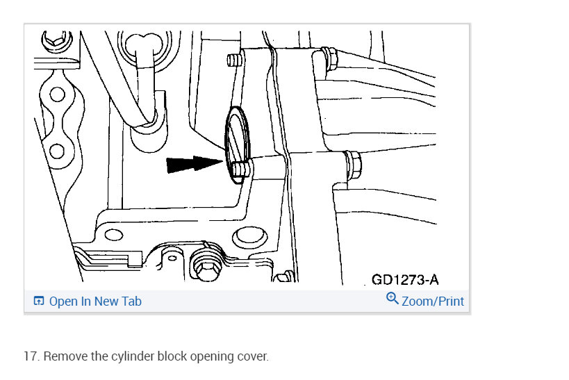

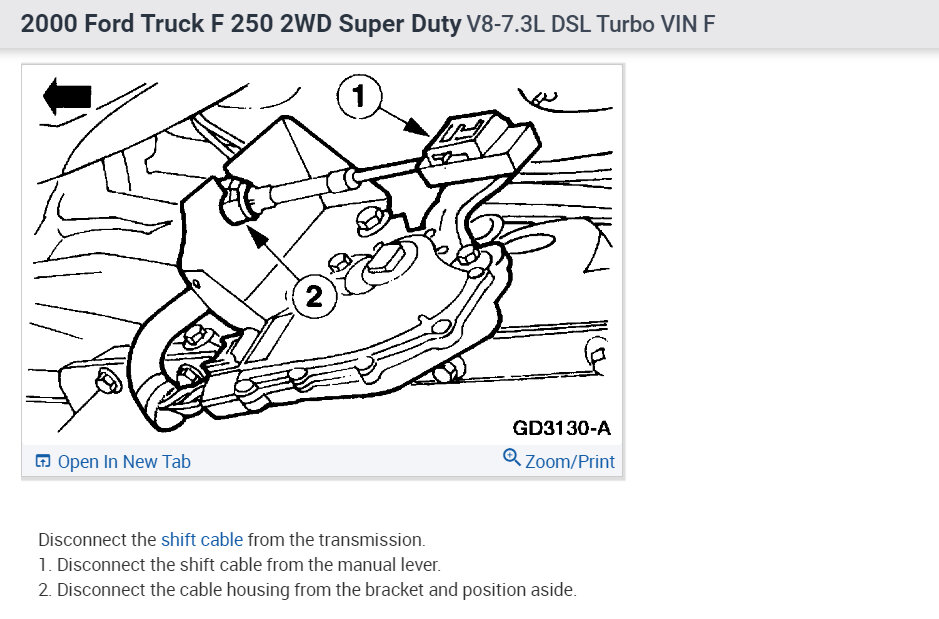

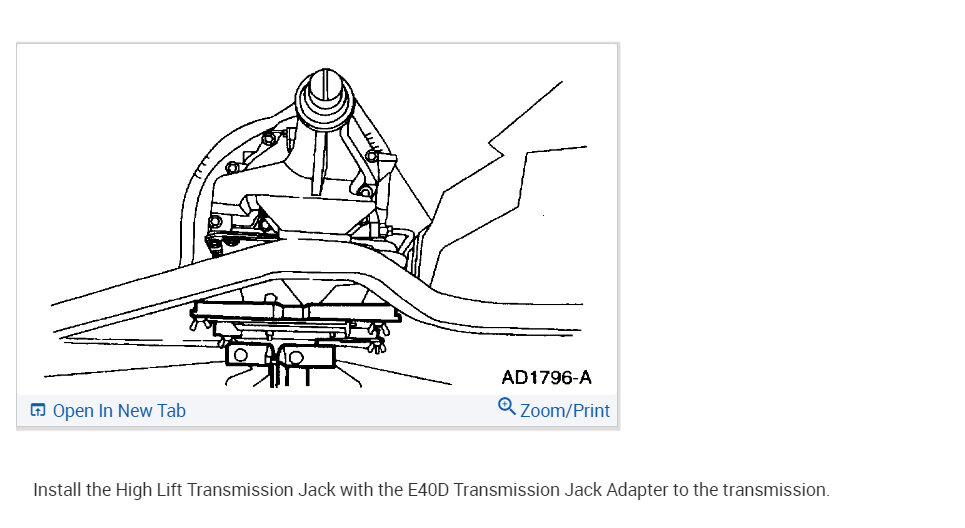

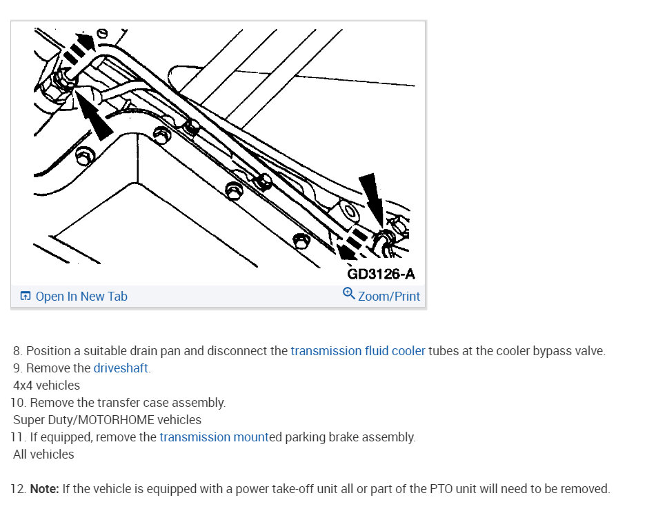

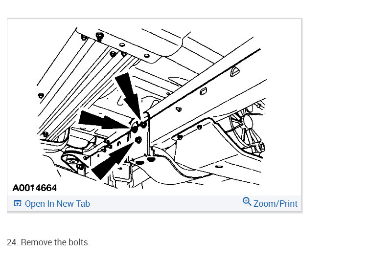

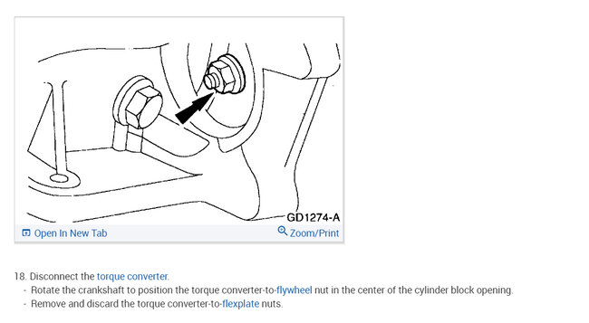

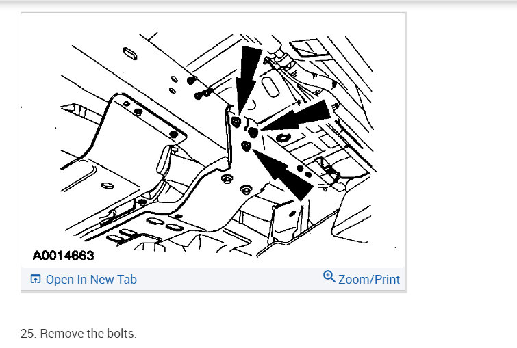

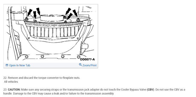

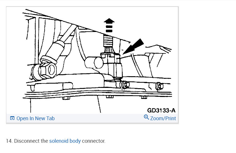

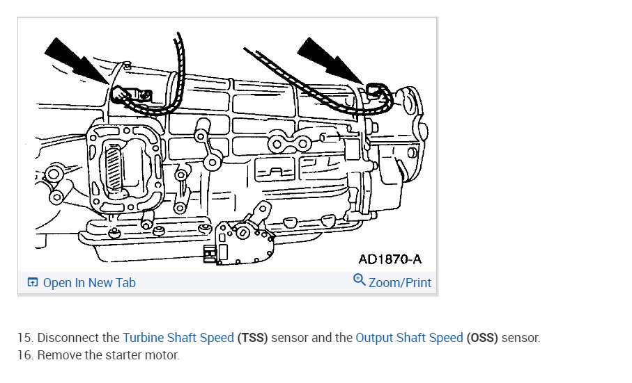

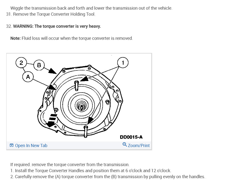

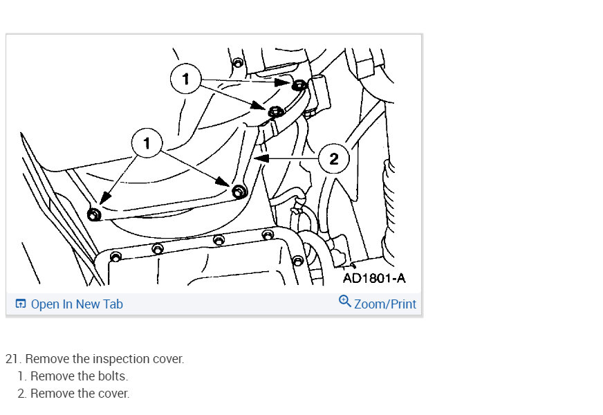

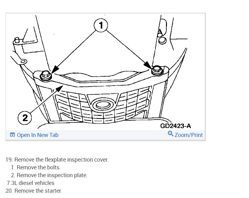

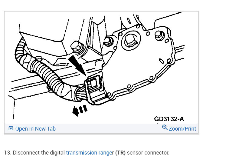

If the fluid is full then it sounds like something is broken inside. Here is how to remove the unit so you can get it rebuilt. Also, this video has the job being down on a similar vehicle so you can get an idea of what you are in for.
https://youtu.be/3vJAojsrfuU
