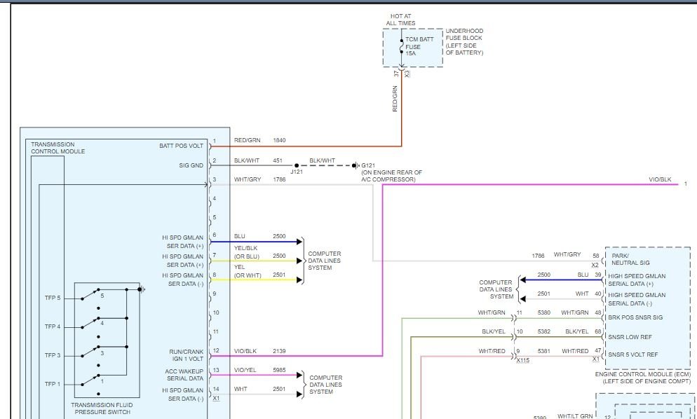

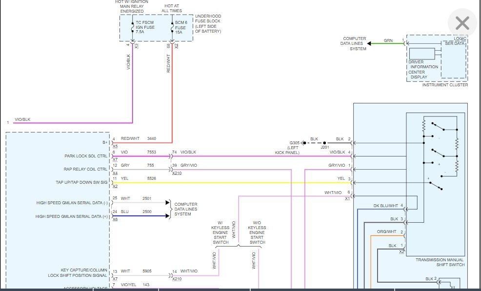

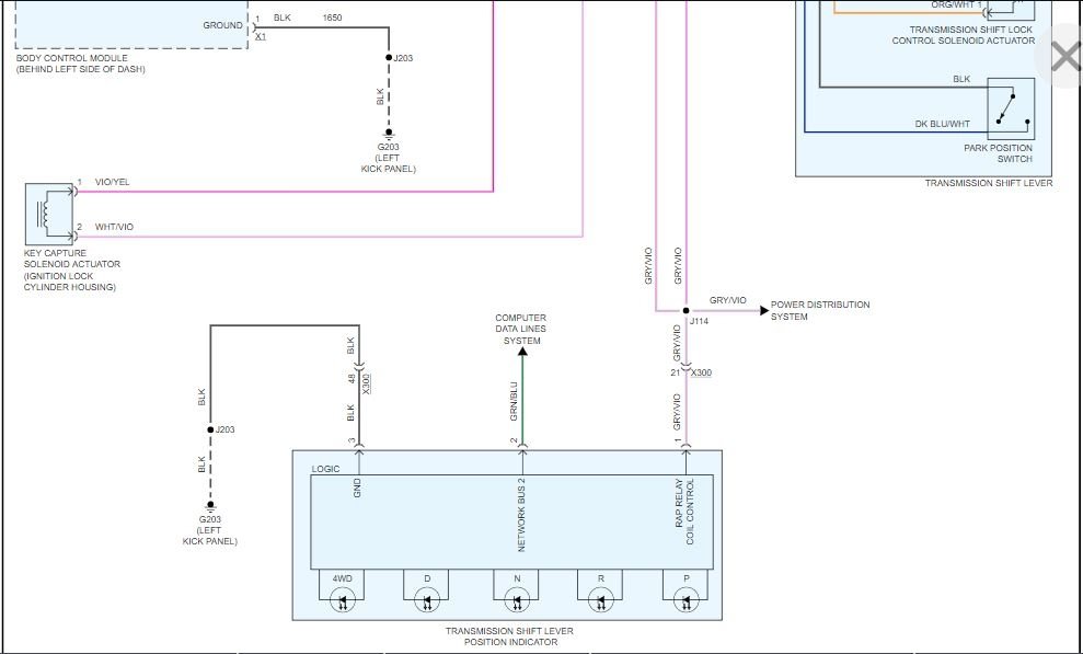

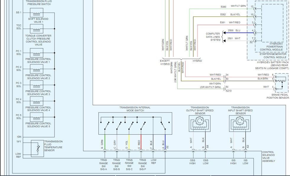

Recently my car's transmission light panel instead of showing the P R N D 1 2 M lights in normal colors they turn green and car does not drive. This does not happen every time and during driving if it happens the car loses power. Scanner gave faulty ground on harness and faults on all transmission modules. Got ground fixed and drove okay. Now after a week again it happens again green light on transmission panel and wont engage. Turn off and on then it will again engage. Can someone help with this or has somebody have this problem?
Sunday, January 10th, 2021 AT 5:21 AM
18 Replies
  • 52,797 POSTS
Good morning,
Can you give me the code numbers that were set?
How long since you changed the transmission fluid? The dirty fluid will cause this issue.
I attached the wiring diagram of the system for you to view.
Sunday, January 10th, 2021 AT 7:14 AM

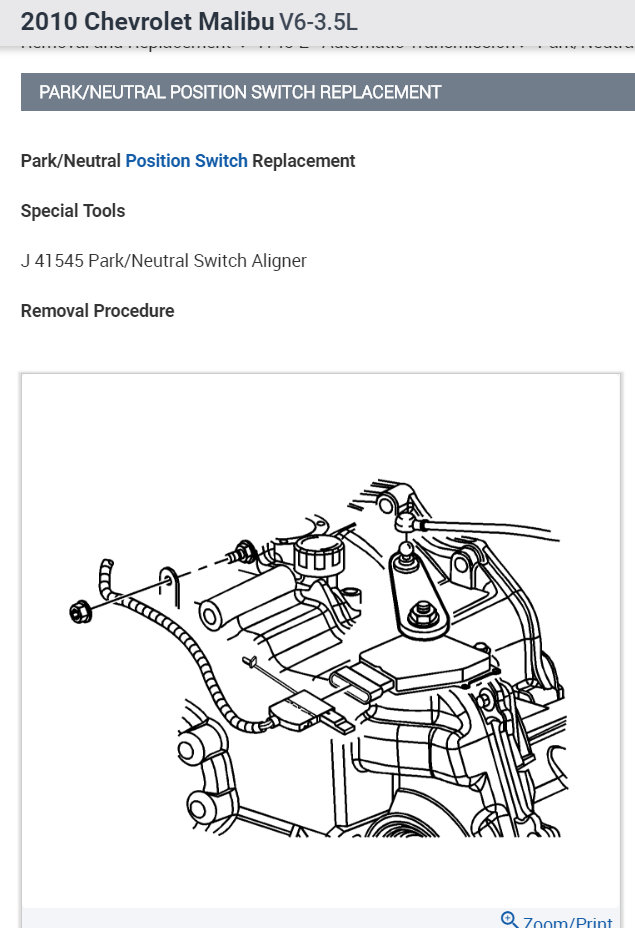

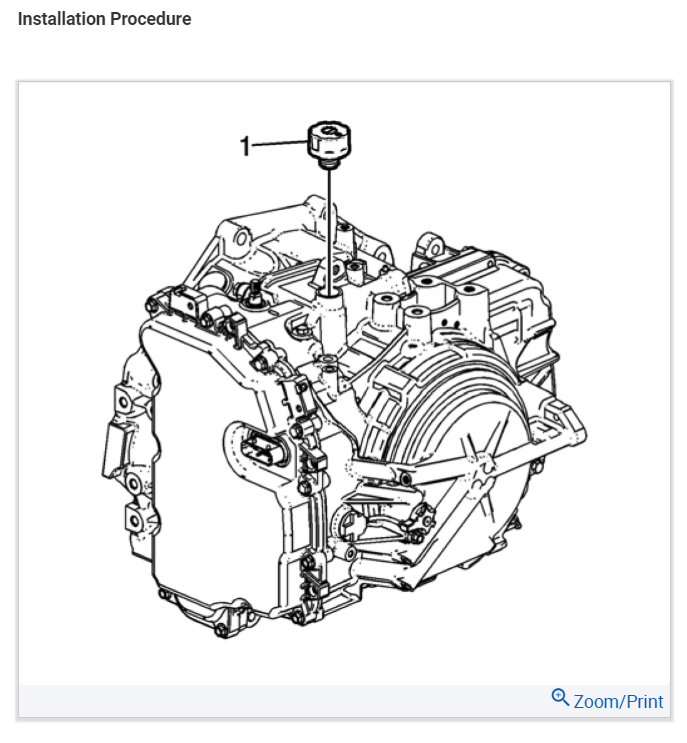

When I start the car and put it in reverse the car does not move. I take the car out to drive and the car like drops out of gear and then catches again. Just started this problem.
Done this to the wife and she is becoming afraid of it. Apparently upon reading there has been many problems with the transmission of this year of car. What should I look for?
Transmission oil was overfilled and is a brownish/black looking but does not smell burnt. Some metal shavings. Please advise if you would.
Friday, January 29th, 2021 AT 11:14 AM (Merged)
KEN L
  • MASTER CERTIFIED MECHANIC
  • 42,883 POSTS

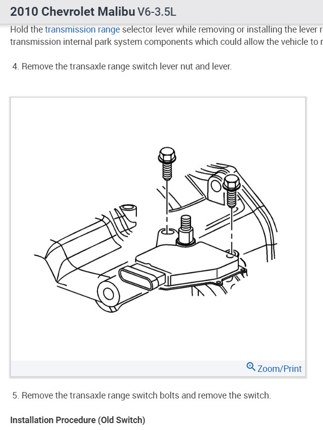

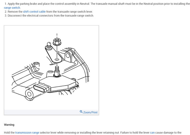

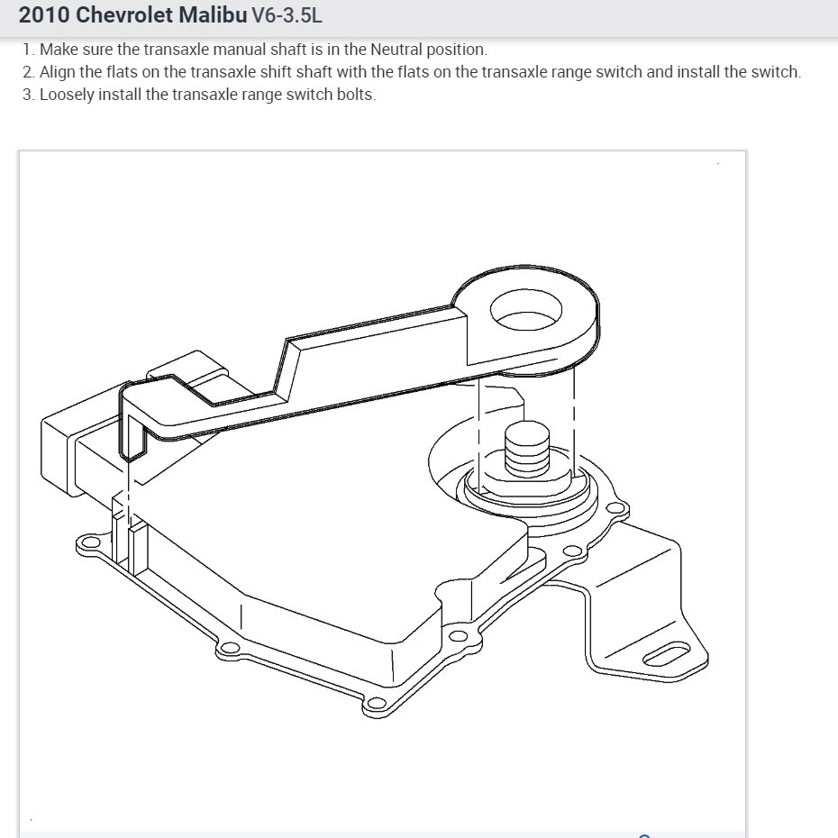

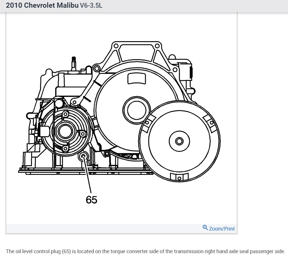

Please drain some fluid out of the transmission to obtain the correct level. Next can I ask if the gear selector lights are working correctly because if they are not the transmission range sensor needs to be replaced. Here is a diagrams to help you see what you are in for when doing the job:
FASHOIN
  • 6 POSTS
You are showing me a diagram for a 3.5.
This is a 2.4 Malibu?
2010 Chevrolet Malibu 2.4 engine?
Does this work the same on 2.4?
Thanks, Rick

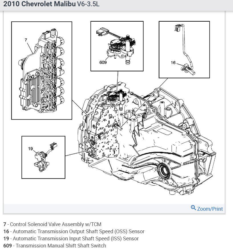

Yes it is the same. Let try to service the transmission. Here is a guide and diagrams to show you how. Also, lets run the codes to see if a turbine shaft speed sensor is out.
and

I took the fluid check plug out and it seems like the transmission fluid was overfilled almost a gallon.

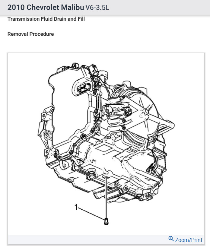

Yes, I would drain it all and refill with new fluid careful not to overfill. Here is a guide to help you see what you are in for when doing the job:

Okay, everything is changed and done. No change is seen now what? Spent a lot of money to have nothing change? $10.00 a quart for eight quarts of transmission oil plus $55.95 for filter.

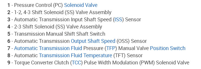

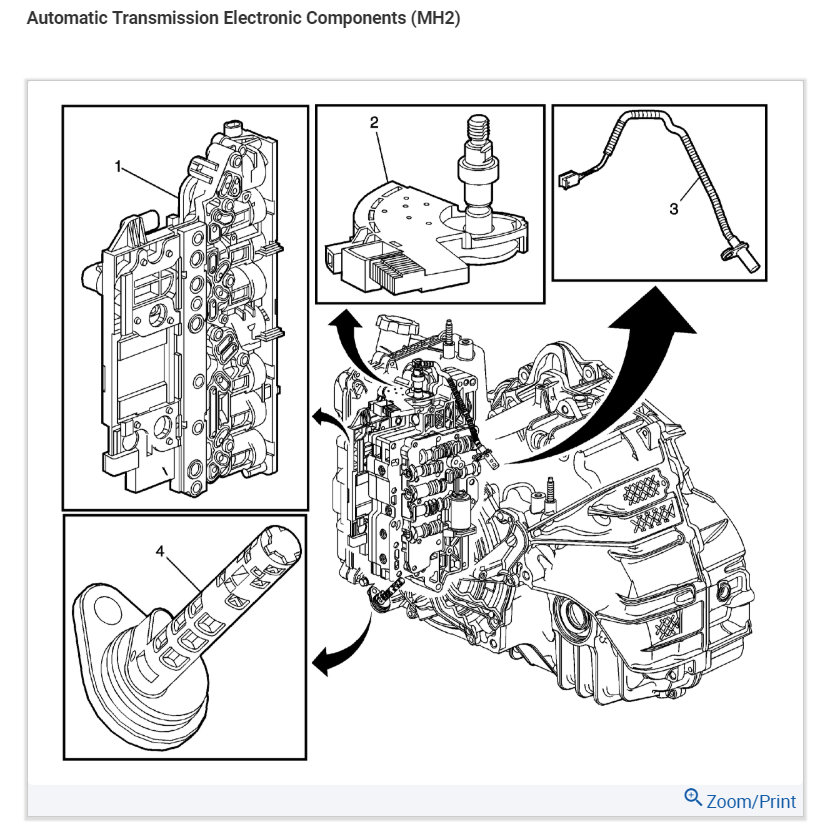

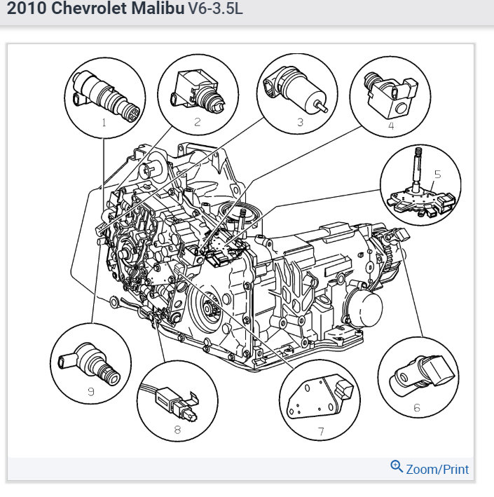

It is worth a try instead of installing a rebuilt unit when all you had to do is service the unit. The next thing I would try is to replace the pressure control solenoid which when it goes bad will dump pressure causing the transmission to drop out of gear. Let me know.

I do not believe I have a diagram for solenoid?
Thanks, Rick
KEN L
  • 42,883 POSTS
Oh sorry, here you go. Check out the diagrams (below). Please let us know what happens.
