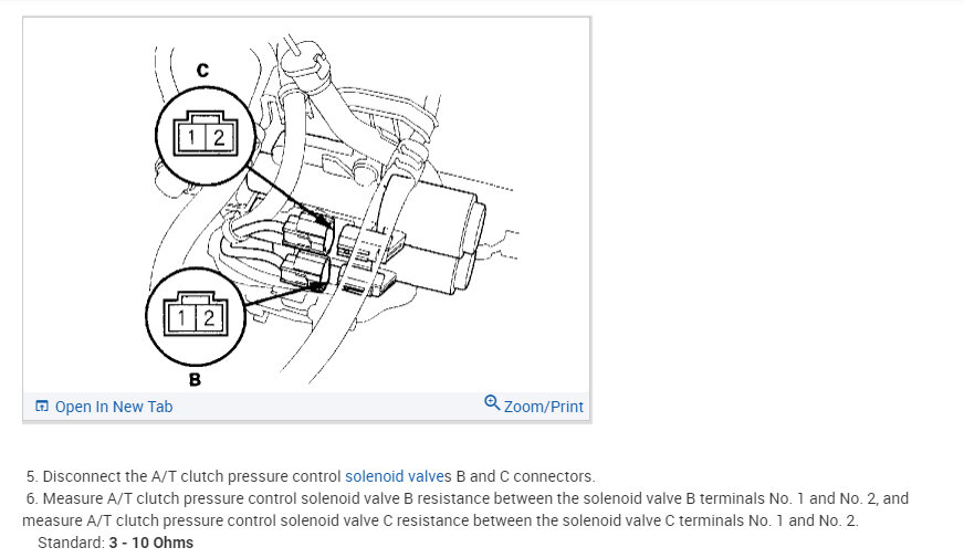

I'm curious if there is a circuit going from the solenoid harness to the output shaft sensor connector. And I remember there is a Honda test for these solenoids, you jump a wire from the positive terminal to terminal #2 for solenoid B, but I am unsure of the terminal # for solenoid C.

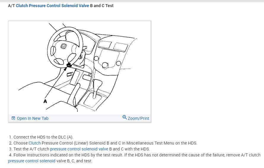

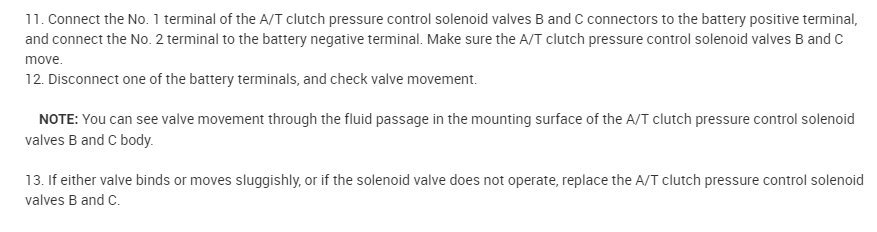

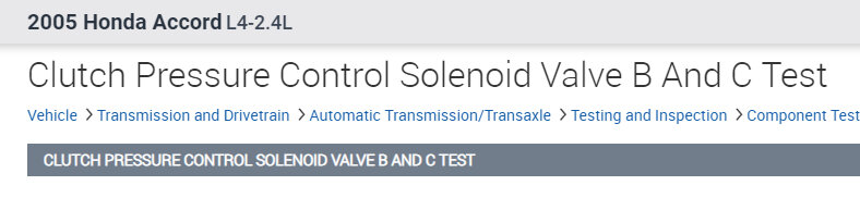

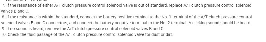

I attached the diagnostics related to solenoids B and C. Take a look through them and let me know if they help.

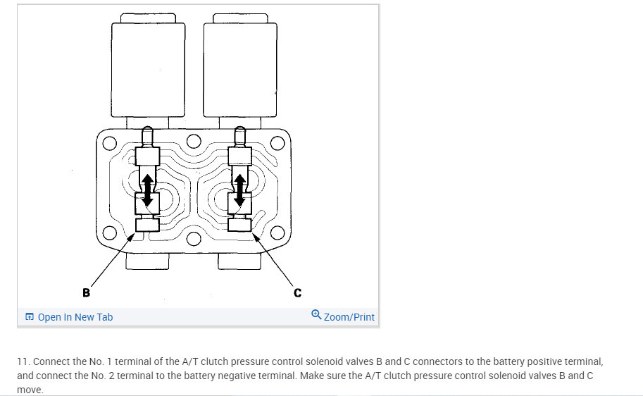

Thanks Joe, but I am referring to the shift solenoids inside the transmission. There is an 8-pin connector and allegedly you can jump the positive terminal to the harness and engage them individually and hear a click.
If there is no click with a new solenoid. We can confirm there is an electrical issue? And if it does click but no engagement with the trans, we could condemn the transmission?
Feb 9, 2023 at 5:24 PM

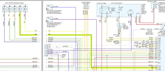

I just went through every schematic I have and cannot find a connector view. I can tell you that the power supply to shift solenoid C is provided via the PCM and the wire you are looking for at the connector is green.
If possible, locate that wire and determine the pin it connects to. If you apply voltage, you should hear the solenoid engage.
Sorry about the pinout. I have no idea why it isn't listed.
Let me know if this helps.
See pic below.
Feb 9, 2023 at 6:47 PM

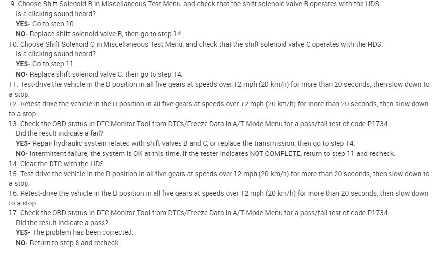

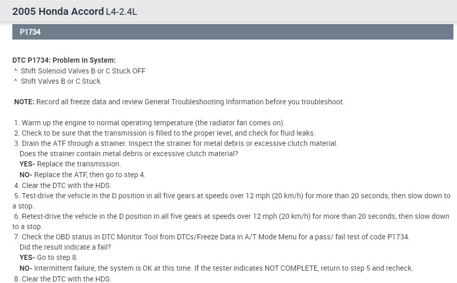

The P0780 code is a general DTC that is stored at a time the P1734 is set. So, we need to focus on P1734.
I attached the diagnostics below. It will indicate checking shift solenoids B and C. It will also request you drive the vehicle (which isn't possible).
Allow the engine to reach operating temperature and drain the transmission fluid as described checking for evidence of internal damage.
Let me know what you find.

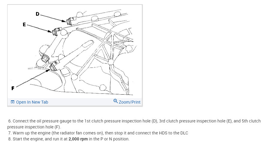

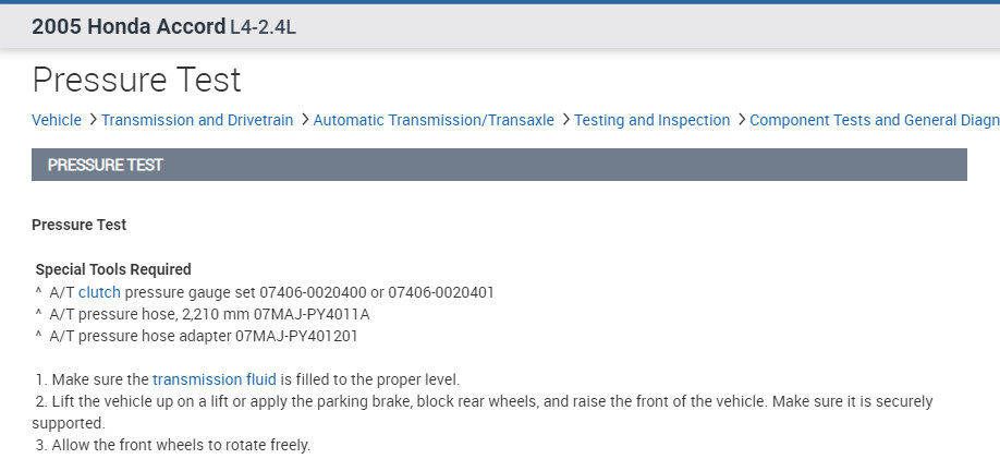

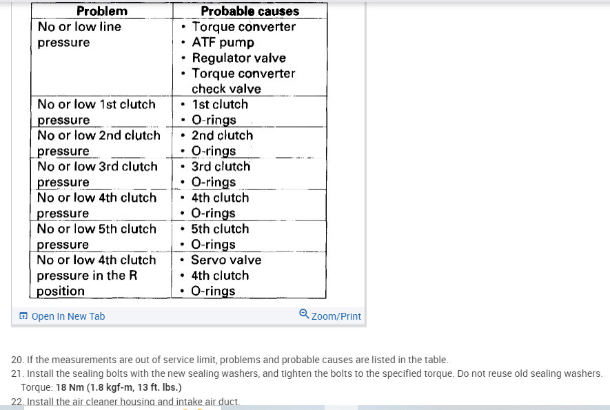

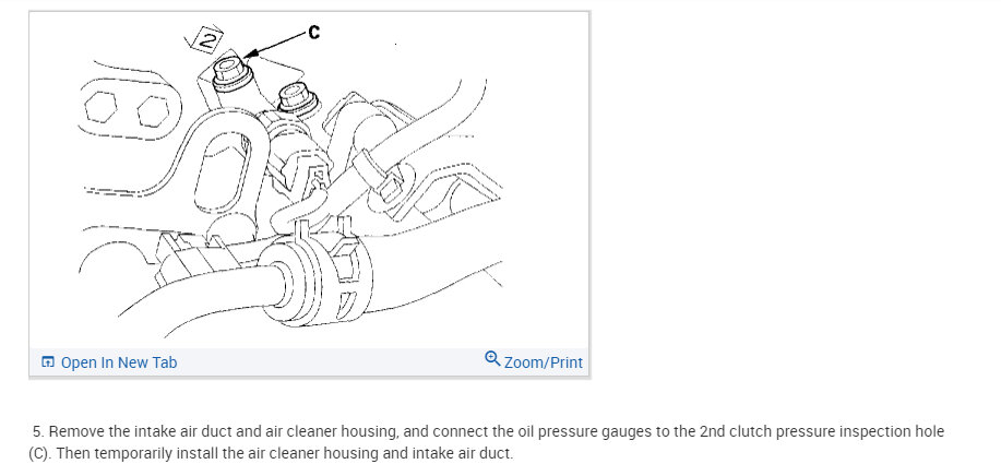

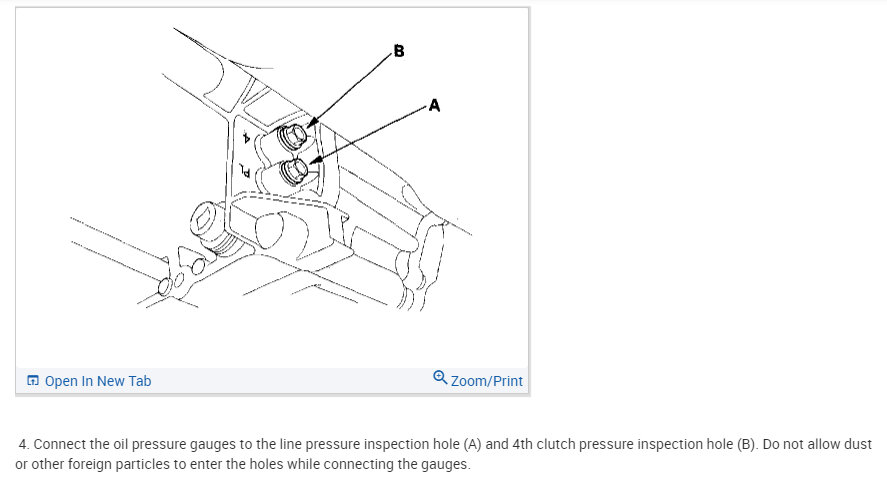

My other concern is, the testing of shift solenoids is in regard to the clutch pressure solenoids B and C on the case? Or the internal shift solenoids B and C inside the transmission?
Feb 16, 2023 at 4:55 PM
  • CAR REPAIR CONTRIBUTOR
  • 110,190 POSTS

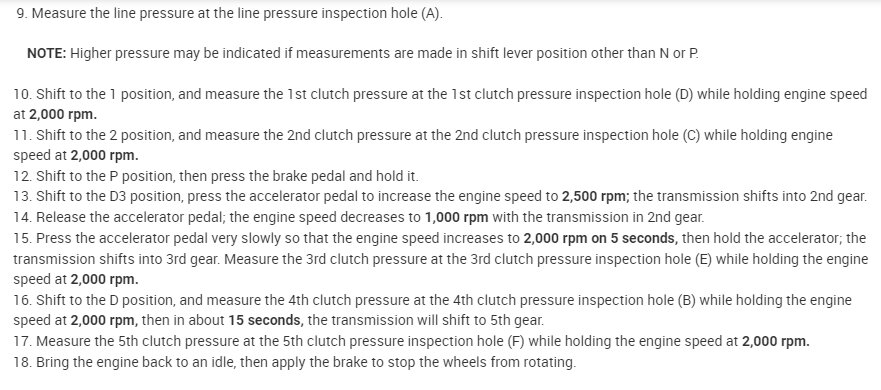

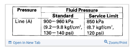

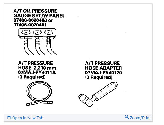

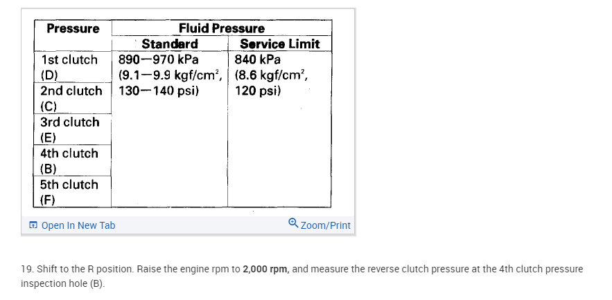

The shift solenoid valves are external. The shift solenoids are internal.
The shift solenoid valves are responsible for line pressure. Since you have no response when shifting, that would be my first suspect.
At this point, you may be better off checking the line pressure to see if it is low. I say that because of no gear engagement.
I attached the directions below for testing line pressure. Take a look through them and let me know if you are comfortable performing them.
Feb 16, 2023 at 7:25 PM

I am comfortable doing it, but I don't have equipment to check the line pressure. I thought about removing the in-line filter on top of the transmission and seeing if that gained some pressure. Also, I think about removing the B and C solenoid that the previous tech replaced and checking if there's something in the screens.
Feb 17, 2023 at 7:32 AM
  • 110,190 POSTS
If you perform the line pressure testing, it may prevent you from taking things apart again. I realize most people don't own the gauges needed, but often times a parts store will have and lend one to you. It's just a thought.
On the other hand, your suggestions are certainly relevant and are a good idea.
