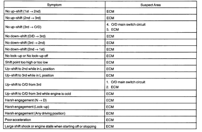

Good afternoon,
Are there any codes set in the transmission?
Have you changed the fluid? That is important.
The throttle position sensor is the primary sensor for shifting. If it was the sensor, it would code. If there is no code, it is pointing at the ECM as the failure.
