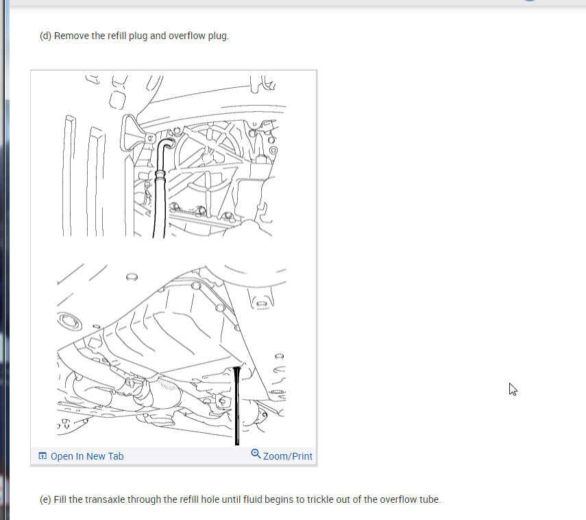

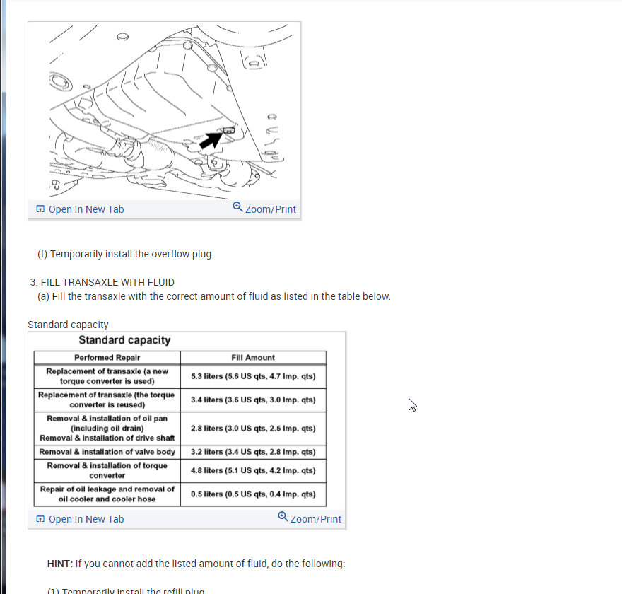

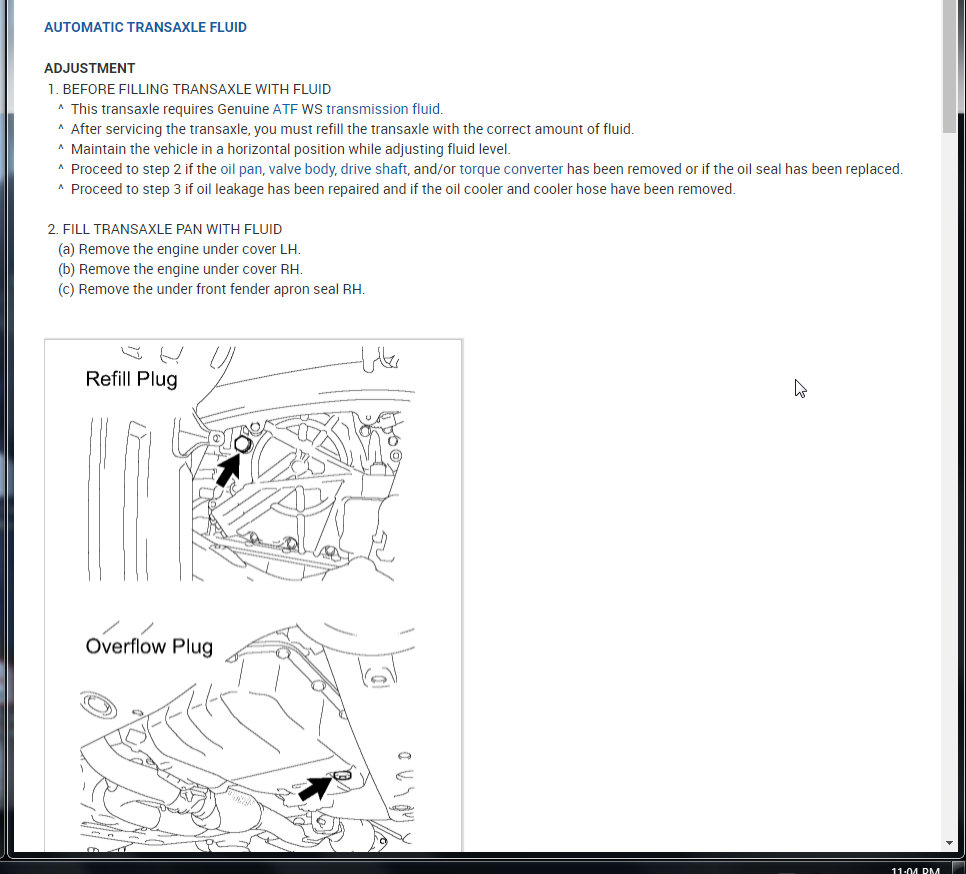

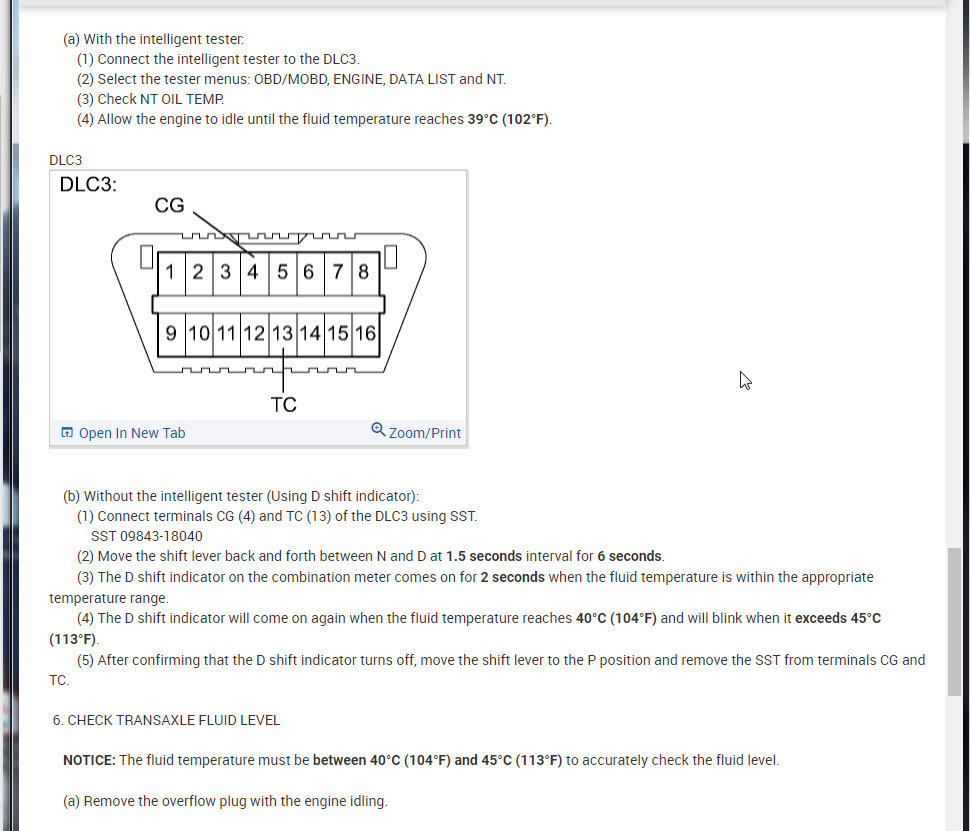

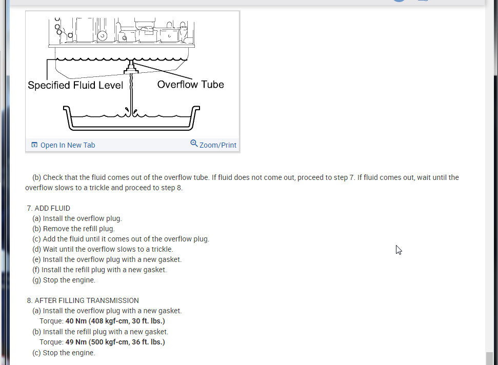

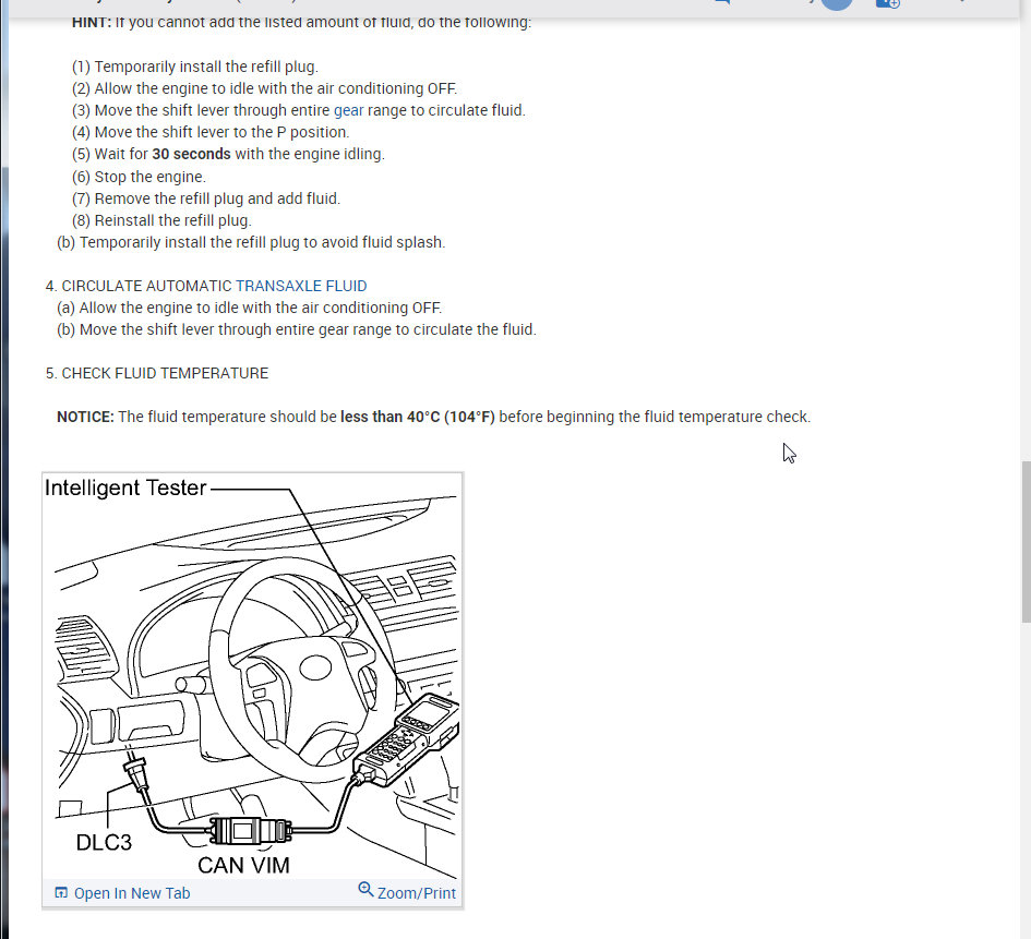

This could be a fluid issue so even though you don't have a dipstick we will need to check the fluid.
I would suggest servicing the unit. Here is a guide that will help with this:
Below is the process from the manual that will show how to properly fill the unit so that we know it is at the right level. However, we need to know the condition of the fluid currently as if it is burned then that will be good info.
Thanks

thank you the pictures were super helpful. the fluid is black no particles in it's just black.
