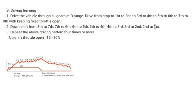

not sure why they made a 6 speed and an 8 speed transmission on these cars, one is the Z 6 speed, if I decide to change the transmission on it, which is the 8 speed, does it need programming?

Ya i know. Am asking if i changed it with another used one that is the ssme type will i need any type of primary grogramming?

Ya i know. If i install same type will it need programming?

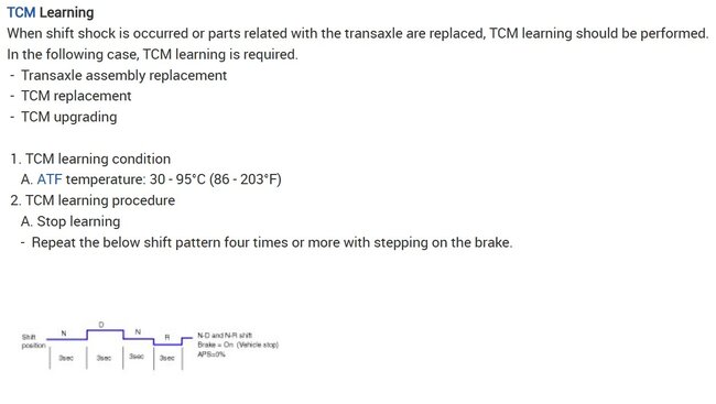

OK, if you swap for the same version it still needs programming because the VIN sets a lot of parameters. However you can do the re-learn without a scan tool. Disconnecting the power erases the learned items. Then follow the directions attached to teach the new unit.
