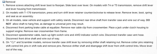

Need to change transmission
Do you
have the same problem?
Sunday, March 6th, 2016 AT 5:24 AM
HMAC300
  • EXPERT

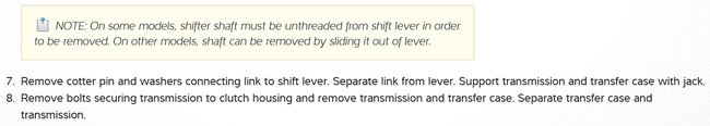

See pics install is pretty much reverse of removal
