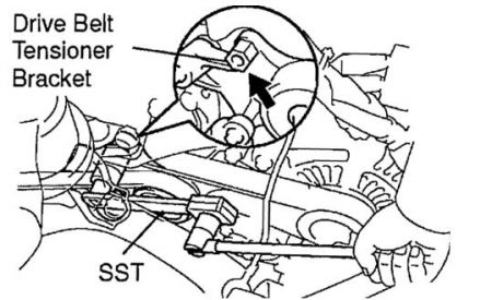

procedure for replacing serpentine belt on 2001 rav4
Tuesday, September 10th, 2019 AT 5:53 PM (Merged)
BLUELIGHTNIN6
  • 16,542 POSTS
Using a breaker bar and appropriate sized socket (or appropriate drive belt removal tool), relieve the belt tension by rotating the tensioner. Do this slowly over about 3 seconds.
Remove the belt from the pulleys.
Installation is the reverse of removal. Be sure to follow the belt routing diagram.
https://www.2carpros.com/forum/automotive_pictures/261618_Noname_185.jpg
