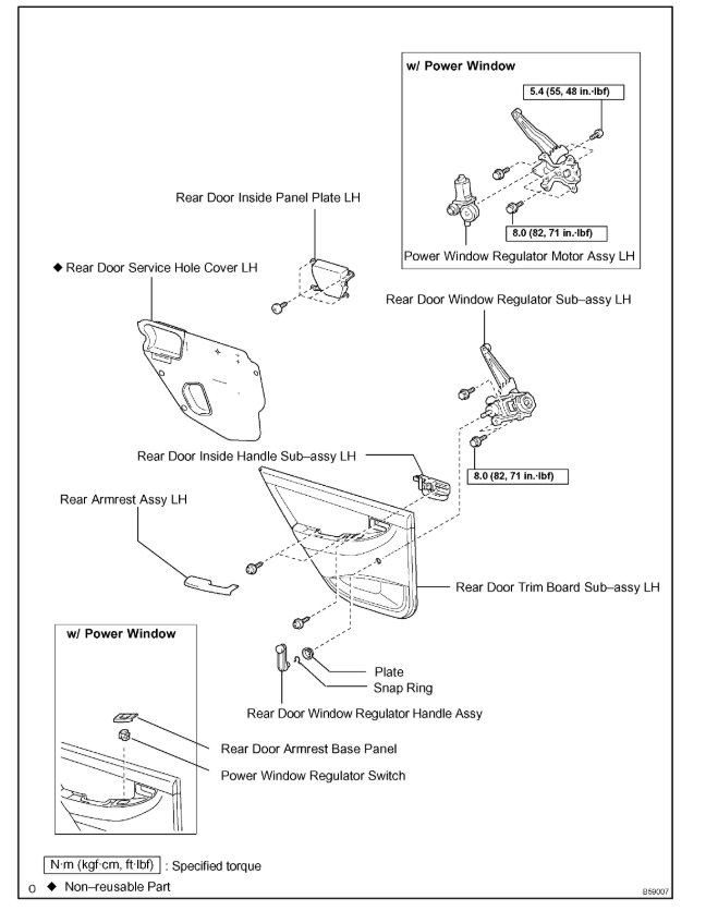

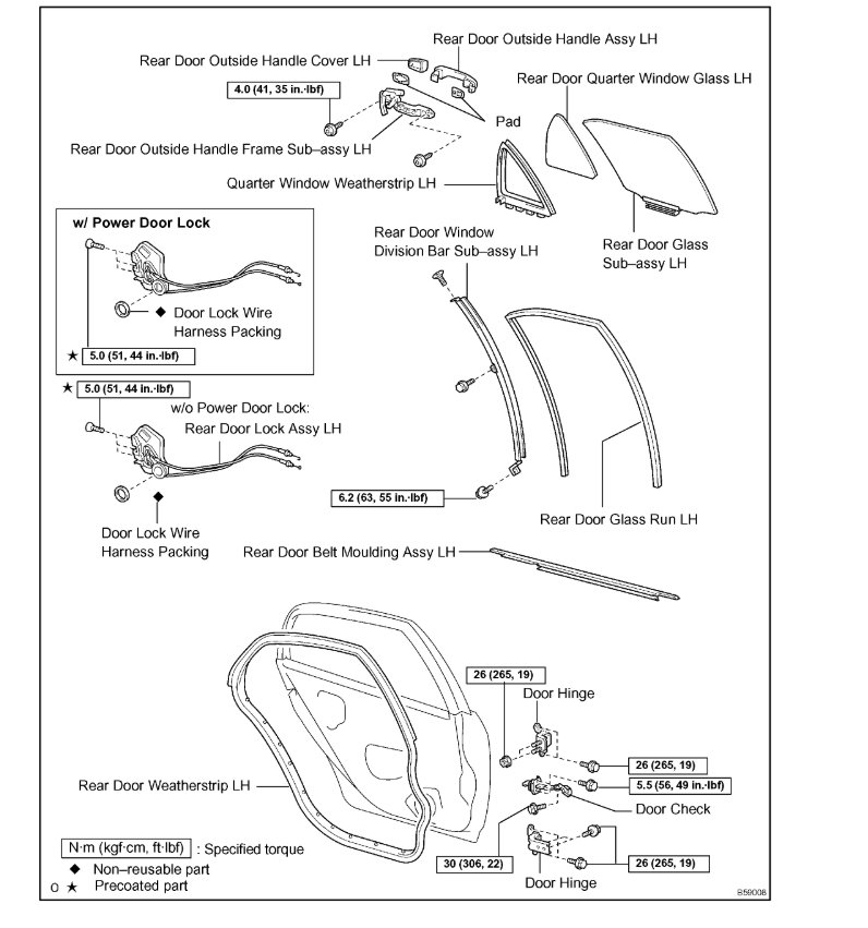

Hi! I recently shattered my drivers side rear window just by touching it. I donnot want to get it repaired professionnally because they are charging me 500$! How do I dismantle my door to instal a used window? I saw your video on changing wiondow motor but is the glass on the same side as the motor? How can I get to the glass? Thx for the help!

Use the car repair link in this thread or get a Haynes manual.
You will have to remove the interior door panel, unbolt the window from the regulator and clean up all the glass fragments.
You can get replacement glass from any auto glass supplier, or Toyota, or from a junkyard.
Also make sure the regulator is not putting the glass in a bind, which could cause it to shatter.
