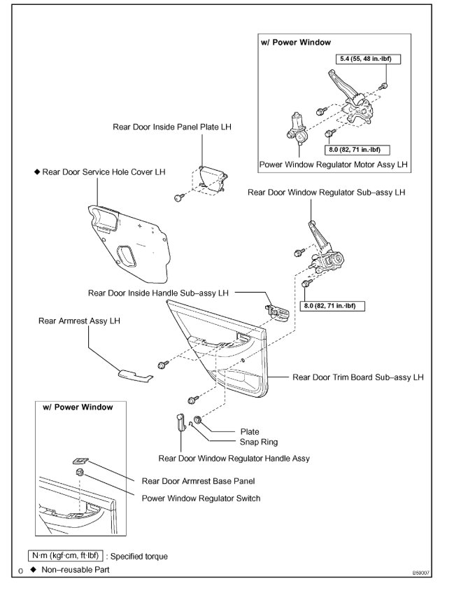

I am unable to activate the rear window from the driver's control or the rear door window control. I have unlocked the window lock, and when I press the window control button, I can hear it click and see the lights slightly dim at night. If I am to replace the motor, is it something that I can do? Also, how should I remove the side door panel to check the motor? Thanks for your help in advance.

Probably a bad motor or limit switch. Generally the armrests are bolted in as well as the opening lever, the panel itself is held in place by plastic retainers, and pulls out and up.
This video show the job being done on a similar car with instruction in the diagrams below for you car.

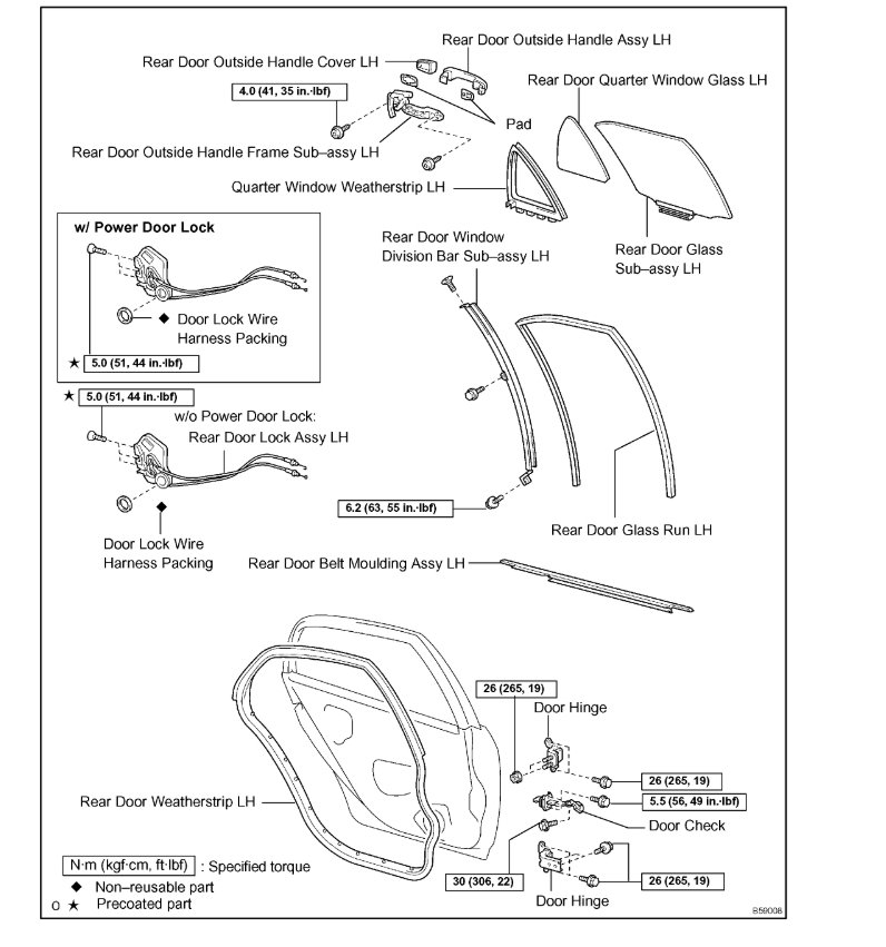

Hi! I recently shattered my drivers side rear window just by touching it. I donnot want to get it repaired professionnally because they are charging me 500$! How do I dismantle my door to instal a used window? I saw your video on changing wiondow motor but is the glass on the same side as the motor? How can I get to the glass? Thx for the help!

Use the car repair link in this thread or get a Haynes manual.
You will have to remove the interior door panel, unbolt the window from the regulator and clean up all the glass fragments.
You can get replacement glass from any auto glass supplier, or Toyota, or from a junkyard.
Also make sure the regulator is not putting the glass in a bind, which could cause it to shatter.
