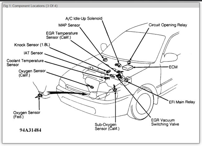

When engine stalled, are you able to restart? This sounds like a fuel pump or the crankshaft angle sensor has gone out. When you turn the key to the on position without cranking the engine over can you hear the fuel pump run in the tank for 5 seconds? These guides will help fix it
https://www.2carpros.com/articles/engine-stalls
