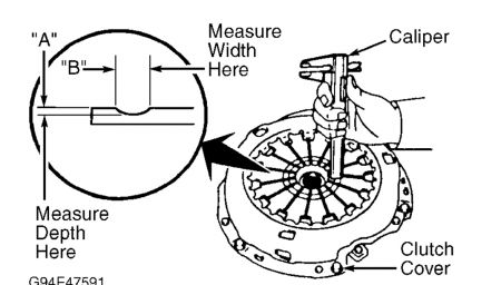

transmission is not meeting up with the engine properly and having trouble removing & installing passenger side axle shaft into transmission. Clutch fork has too much freeplay after installing transmission. Replaced clutch disc, pressure plate, release bearing, resurfaced flywheel.

Inspection (Camry & Camry Solara) 1. Check wear on facings of clutch disc by measuring depth of each rivet head. Minimum depth at any rivet is .012" (.30 mm). Using a dial indicator, measure clutch disc runout. Replace clutch disc if runout is greater than .031" (.79 mm). 2. Using a dial indicator, check flywheel runout. Replace flywheel if runout is greater than .004" (.10 mm). 3. Measure depth and wear on diaphragm spring on clutch cover. See Fig. 9 . Maximum depth is .024" (.61 mm) and maximum width is .197" (5.00 mm). Replace clutch cover if necessary. 4. Ensure clutch release bearing rotates smoothly while applying force in axial direction. Replace clutch release bearing if necessary. 5. Using a dial indicator, check diaphragm spring tip runout. If diaphragm spring tip runout is greater than .02" (.5 mm), adjust or replace clutch cover.
