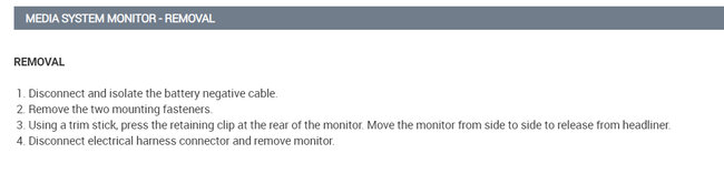

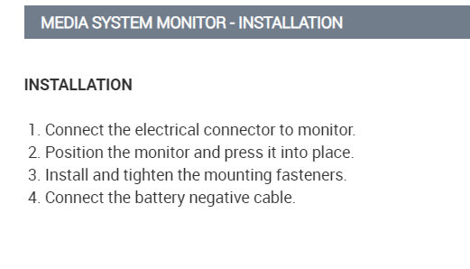

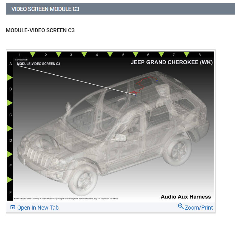

Touch screen freezing and restarting?
2009 JEEP GRAND CHEROKEE
130,000 MILES • 3.7L • V6 • 2WD • AUTOMATIC
SMLEGEND4
The touch screen turns on then restarts about 20 seconds later. The touch screen works for about 2 seconds then freezes. Then it will restart again.

Yep, these touch screen modules go out due to heat etc., but to be sure let's do a CAN scan which is easy to do, you can get a CAN scanner (Controller Area Network) which will work on most cars from Amazon.
https://youtu.be/u-4syLc-ifQ
Here is the location and how to replace the unit in the images below. Check out the images (below). Please let us know what happens.
