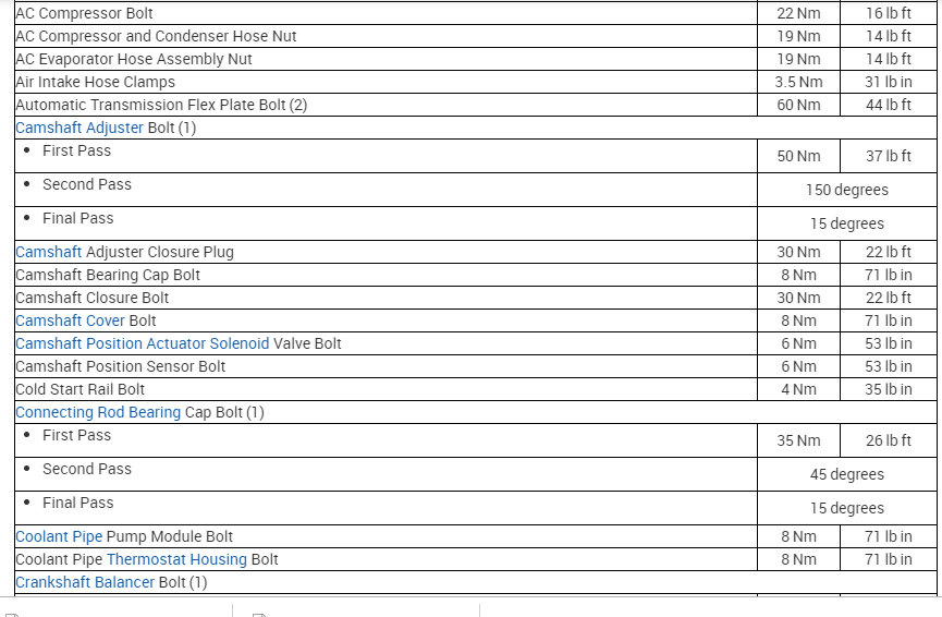

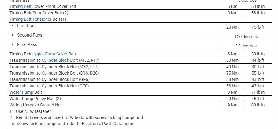

I am having a difficult time finding the torque spec charts for my car. I ruined a crankshaft dampener and crankshaft timing gear because. Do you have any available spec charts?
Nov 27, 2019 at 7:17 AM
  • CAR REPAIR CONTRIBUTOR
Good afternoon,
I attached the engine torque specs for you.
Let me know if you need anything else.
Nov 27, 2019 at 12:25 PM

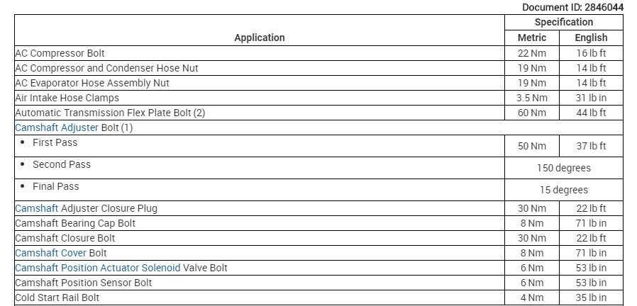

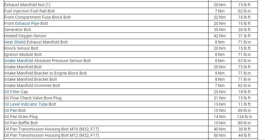

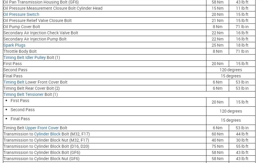

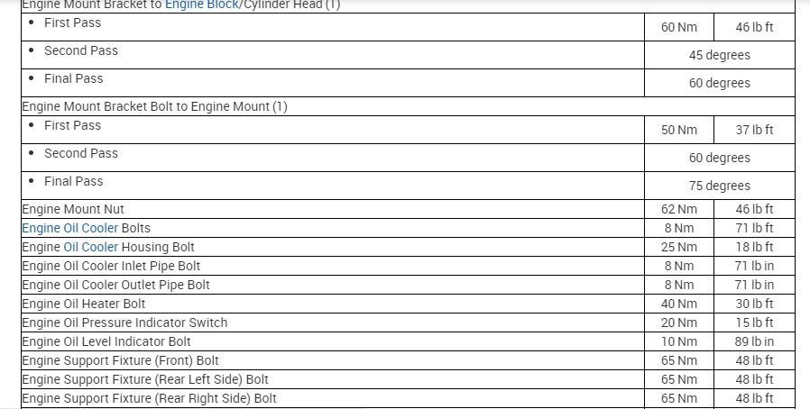

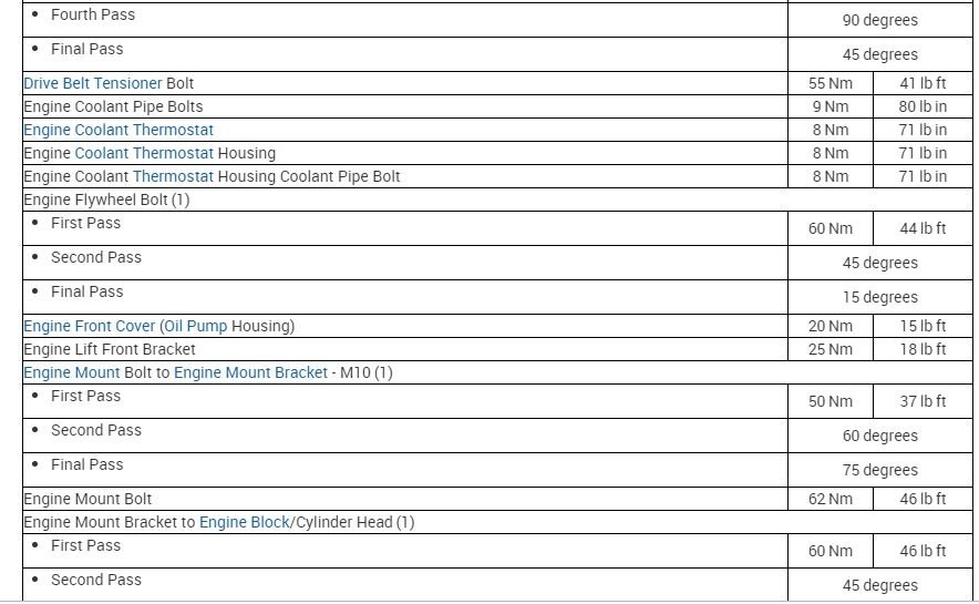

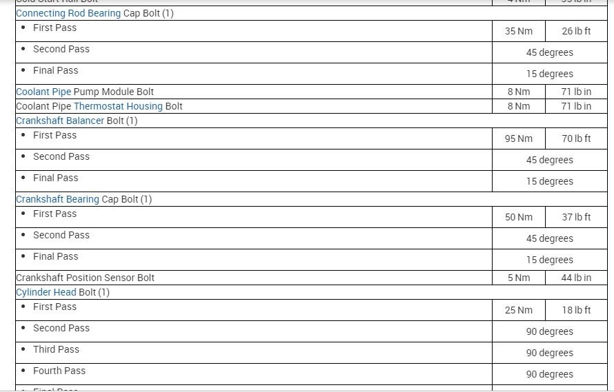

I appreciate your prompt response to my question regarding torque-spec charts for my car. Unfortunately, only part of one chart showed. It stopped before the crankshaft balancer bolt specs. That is actually one of the specs I need, in addition to the timing belt tensioner and idler pulley specs.
If you have the complete charts available, it would be very helpful to me to have them. Thanks, Tim
Dec 1, 2019 at 1:18 PM
All attached.
Dec 2, 2019 at 11:45 AM
