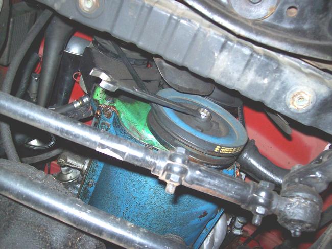

FIRST OFF
LET'S INSURE THE KEYS ARE OUT OF IT, CHOCKED WHEELS, IN NEUTRAL
CAN YOU ROTATE THE ENGINE ONE FULL TURN, OR TWO, WITH A WRENCH. ROTATE IT IN THE NORMAL DIRECTION IT TURNS (WE'RE SEE-UN IF THE ENGINE IS SOME HOW LOCKED UP DUE TO THE SUDDEN STOPPAGE)?
PIC OF DOIN' THIS ON MY '77 JEEP CJ-5 BELOW
MY SCHOOL PAL SNATCHED UP ON THE E-BRAKE IN AN AMC GREMLIN I WAS DRIVING (TO BE FUNNY)(WHEN YOU ARE YOUNG/ STUPID, YOU THINK YOU ARE INVINCIBLE!), NOT A GOOD THING AT SPEED, SCARED THE DOOKEY OUT OF ME!
IF IT WILL TURN OVER-MAYBE IT'S JUST SOMETHING STUPID
