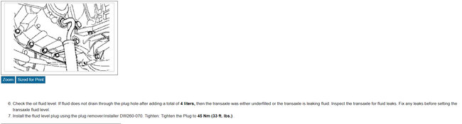

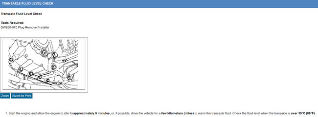

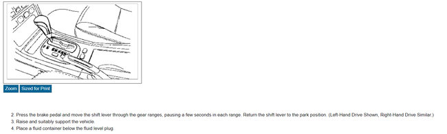

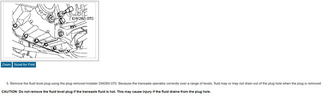

This happens when the transmission fluid is low. Here is a guide to help you check it with diagrams below to help you on your car.
