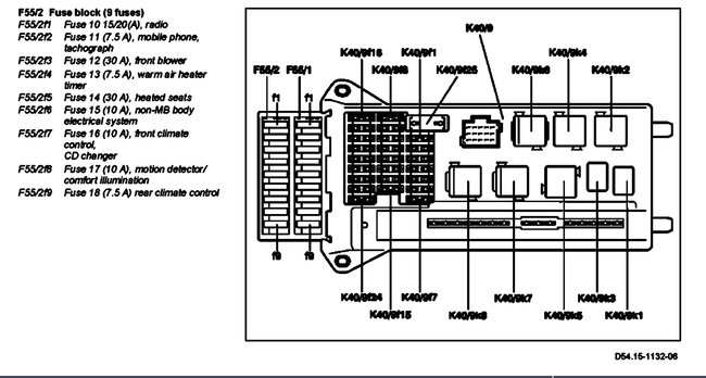

When driving with the van on open road the vehicle sort of switches off with all the dash board lights coming on for plus minus 2 to three seconds. then all is okay again except for the traction control lights which will staying on. This happens every few km while what is diagnose is a code P0685. Can that be the power train relay causing that and if so were can I locate it?

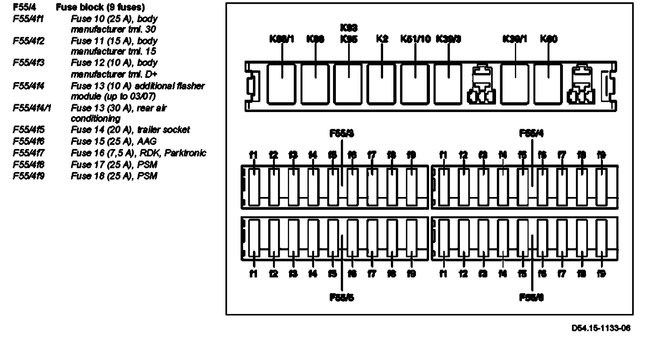

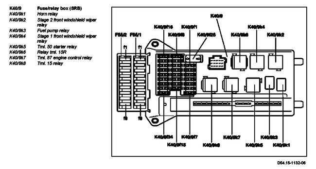

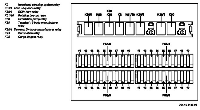

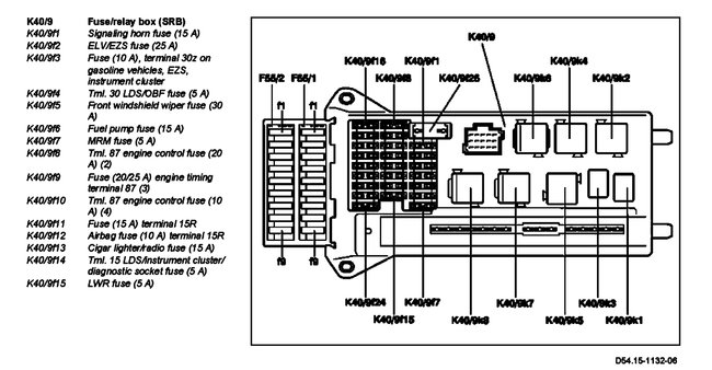

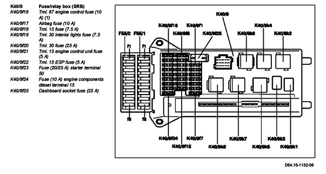

Yep, this will cause the engine to stop running. I would replace the relay. here is the location in the diagrams below with a guide to help test it:
P0685 ECM/PCM Power Relay Control Circuit Open
here are the fuse panel and relay locations .Check out the diagrams (below). Please let us know what happens.

Many thanks for the prompt reply. I did replace relay K40/9k7 but it is still doing it. What I found is that when you drive on a straight road it does not do it but as soon as you go on a slight up hill or down hill and you accelerate that is when it happens.
Can there be any other relays involved?
