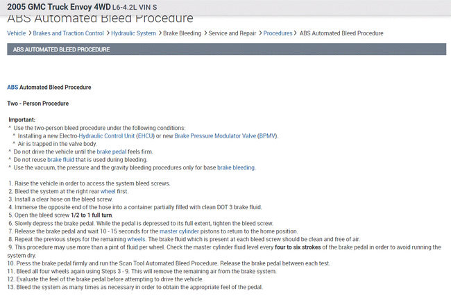

I changed rear brake rotors, pad, and bled brakes farthest to nearest, but still have a spongy brake pedal.
do I need a scan tool to bleed ABS module or does this year not have that? or do any vehicles with ABS have to have a scan tool to bleed the ABS module?

If the brake master cylinder was allowed to empty, you need to perform an automated bleed procedure to get the air from the ABS module.
To answer your question, not all cars with ABS have this procedure, but this specific vehicle does.
If you look at the pics below, I included the directions for the automated bleed. It will require a scan tool that can communicate with the ABS module.
