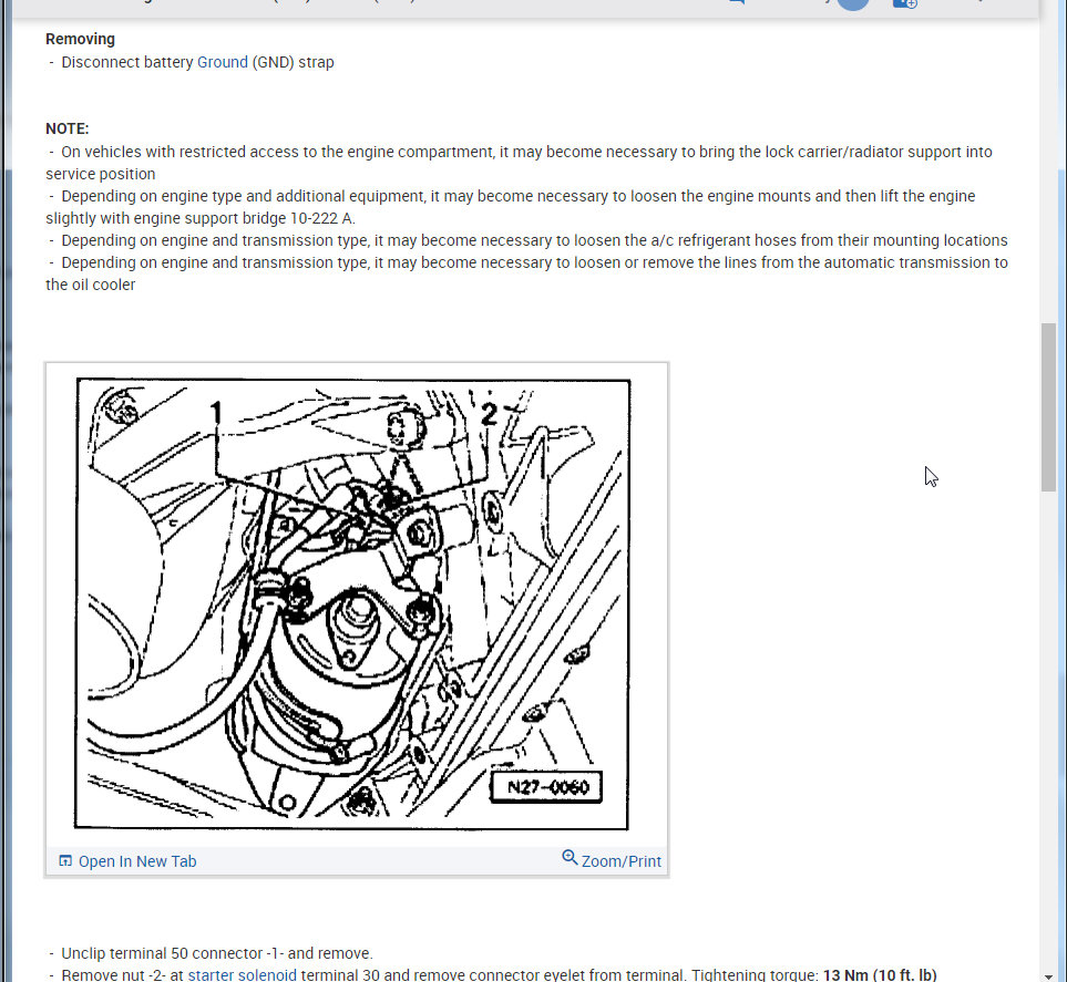

While was stopped it shut off didn't want to start had juice because lights and everything electrical works. got it started by tapping on starter, so I know starter is going out. but what would make it shut off of the blue while it's running.
Jan 13, 2021 at 2:51 PM
  • CAR REPAIR CONTRIBUTOR

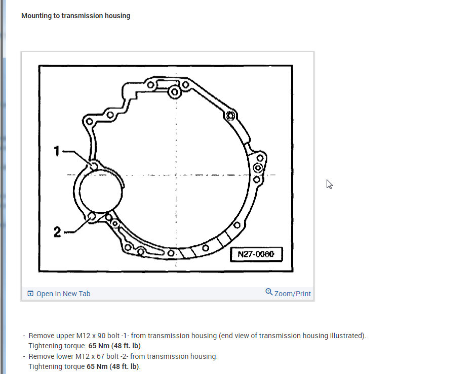

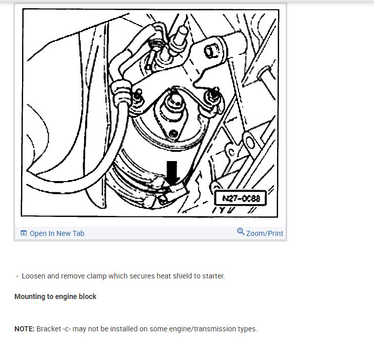

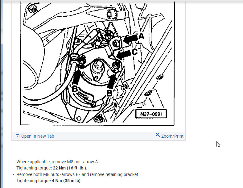

You are correct about the starter and I attached the process on how to replace that below.
As for the shutting off, that could be a number of things that are not related to the starter. Here is a guide that will get us started:
The important thing that we need to know is if this happens again. If it doesn't then I doubt we will be able to figure this out with out more to go on. So let's check for codes and go from there.
Let us know what you find. Thanks
