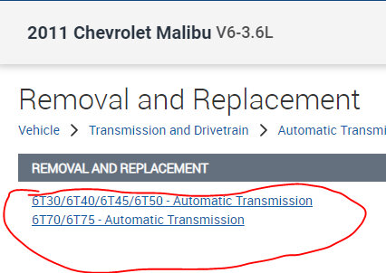

Also, there are a few different transmissions that were used on your vehicle. See pic below. If you know which one it is, let me know. If not, could you provide the VIN number so I can try to determine the one used.
See pic below.
