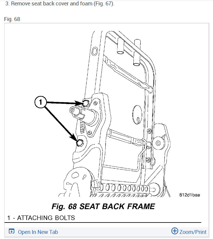

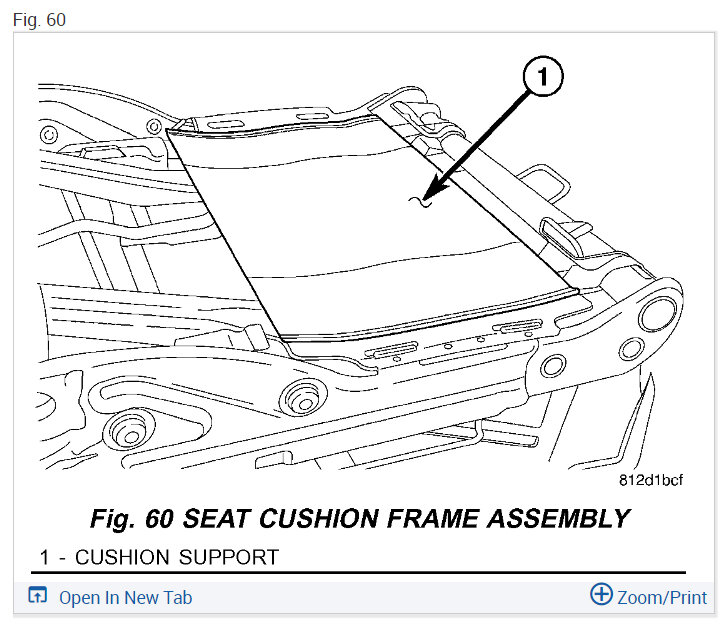

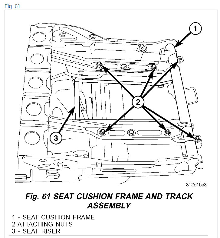

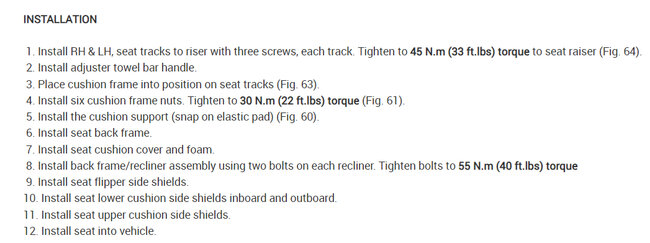

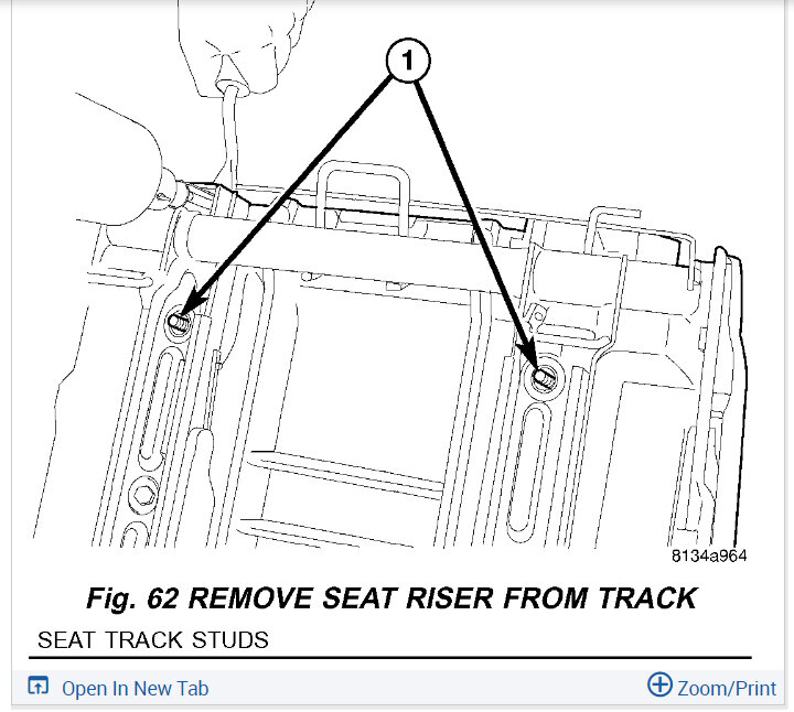

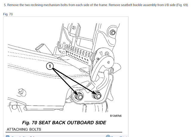

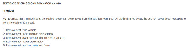

I had to put my seat in the stow n go so I asked my daughter to do it. And now it won't go all the way in but it won't come out either it is completely wedged in there. I can't drive unless it is out my driver seat is all the way to the dash please help.
Mar 2, 2015 at 1:45 PM
  • CAR REPAIR CONTRIBUTOR
  • 110,190 POSTS

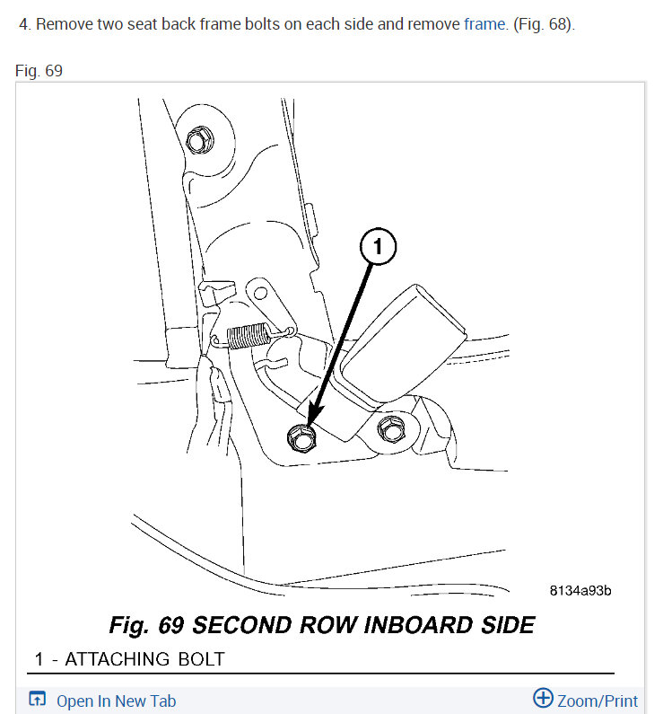

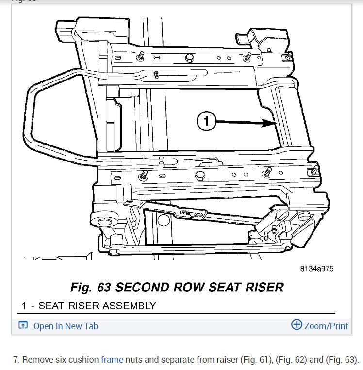

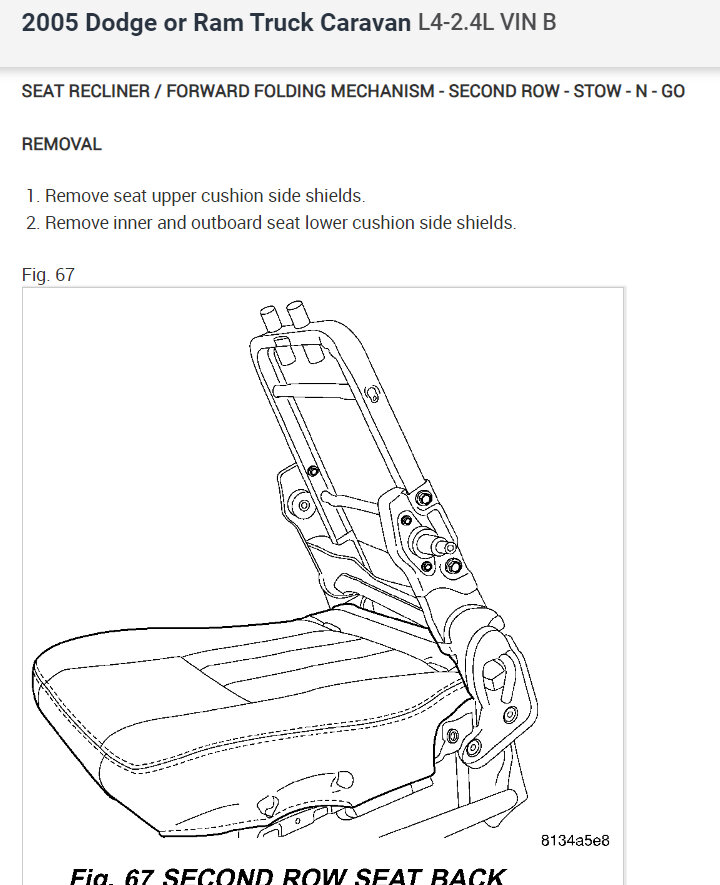

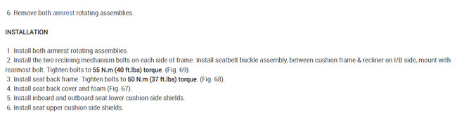

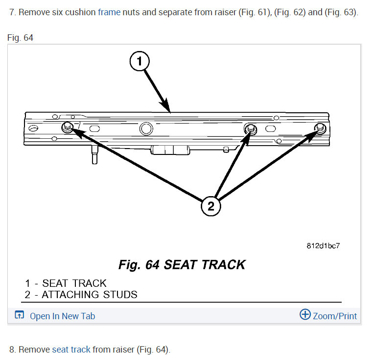

So what happens on these is the mechanism can get a coin or something stuck in the lever assembly or the seat raiser, the seat will need to be removed and diassablembed which I have included in the images below. Check out the images (below). Please let us know what happens.
