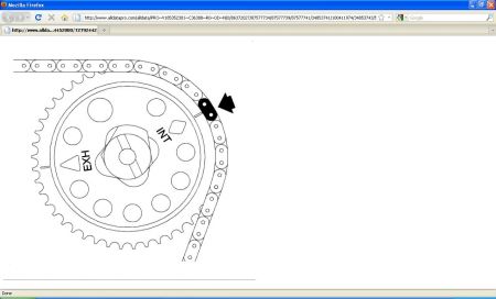

NEED THE TIMING CHAIN DIAGRAM FOR A SATURN L200 2003 4CYL. TO KNOW THE POINT TO PUT THE TIMING CHAIN. THANK YOU.

Installation Procedure
1. Install the timing chain drive sprocket to the crankshaft.
2. Rotate the crank so that the mark on the sprocket is at the 5 o'clock position.
3. Assemble the chain to the intake camshaft sprocket alignment copper link to the INT diamond timing mark on the camshaft sprocket.
Important: When lowering the timing chain rotate the assembly 90 degrees to allow the chain to fall between the cylinder block bosses, then rotate the assembly back so that the camshaft sprocket is facing forward.
4. Lower the assembly through the chain housing opening on top of the cylinder head. Use care to make sure that the chain goes around both sides of the cylinder block bosses.
Important: The crankshaft sprocket timing mark will be at approximately the 5 o'clock position.
5. Route the chain around the crankshaft sprocket and align the silver link to the timing mark.
Important: The camshaft sprocket bolt is not reusable. It is a TTY bolt, and must be discarded to prevent premature failure.
6. Install the intake camshaft sprocket loosely onto the intake camshaft and install the new camshaft sprocket bolt finger tight. It is not necessary to align the sprocket-to-camshaft offset notch at this time.

8. Install the exhaust camshaft sprocket loosely onto the exhaust camshaft with the timing mark on the sprocket aligned with the silver link and install the new camshaft sprocket bolt finger tight. It is not necessary to align the sprocket-to-camshaft offset notch at this time.

10. Ensure the sprocket timing mark is at the 5 o'clock position.

15. Verify that all colored links are aligned with the appropriate marks on the camshaft and crankshaft sprockets. If they are not, repeat steps 8-10. Install the fixed timing chain guide and bolts. Tighten the timing chain guide (fixed) bolts to 10 Nm (89 lb in) .
