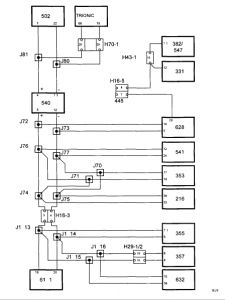

Hello, recently I've encountered multiple heating/ac problems from a used 99 SAAB 9-5 I purchased. I have replaced my blower motor resistor, my blower motor, I just fixed the dreaded broked blend door on the drivers side and the heater core control valve. All in all, my whole system seems fine now and when I calibrate or run a diagnostic on my ACC system, I get no codes anymore. However, my heating system only seems to respond to a heat call when I set my heat setting to HI. The blend door on the drivers side will remain closed at all other settings, except when HI is selected (as I've used my rubber arms to reach up and hit the temp up to HI will running my A/C, and watching the blend door motor actuate with the components exposed under the dash liner. Any suggestions what may be causing? I am honestly almost at the end of rope with the vehicle, as 1 year with a SAAB has put me back about 5,000 in repair work.
Do you
have the same problem?
Wednesday, October 29th, 2008 AT 8:09 PM
IMPALASS
  • EXPERT

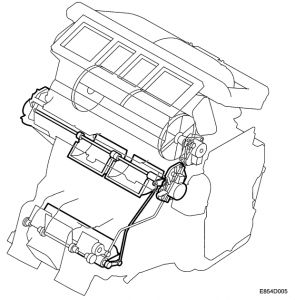

I have attached a pic of all the components and the operation
From some of the information it stated that it senses if someone is in the seat. You sound like you do pretty good with flexibility, however, not sure if you can sit in the seat and do this.
My suggestion is to please review the information. Make sure all codes are clear and drive the car especially at normal operating temperature since you need the heat.
Then recheck for any codes and if it was operating okay.
I hope this helps.

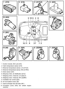

Main Components
http://www.2carpros.com/forum/automotive_pictures/248015_b3_1.jpg

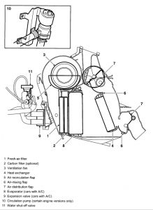

Heating and Ventilation
http://www.2carpros.com/forum/automotive_pictures/248015_b4_1.jpg
The climate system enables the cabin to be divided into two separate climate zones where one temperature can be set for the driver and another set for the passengers. This is done by means of three air-mixing flaps; one for the front passenger, one for the rear passengers and one for the driver.
http://www.2carpros.com/forum/automotive_pictures/248015_c1_1.jpg
http://www.2carpros.com/forum/automotive_pictures/248015_d1_1.jpg
Air Mixing
The air mix temperature is regulated by means of a stepping motor for each climate zone.
The driver's zone has one air-mixing flap, while the passenger zone has two, one for the front seat passenger and one for the rear seat passengers, which are connected by a link arm.
The air temperature from the heat exchanger is affected by the fan speed and the position of the air-mixing flap. On certain markets, the water passing through the heat exchanger can be turned off completely with a vacuum operated shut-off valve to obtain maximum cooling efficiency (cars with A/C).
Depending on the desired heating position/temperature, the air-mixing flap directs a certain amount of the incoming air through the heat exchanger.
If cold air has been selected, the air-mixing flap is closed so that air is prevented from reaching the heat exchanger.
Certain engine versions are equipped with a circulation pump for the heat exchanger. By increasing the flow of coolant through the heat exchanger when necessary, maximum heating efficiency can be obtained.

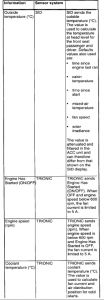

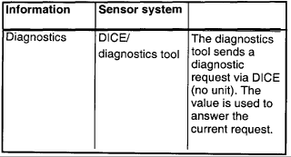

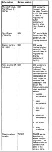

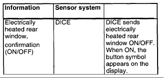

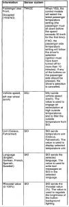

ACC uses the following information:
http://www.2carpros.com/forum/automotive_pictures/248015_e3_1.gif
http://www.2carpros.com/forum/automotive_pictures/248015_e4_1.jpg
http://www.2carpros.com/forum/automotive_pictures/248015_e5_1.jpg
http://www.2carpros.com/forum/automotive_pictures/248015_e6_1.jpg
http://www.2carpros.com/forum/automotive_pictures/248015_e7_1.gif

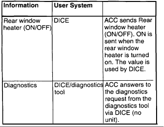

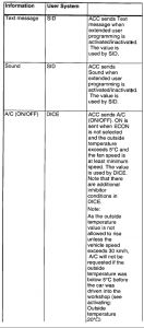

ACC sends the following information:
http://www.2carpros.com/forum/automotive_pictures/248015_e8_1.jpg
http://www.2carpros.com/forum/automotive_pictures/248015_e9_1.gif
