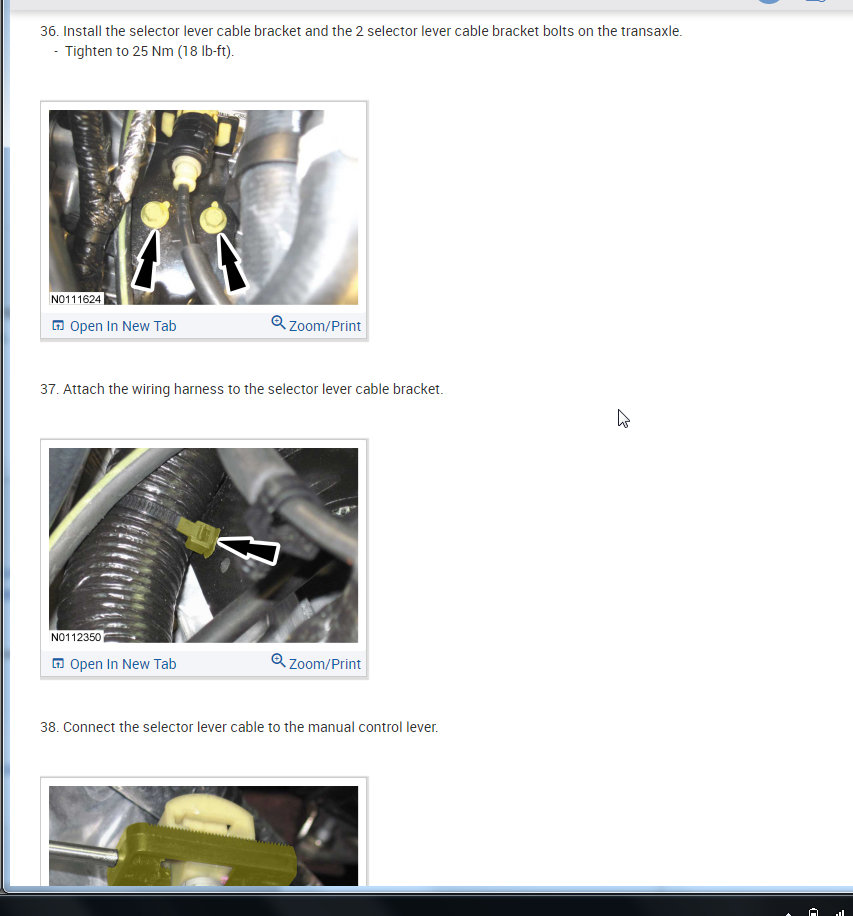

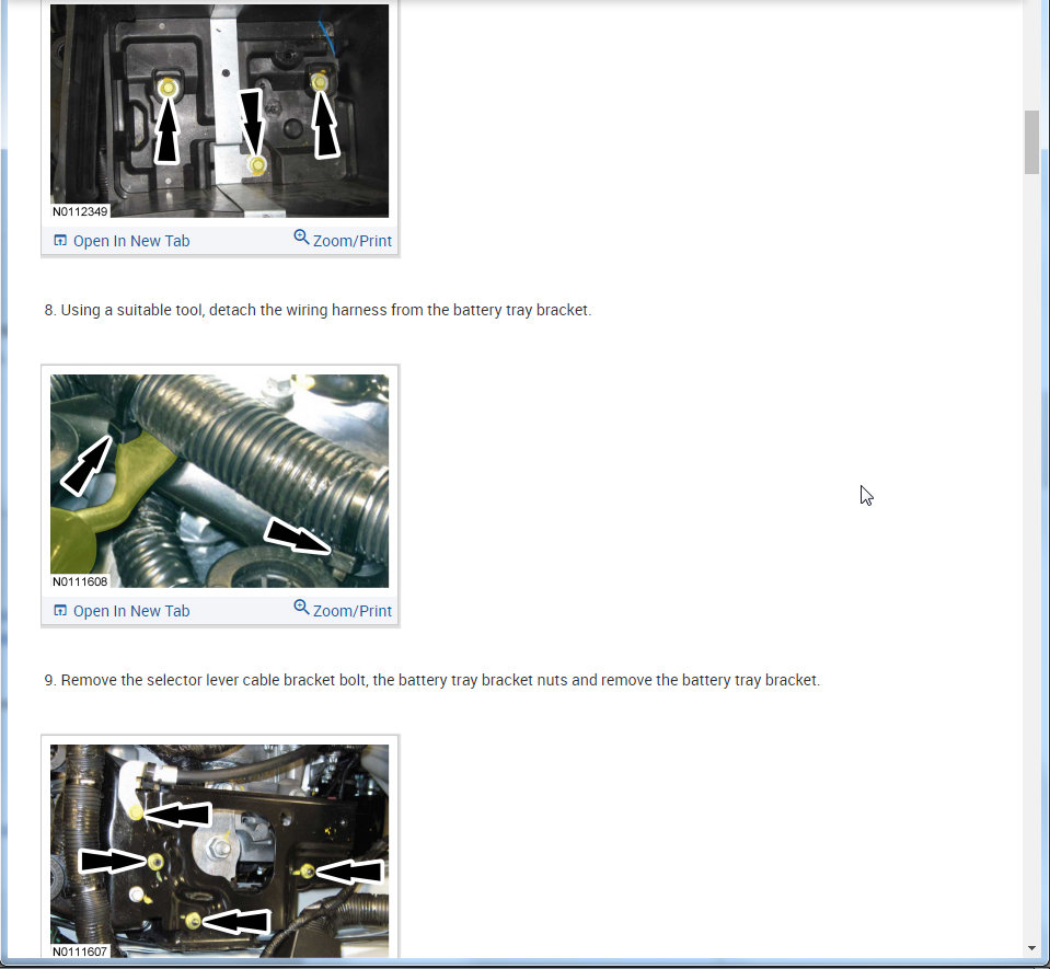

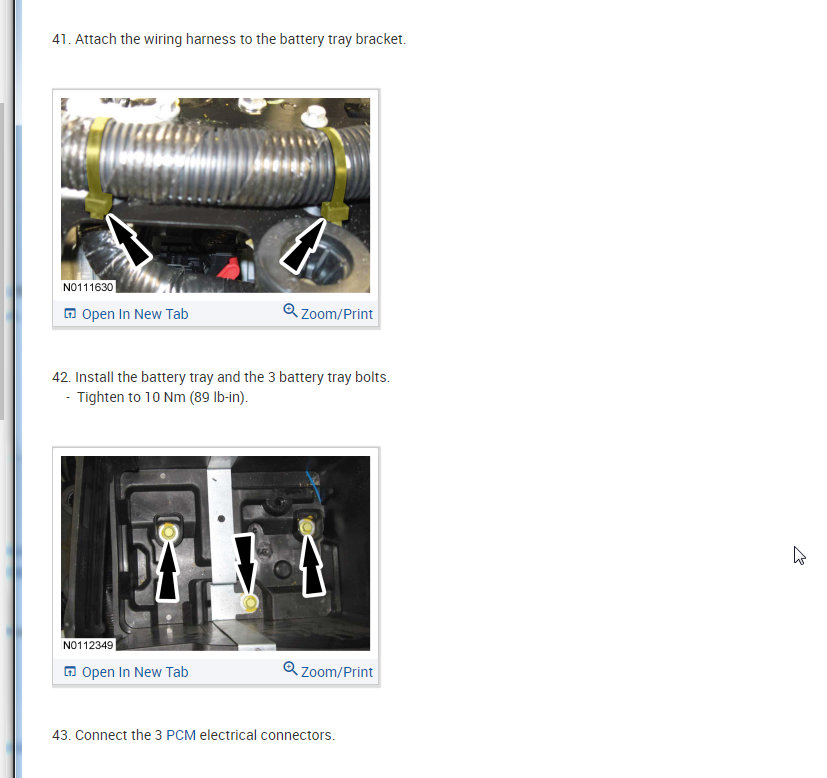

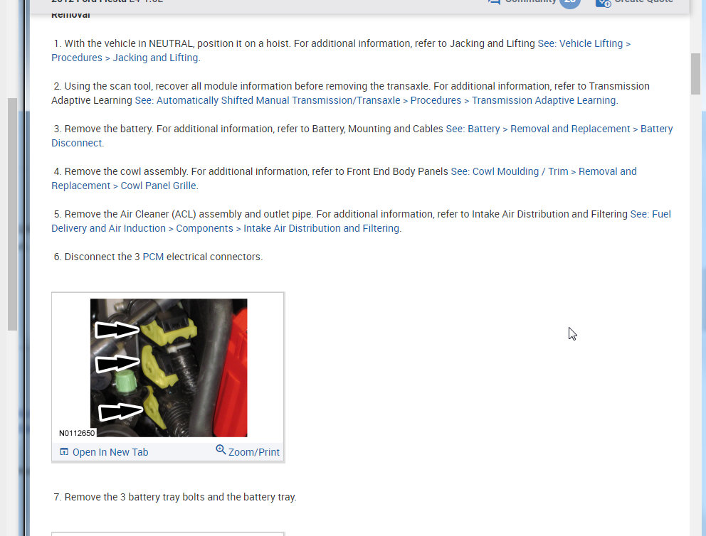

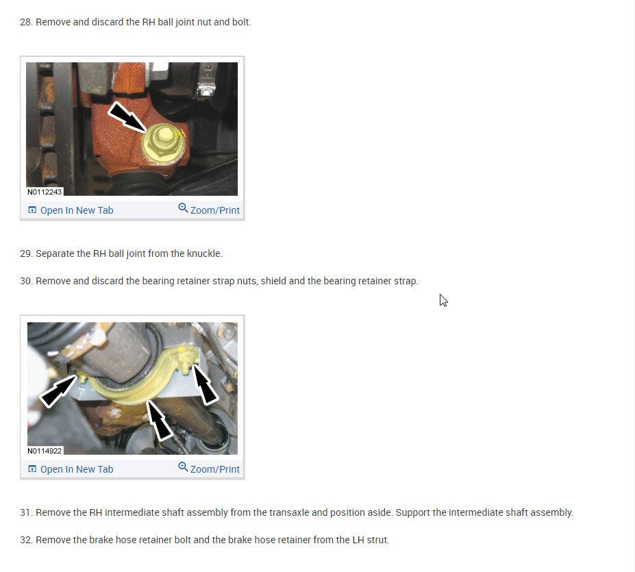

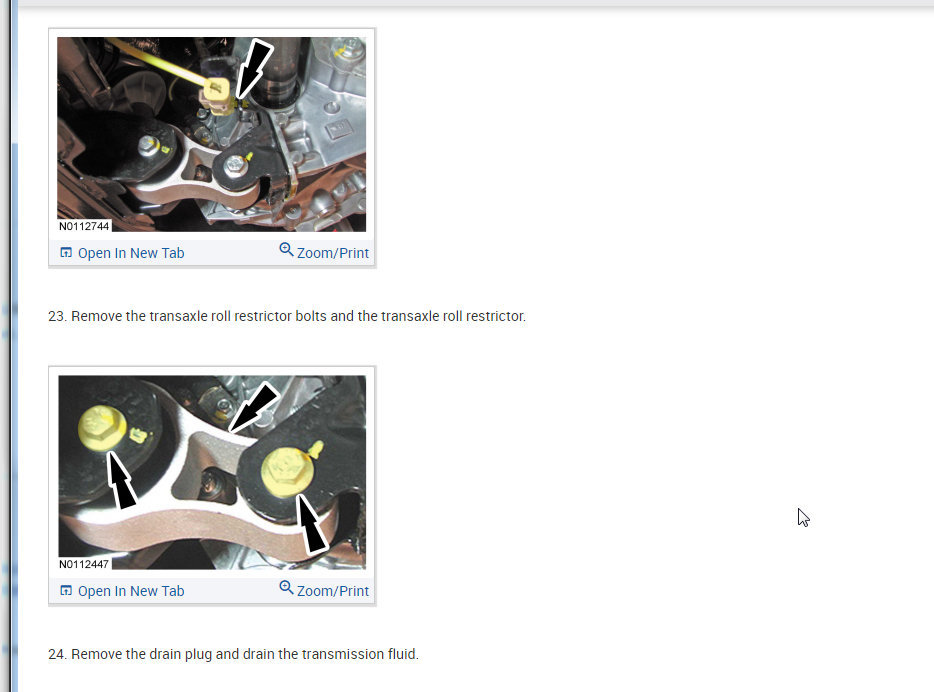

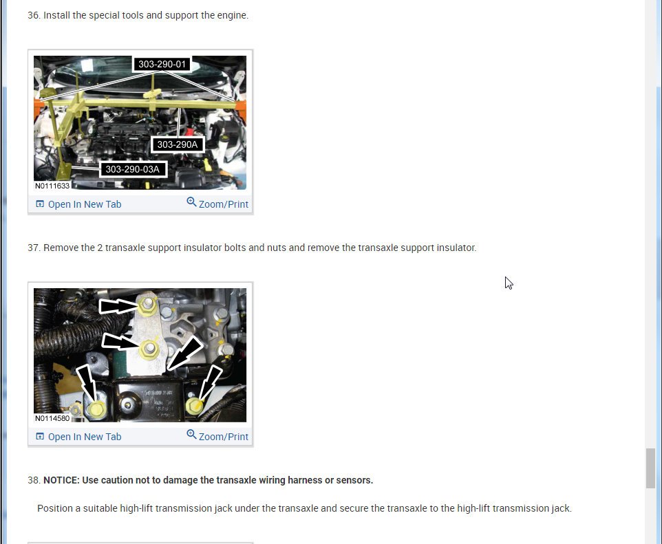

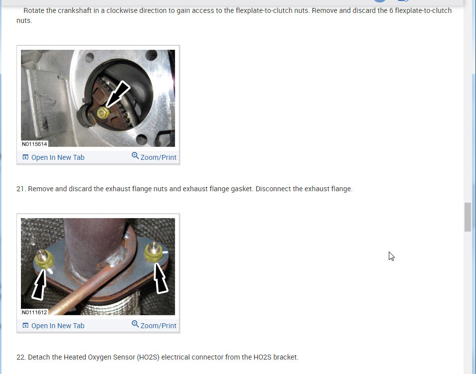

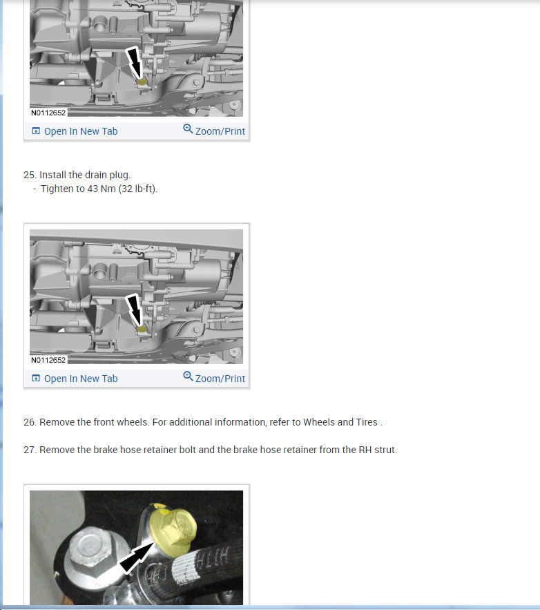

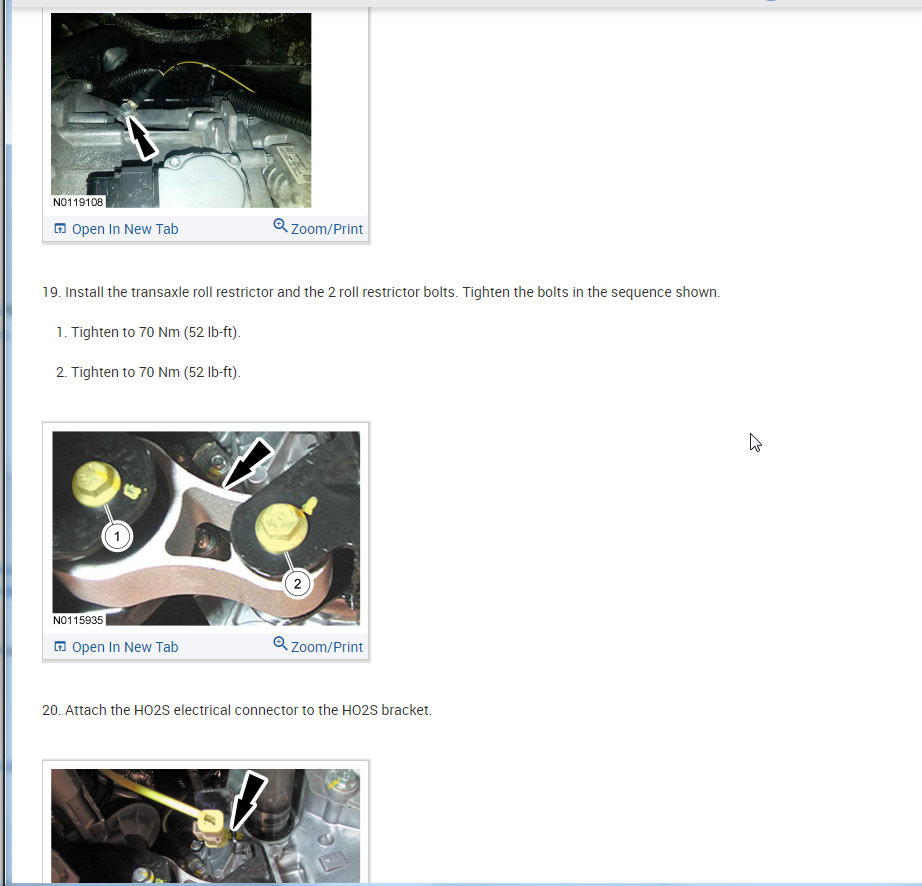

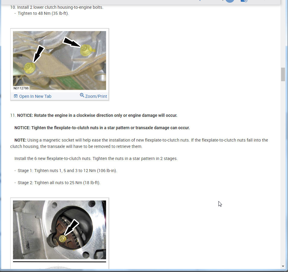

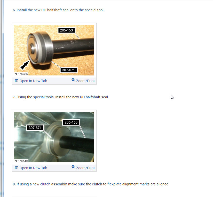

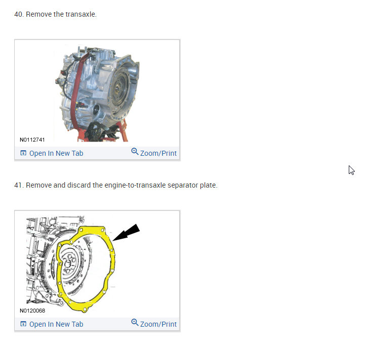

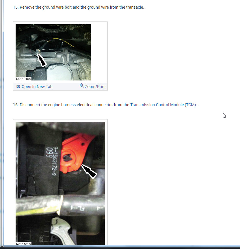

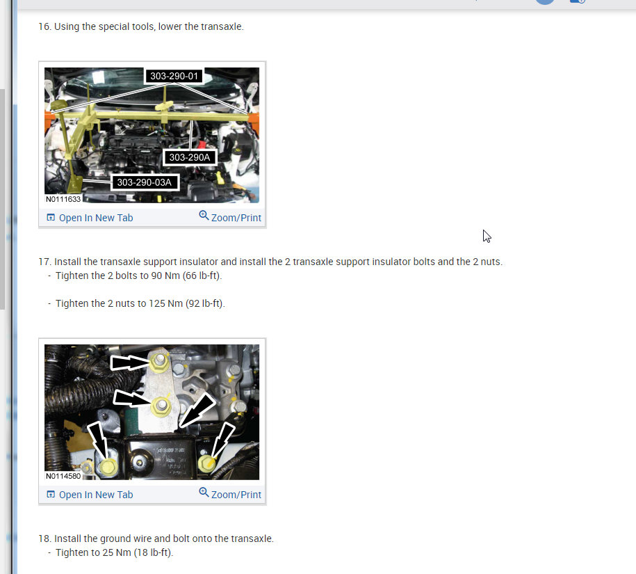

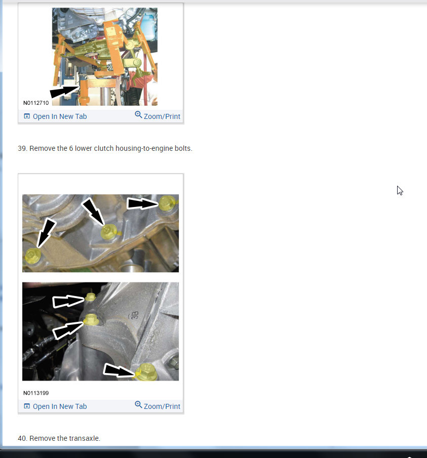

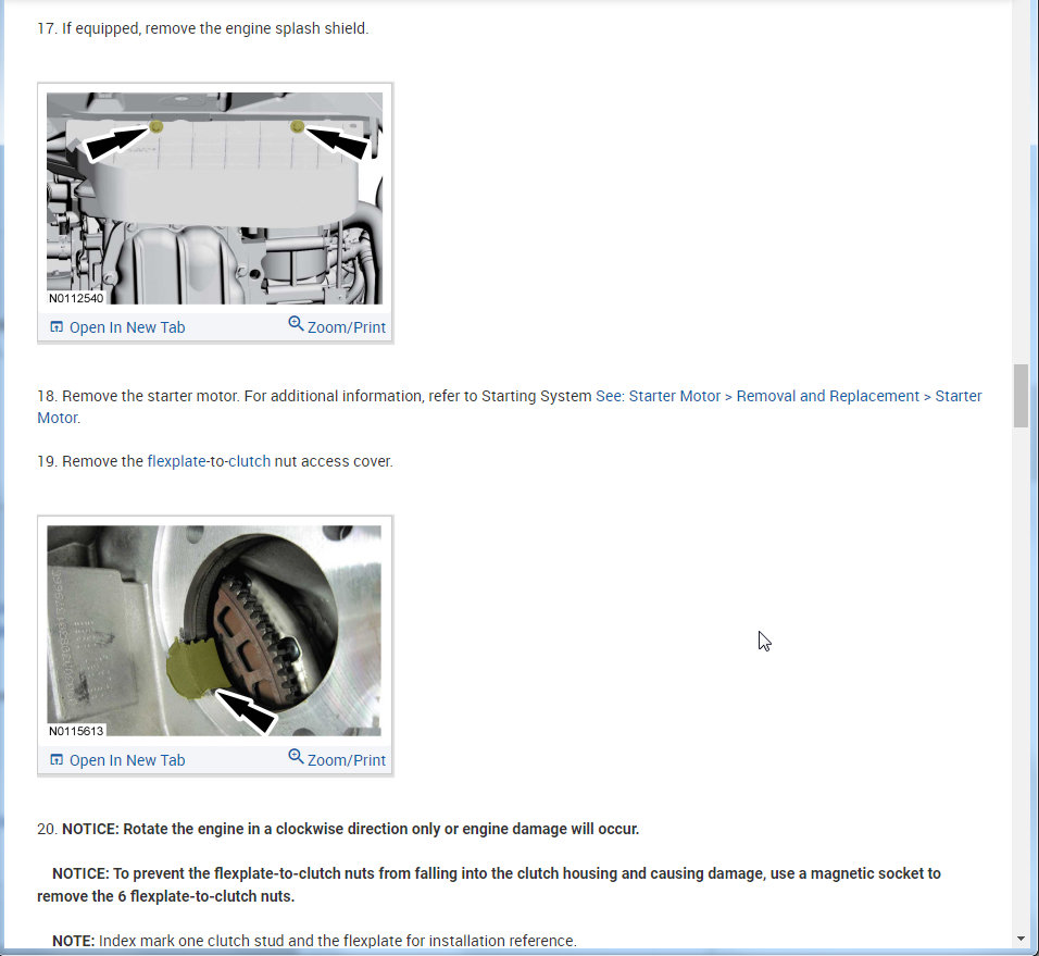

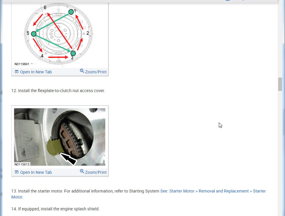

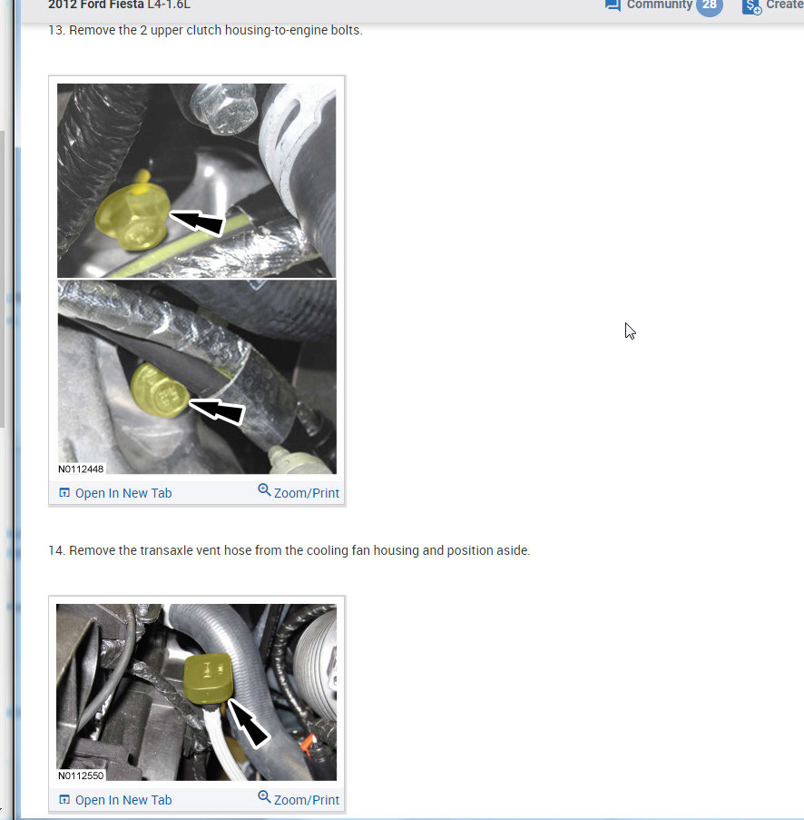

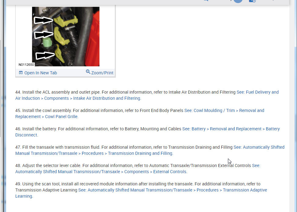

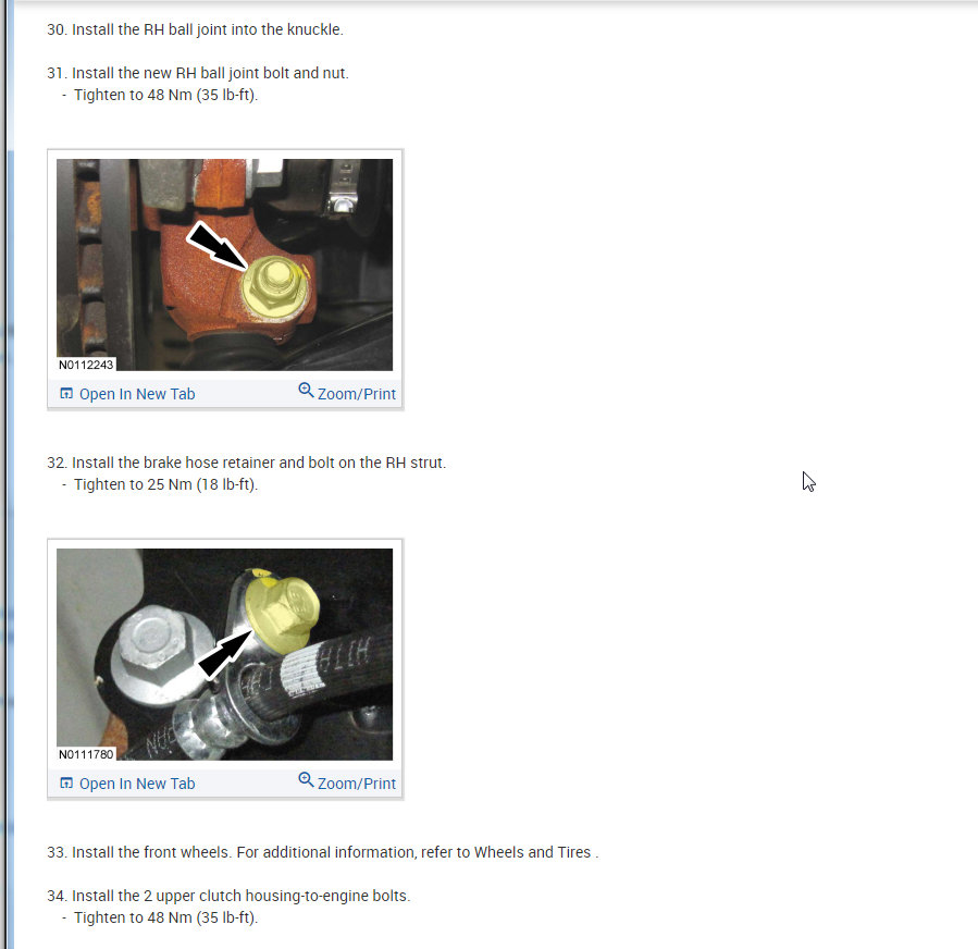

I can't get to the torque converter bolts to remove them to change the transmission, I was told that I had to go through the starter bolt holes but after 16 hours I still can't get to the torque converter bolts, please help
Mar 26, 2016 at 4:38 AM
  • CAR REPAIR CONTRIBUTOR

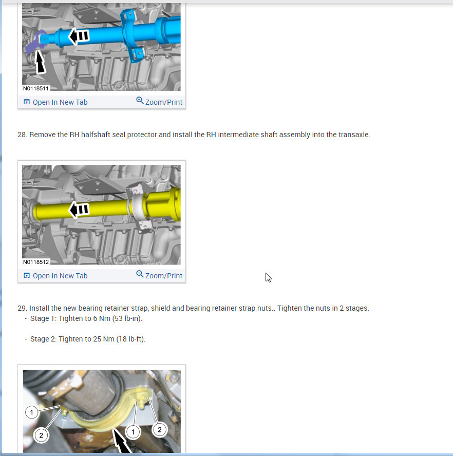

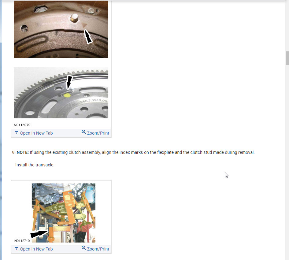

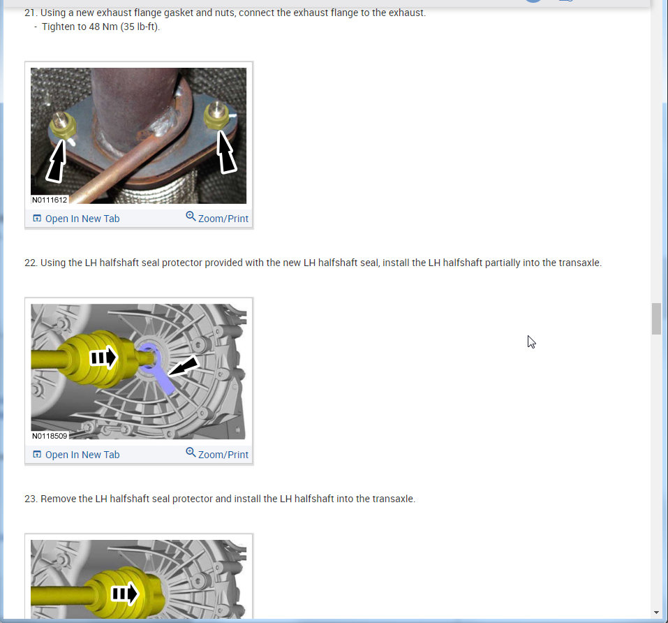

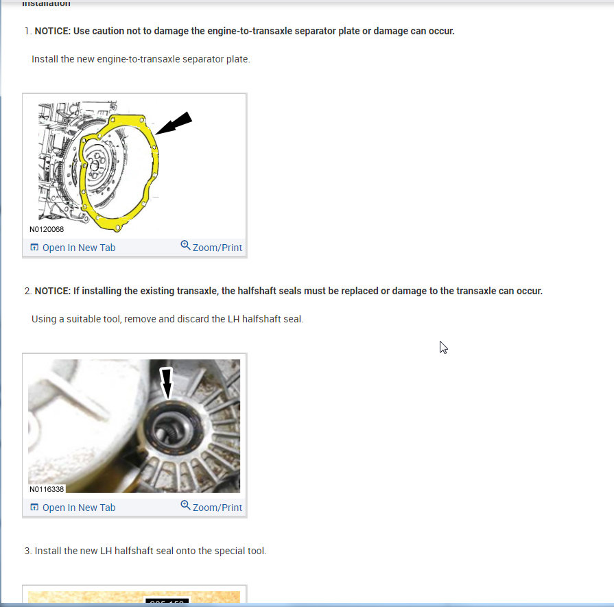

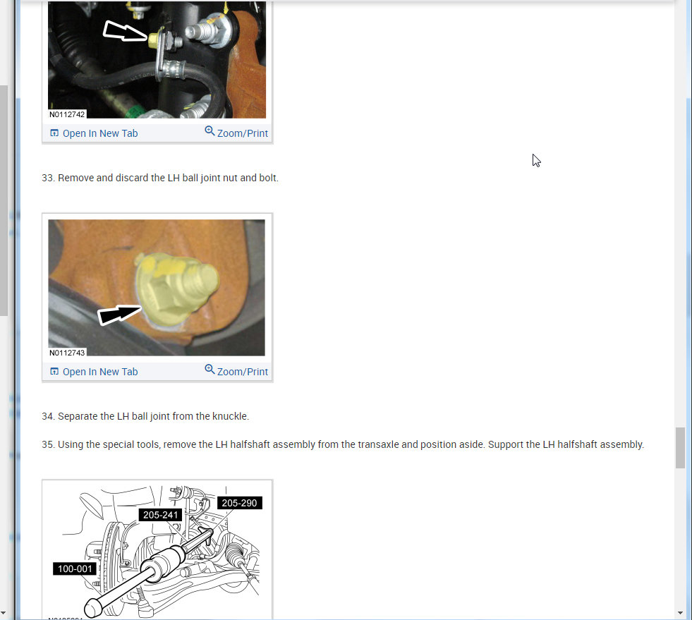

Here is a video that will help with this. It is of a different vehicle but will still give good info.
https://youtu.be/3vJAojsrfuU

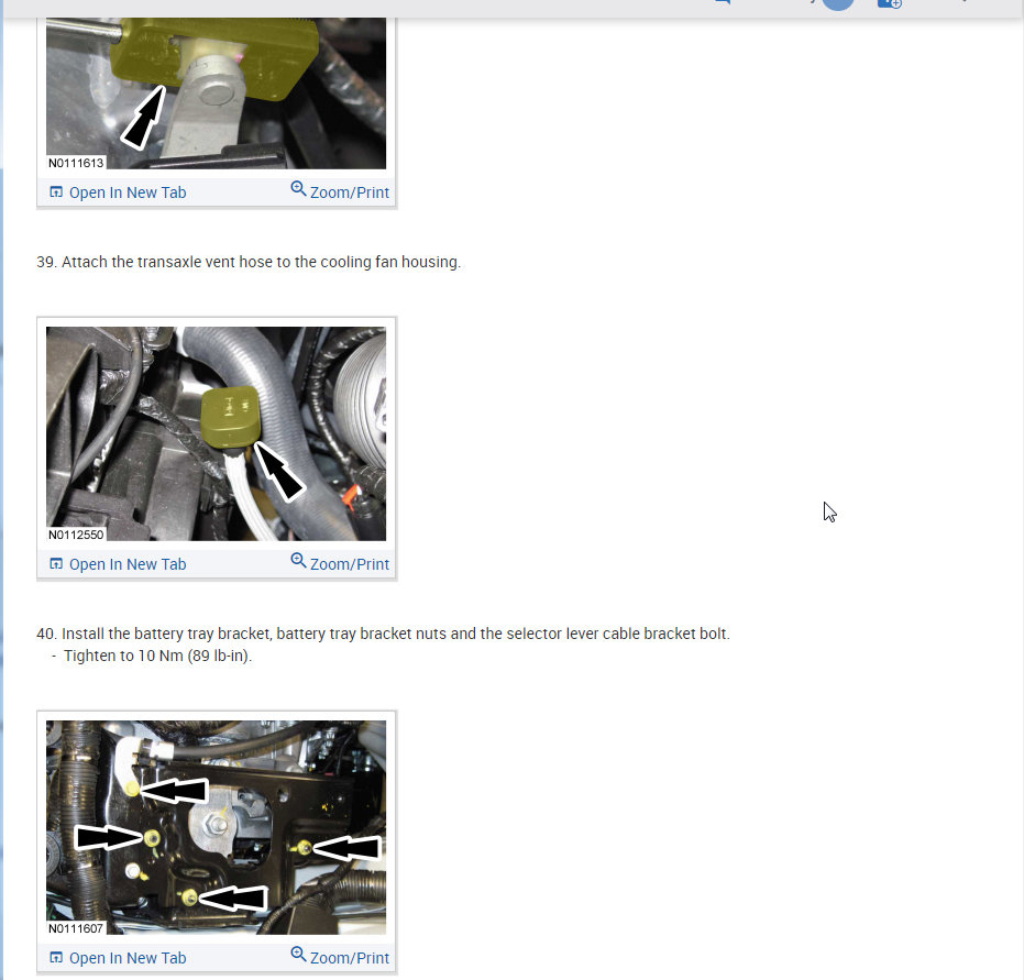

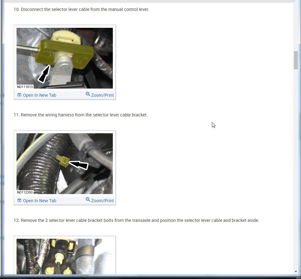

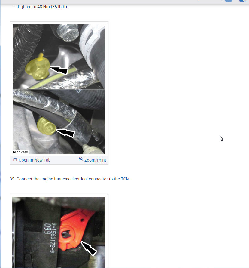

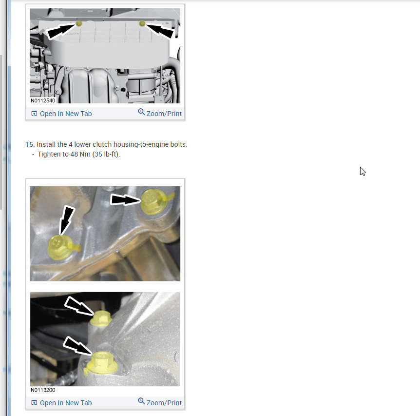

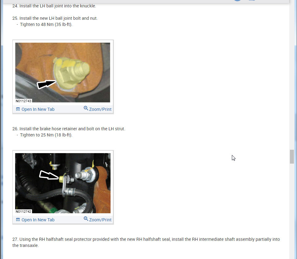

Below you will find the process on how to replace the unit from the manual.
Please let us know if you need more info. Thanks
