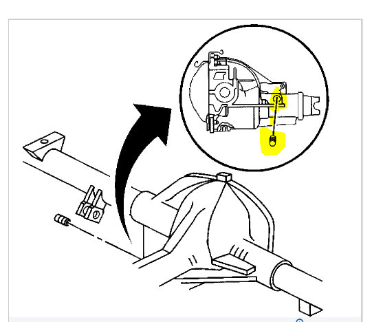

When I drive over certain bumps always while driving slowly, the rear passenger side, at least that is where it sounds like it is coming from, has started making an unbelievable grinding noise for a second or two, I thought the whole rear out had fell out, no one seems to be able to locate the problem.

When driving, do you ever notice the sound (to some degree) when making turns? I ask because it could be an axle bearing going bad. However, they usually will make a howling noise to some degree when turning or driving.
If possible, record the sound and upload it for me to hear. Hopefully, I will be able to identify it.
Also, have you checked to make sure the fluid is full in the differential? There is a fill port on it. It's on the passenger side inner portion of the differential housing. Usually, all you need is a 3.8" ratchet to open it. The gear oil should be to the bottom of the opening when the fill plug is removed. If you haven't, check that. See pic below

Wow! I heard it. It actually caught me off guard. I can't imagine what it sounds like in person.
I listened to the video several times. It almost sounds like a thin piece of metal. Check to see if there is a heat shield or any shield that may be moving and hitting the drive shaft. Also, some of these had a carrier bearing and a two-piece drive shaft. If your vehicle has that, make sure there is no excessive play in it.
If it was in the differential, I would expect a deeper sound. But again, it's like you said. It sounds different in the video.
