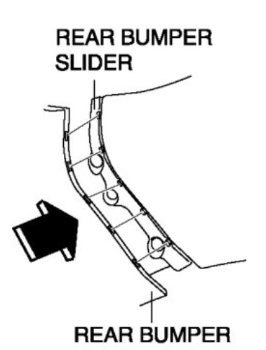

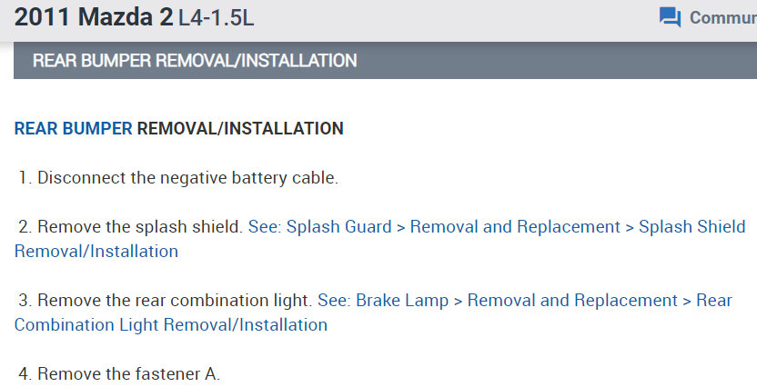

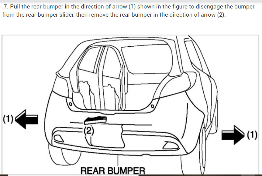

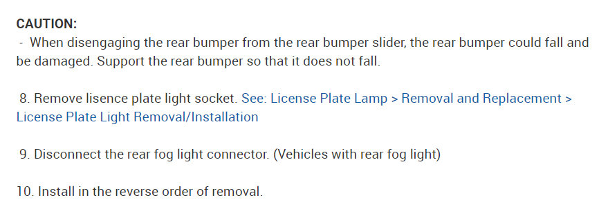

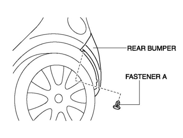

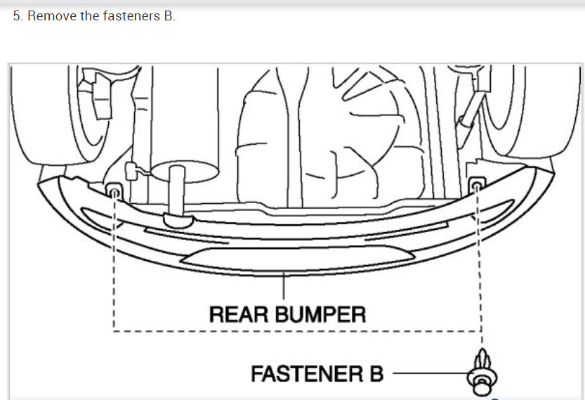

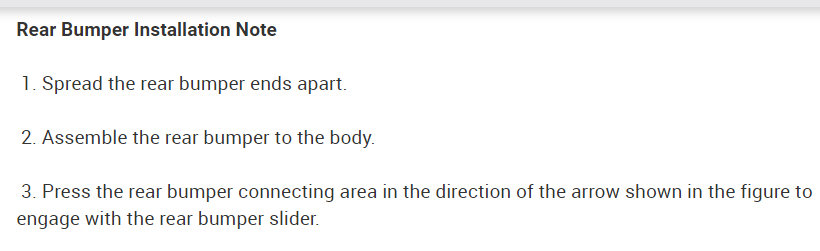

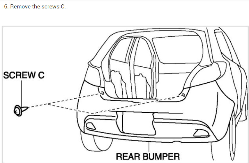

I reversed into a metal fence (laid on the floor), no serious damages done. Some of the paint got scratched off and the white pair from the fence is on it. my car is in true red, so it is very noticeable. I purchased some paint from an online (trusted) store, I wanted to know if that is good? Also the bumper is a bit dislocated I am trying to minimize the cost, as I am a student. Any advice would be appreciated. :)
Aug 11, 2016 at 3:27 PM
DANNY L
  • CAR REPAIR CONTRIBUTOR
  • 5,648 POSTS
Hello, I'm Danny.
I've attached picture steps below on how to remove and re-install your rear bumper. This way if you want to try to remove the dents in the urethane or reposition you will have the instructions. If you go to auto parts stores like Pep Boys they sell a brand of touch up paint called Dupli-Color. It is always a spot on match and I've attached a picture of what it looks like as well. Hope this helps and thanks for using 2CarPros.
