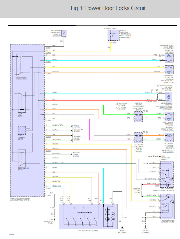

Friend of mine had a guy look at the van and he monkeyed around with the electrical and now the rear sliding doors will not open when buttons are pressed. When you press the overhead door buttons you hear a click but that is it. I have taken the fuses out to reset the system but no change. Can you help?
Mar 19, 2018 at 5:57 PM
  • CAR REPAIR CONTRIBUTOR
  • 54,334 POSTS
It sounds like you have a door motor that is out but to be sure test for power at the motor. Here is a guide and the wiring diagrams for the system so you can see how it works and where to test for power:
