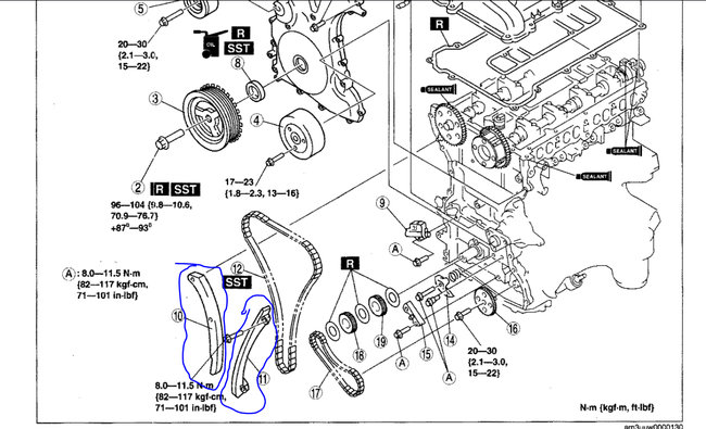

Here is a better video:
Jul 9, 2021 at 1:28 PM
  • CAR REPAIR CONTRIBUTOR
Okay, thank you. The second video was much better.
This sounds like something inside the motor. It could be the guides I circled in the video. It does not sound like anything external at all.
You need someone to listen to this noise and track it down for you. It is not an easy fix whatever it is. Sorry for the bad news but I would have it addressed ASAP to prevent a total failure.

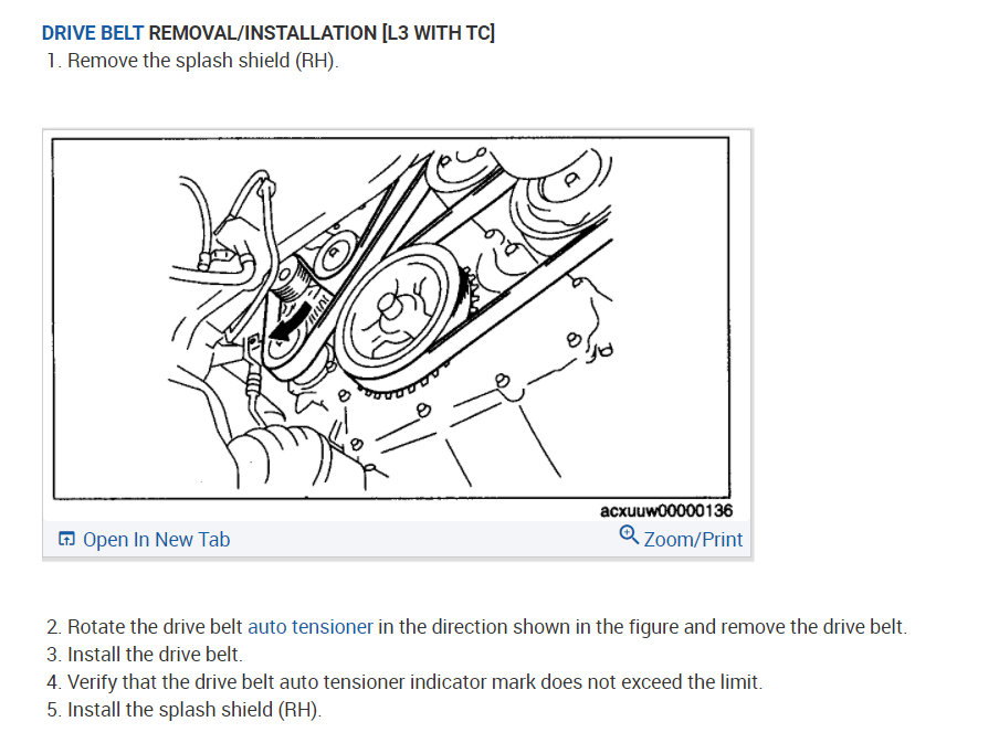

Try removing the drive belt and see if the noise is still there. That will confirm an internal or external noise.
I attached a picture of the location of the tensioner for you.
Jul 9, 2021 at 2:05 PM
