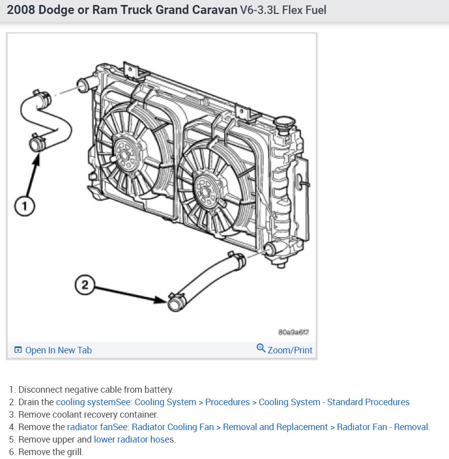

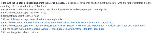

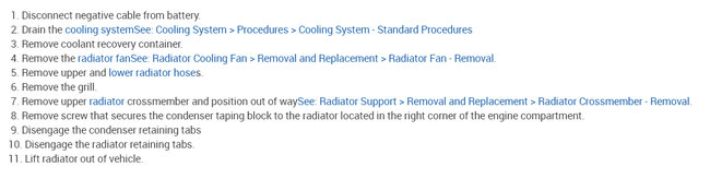

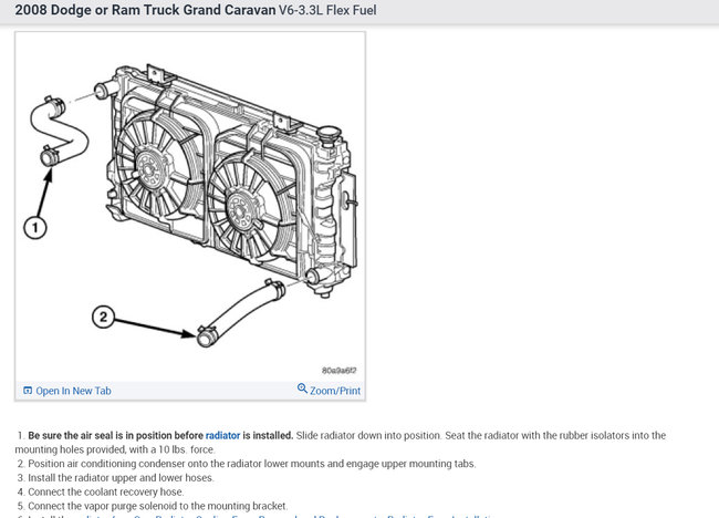

Here is the correct way to install a new radiator in the guide and diagrams below:
https://www.2carpros.com/articles/how-to-replace-a-car-radiator
