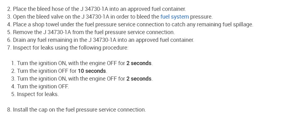

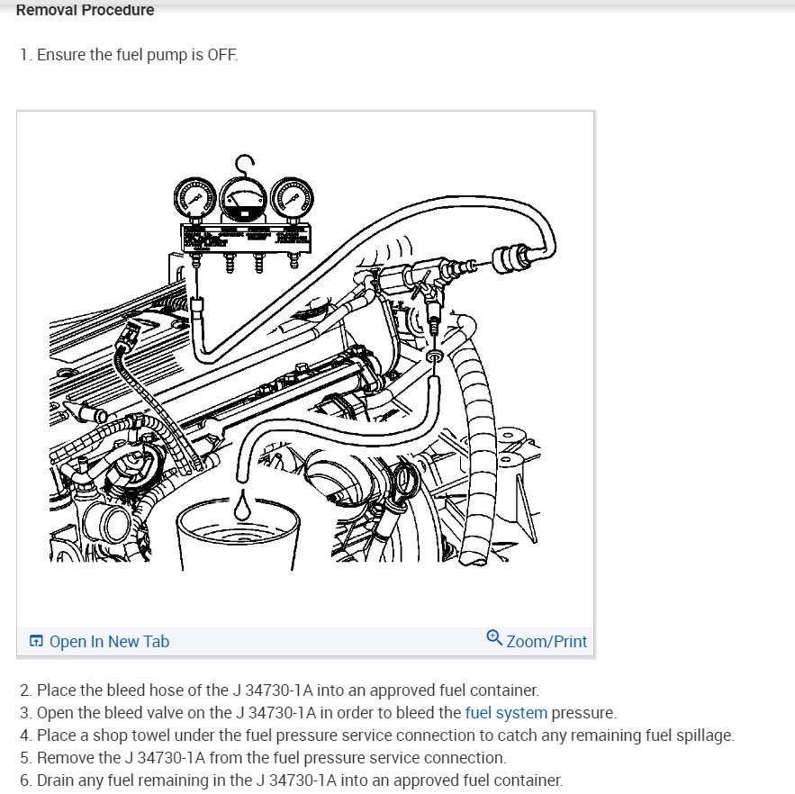

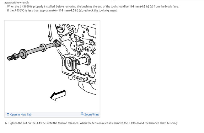

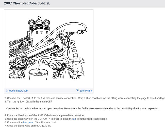

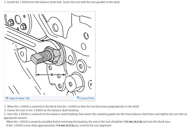

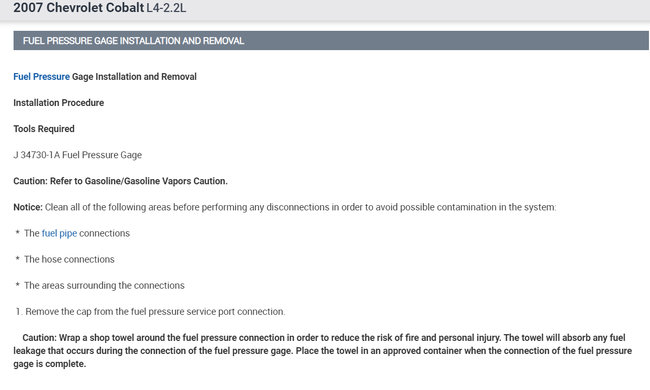

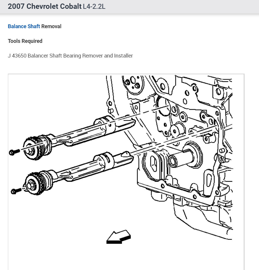

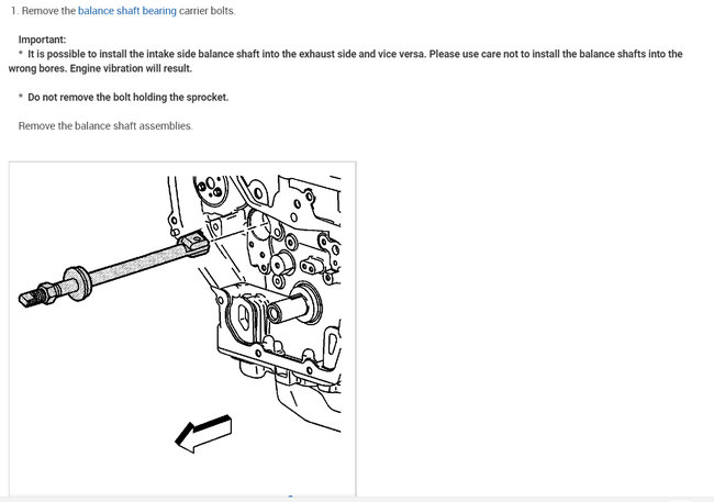

It sounds like the fuel pump is going out or the catalytic converter is starting to clog up. These two guides can help you check it. here are the fuel pressure specs and you can rent a gauge at the Auto parts store. The only thing that concerns me is the growling vibration because this engine has a balance shaft and when they go out this problem happens. Here are the locations of the shaft and how they are located inside the engine in the images below:
and
Fuel Pressure (Key "on", Engine "off") .................... 345-414 kPa (50-60 PSI)
Check out the images (below). Let us know what happens and please upload pictures or videos of the problem.
