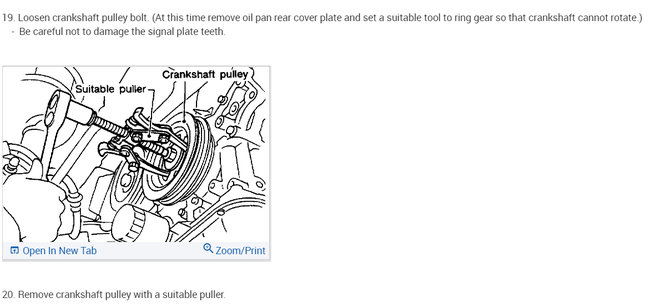

If this looks correct but the belts still don't line up you could have a balancer that is coming apart which will allow the belt grooves to "walk" backwards toward the engine. Try to get a slight down the pullies to the drive pulley to see if this could be a possibility. If so the balancer will need to be replaced. This video will show the job being down on a similar car.
https://youtu.be/NZIMNkLxCMA

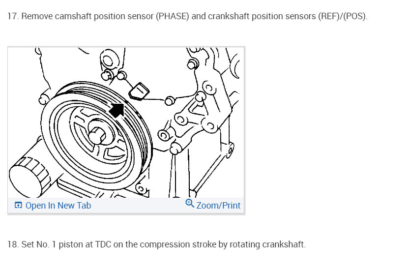

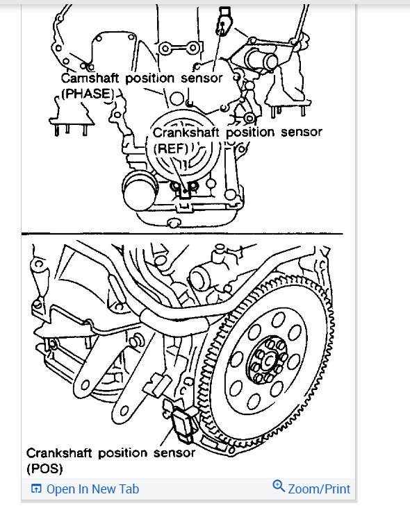

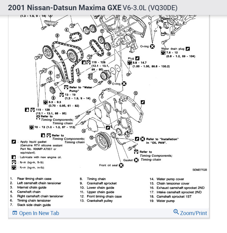

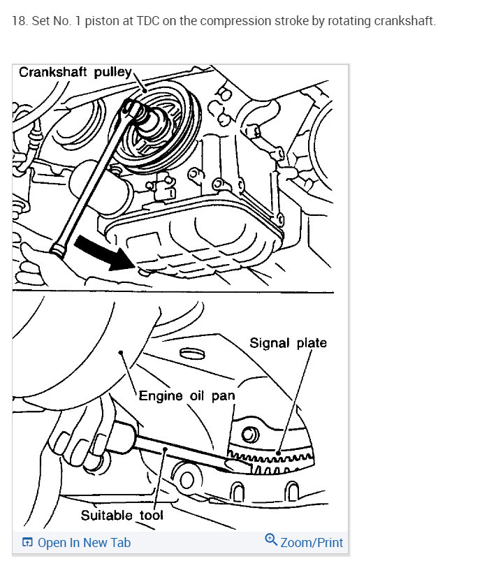

Check out the diagrams (Below). Let us know what happens and please upload pictures or videos of the problem.
