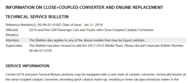

I found this and believe it is the cause but GM says it doesn't exist. Corporate Bulletin
Number 06-06-01-010c, titled close-coupled converter and engine replacement which states the converter material can be sucked into the combustion chamber and lead to engine failure. does anyone know where I can find this? Here is what I found: Information on Close-Coupled Converter and
Engine Replacement
2016 and Prior GM Passenger Cars and Trucks
with Close-Coupled Catalytic Converters
This Bulletin also applies to any of the above models that may be Export vehicles.
This Bulletin has been revised to add the 2015-2016 Model Years. Please discard Corporate Bulletin
Number 06-06-01-010B.

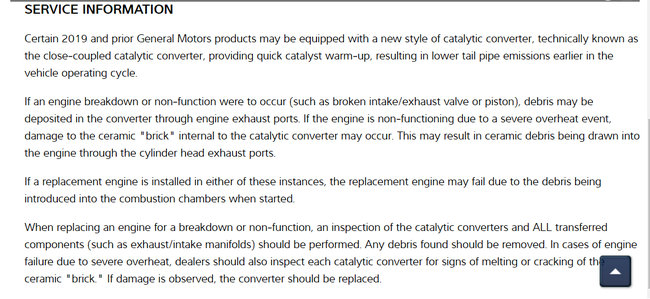

Certain 2016 and prior General Motors products may be equipped with a new style of catalytic
converter, technically known as the close-coupled catalytic converter, providing quick catalyst
warm-up, resulting in lower tail pipe emissions earlier in the vehicle operating cycle.
If an engine breakdown or non-function were to occur (such as broken intake/exhaust valve or
piston), debris may be deposited in the converter through engine exhaust ports. If the engine is nonfunctioning
due to a severe overheat event, damage to the ceramic “brick” internal to the catalytic
converter may occur. This may result in ceramic debris being drawn into the engine through the
cylinder head exhaust ports.
If a replacement engine is installed in either of these instances, the replacement engine may fail due
to the debris being introduced into the combustion chambers when started.
When replacing an engine for a breakdown or non-function, an inspection of the catalytic converters
and ALL transferred components (such as exhaust/intake manifolds) should be performed. Any
debris found should be removed. In cases of engine failure due to severe overheat, dealers should
also inspect each catalytic converter for signs of melting or cracking of the ceramic “brick.” If
damage is observed, the converter should be replaced.
Oct 1, 2019 at 12:17 PM
SCGRANTURISMO
  • CAR REPAIR CONTRIBUTOR
  • 4,897 POSTS
Hello again,
I have included the Technical Service Bulletin(TSB) that you were inquiring about in the diagrams down below. Please go through it and get back to us if it helps you out.
