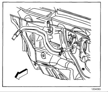

hi im tring to change the heater core on my car but I need help I never change one thank you

HEATER CORE REPLACEMENT
TOOLS REQUIRED
J 38185 Hose Clamp Pliers
REMOVAL PROCEDURE
1.Drain the coolant. Refer to Draining and Filling Cooling System in Cooling System.
2.Use J 38185 in order to position aside the heater hose inlet and outlet clamps at the heater core.
3.Disconnect the inlet and outlet heater hose from the heater core.
4.Remove the RH Instrument Panel Closeout/Insulator panel.
5.Remove the LH Instrument Panel Closeout/insulator panel.
6.Remove the floor carpet.
7.Remove the rear floor air outlet duct from the holes in the floor reinforcement.
8.Disconnect the rear floor air outlet duct from the heater core outlet cover.
9.Remove the rear floor air outlet duct.
