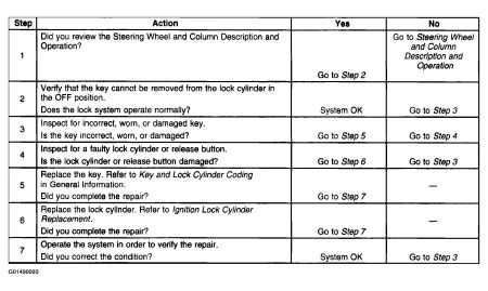

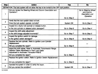

When l go to turn my car off it will shut down but the key will not return all the way for me to take it out l have to use a screw driver and in the steering column underneath l put the screwdriver in the hole and push up on a hit a button in their and then l can get my key out. Is this problem in the switch or is it in the column itself, can you tell me and let me know what has to be done

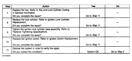

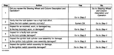

I suspect this is a fault on the lock release button .. let ...me know if you need to see any of the diagram's listed ??
http://www.2carpros.com/forum/automotive_pictures/266999_lock4_1.jpg
http://www.2carpros.com/forum/automotive_pictures/266999_lock3_1.jpg
http://www.2carpros.com/forum/automotive_pictures/266999_lock_4.jpg
http://www.2carpros.com/forum/automotive_pictures/266999_lock2_1.jpg
