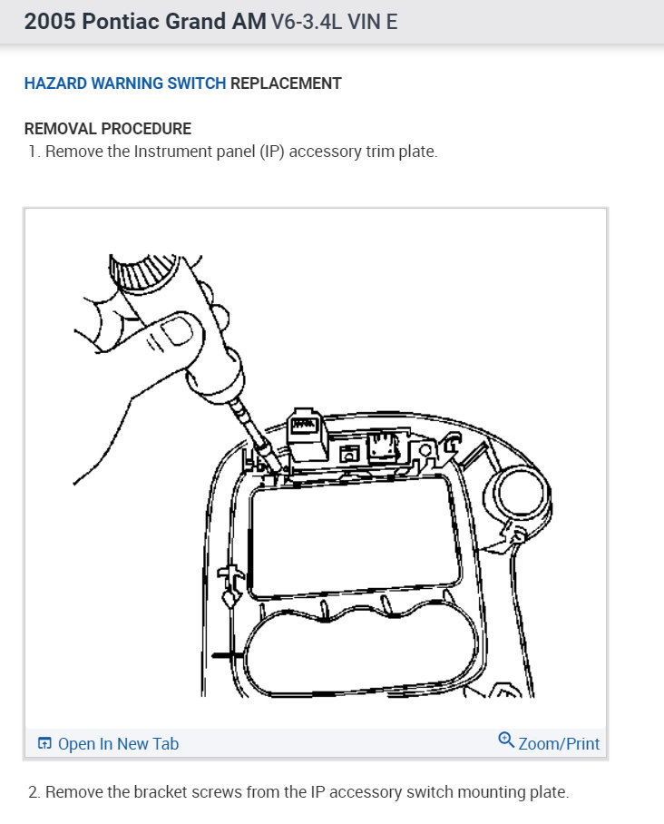

Is sounds like the flashers are on but they are not the sound comes and go's I need to replace it. I believe the hazard switch needs replacing. Just started doing the same thing a few weeks ago. Talked to a buddy who is a GM mechanic and he said that is the problem. Have not gotten around to fixing it yet though.

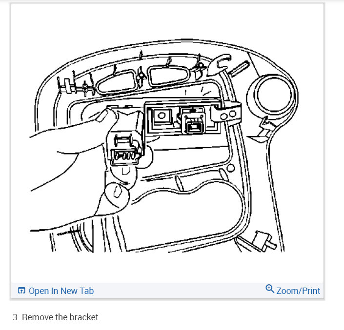

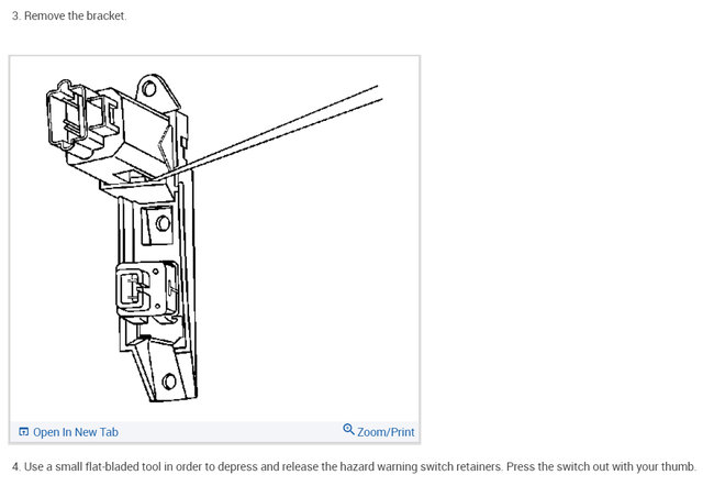

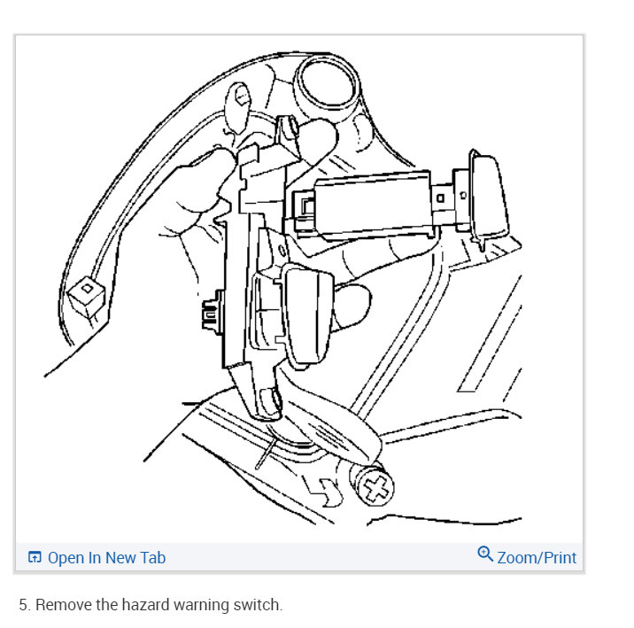

Does the sound change when you use the flashers? Do the lights flash in sequence with the sound? The flasher is interrogated into the hazard switch. Here are the instructions on how to change it out in the diagrams below. Check out the diagrams (Below). Please let us know if you need anything else to get the problem fixed.

Thank you fix it right up, I love this site
