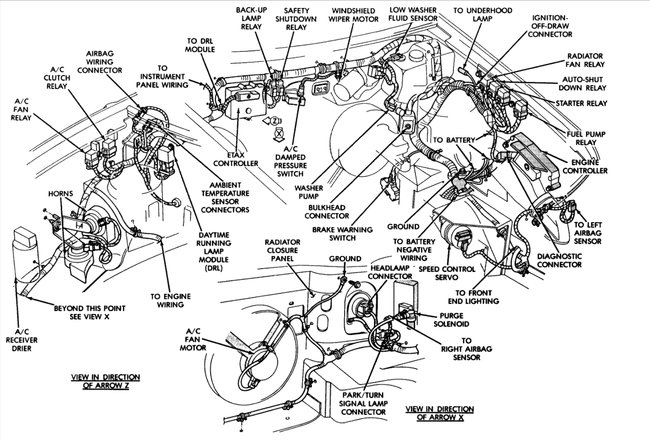

We believe that either our fuel pump relay or fuel pump is out. We know how to change the fuel pump but figured we'd try the relay first since it was a cheaper part to buy. I have the new relay part but do not know where to put it. I see two relays on the left side of the car and 4 on the right side. There are also two toward the back under the windshield. Could you please direct me to the specific one that I would need to change. Thank you so much.

Good idea, Here is the location which is under the hood on the drivers side and a guide to help you test it.
Here is the location (below)
Cheers
+1
Wednesday, August 8th, 2007 AT 5:16 PM
WENDELL MCNEAL
Thank you so much I bough a new relay and the van started, god bless 2carpros. I love you guys

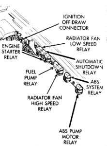

I would like to know the location of the fuel pump or relay on 93 plymouth voyager. I have look on both side of the van under the hood.

Relay Locations -- Under Hood On Left Fender Shield

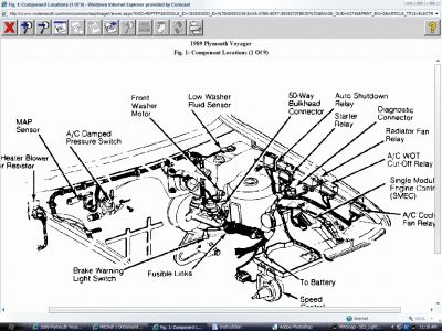

Where is e fuel pump relay located on a 1989 grand voyager SE 3.0. I can't find it and I have to jiggle the wiring harness to get the engine to start. Already replaced the fuel pump.

Power to the fuel pump is supplied thru the Auto shutdown relay, as shown here, but if wiggling the wires starts the pump, you have a bad wire, not a bad relay!

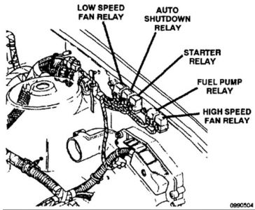

Where is the fuel pump fuse or relay located on a 1993 Plymouth Voyager?
Friday, November 10th, 2017 AT 7:05 PM (Merged)
  • 75,992 POSTS
https://www.2carpros.com/forum/automotive_pictures/12900_fp_29.jpg
