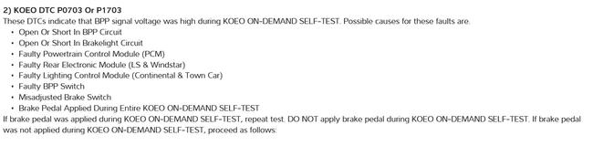

Brakes fade and pull slightly to left with the ABS pulse felt in pedal. Code reader - p0703 brake switch b input circuit.
What is the repair?

See pic it is not an ABS problem.
