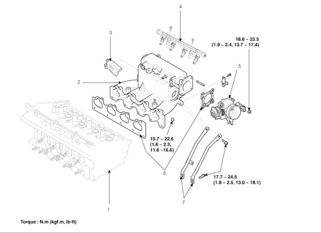

Hi, I have just purchased a new car listed above. The engine light is on, and I have done a scan and is coming up with the p0507 code. What do you recommend doing to fix this code? Thank you for your time.

The P0507 code means the idle control is too high which can be a vacuum leak, or the throttle body needs to be serviced. Here are three guides to help fix the problem with instructions for your car in the images below.
https://www.2carpros.com/articles/engine-idles-too-high
This guide will help you step by step to do the service for the throttle bore:
This guide do only when the engine is cold:
Clear the codes when the job is complete. Check out the images (below). Please let us know what you find. We are interested to see what it is.
