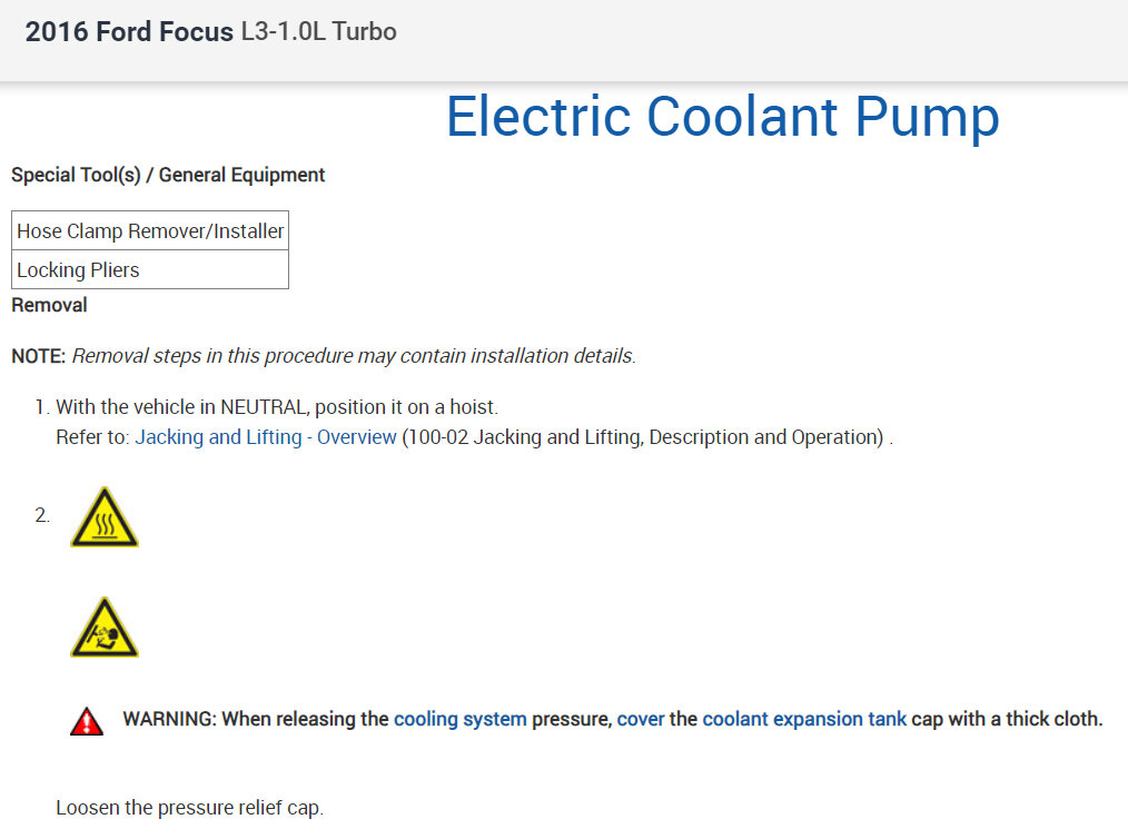

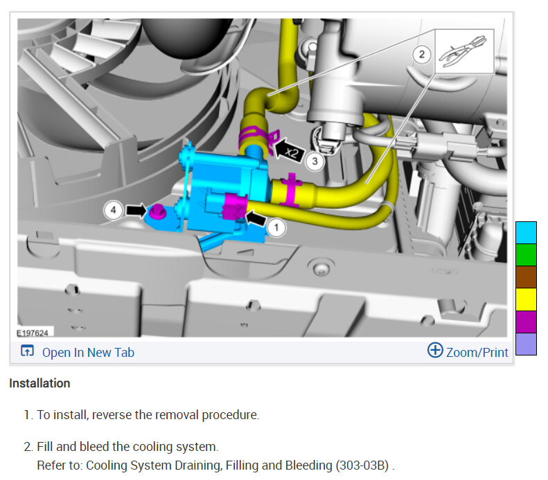

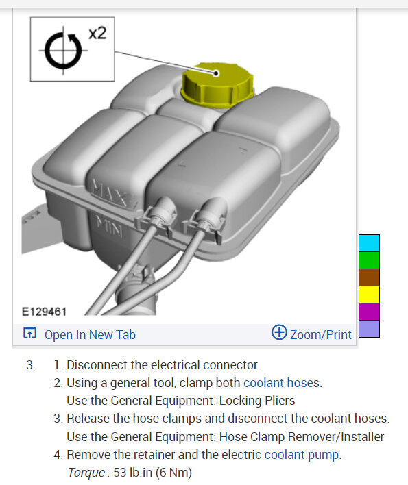

To check the auxiliary water pump you will need to remove it with is by the radiator cooling fan down low, it is a simple two wire pump so power and ground and it should turn on. Here is how to remove it for testing and replacement if needed. Check out the images (below). Please let us know what happens.

If one is power, then the other is ground. This guide can help tell you how to run the test, chances are the secondary water pump has gone bad:
Please go over this guide and get back to us.
