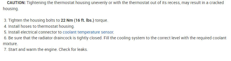

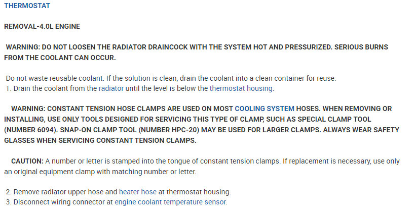

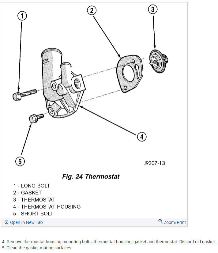

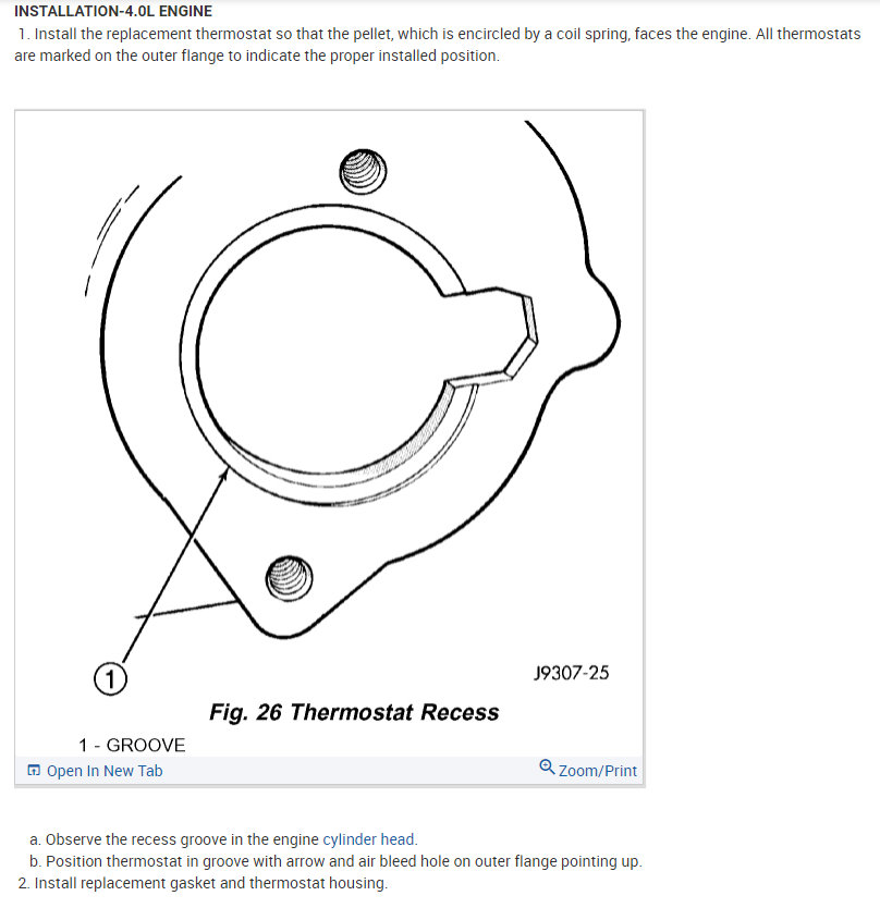

One of the most common reason for overheating is a faulty thermostat. I have attached the replacement procedure of the thermostat. Please keep in mind, you should first follow the guide (above link) to see if you can determine what might be the cause.
