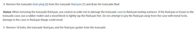

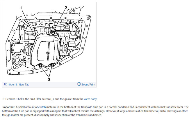

Good help there! Lets try this instead,
P1890 - Transmission Component Slipping
P1895 - Transmission Torque Reduction Signal Malfunction

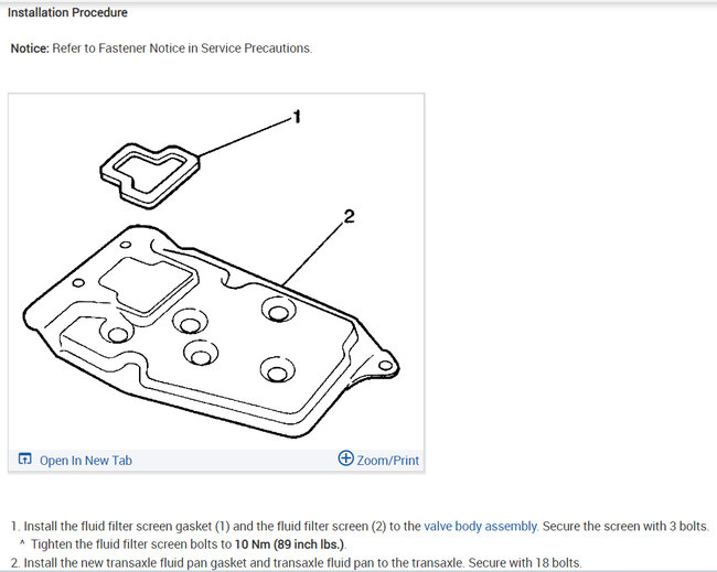

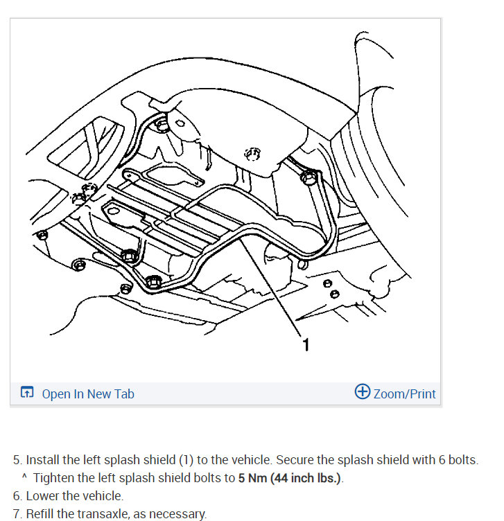

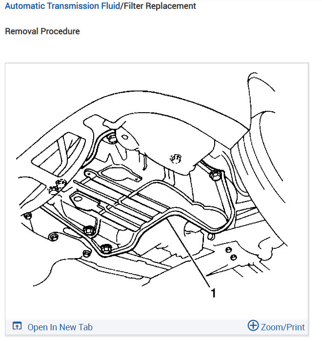

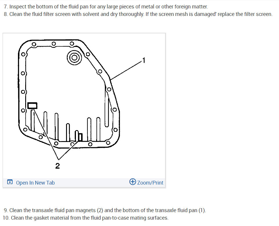

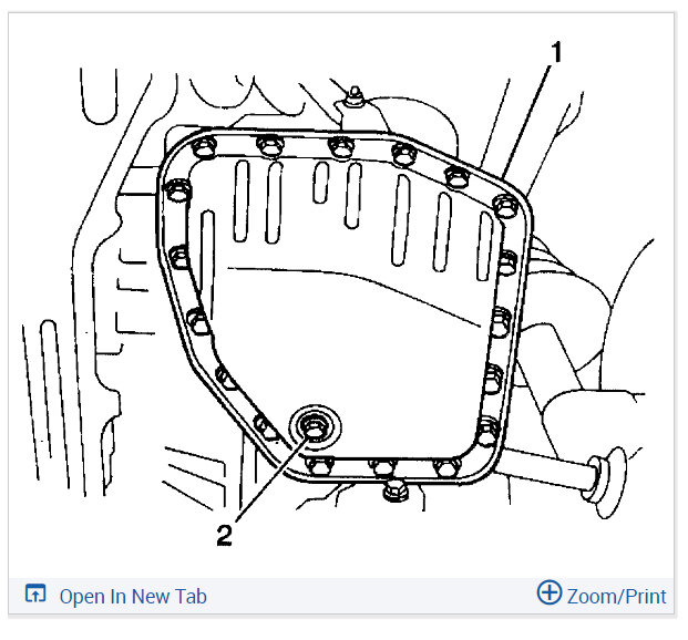

So, I would start by servicing the transmission and then clear the codes. Please go over this guide to help you:
Fluid Types
Transmission Fluid Type
Type .................... DEXRON III or Equivalent
Capacities
Transmission Fluid
3 speed .................... 2.4L (2.6 Qt)
4 speed .................... 3.1L (3.3 Qt)
