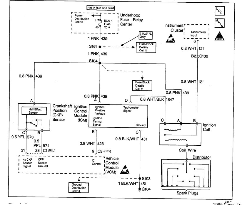

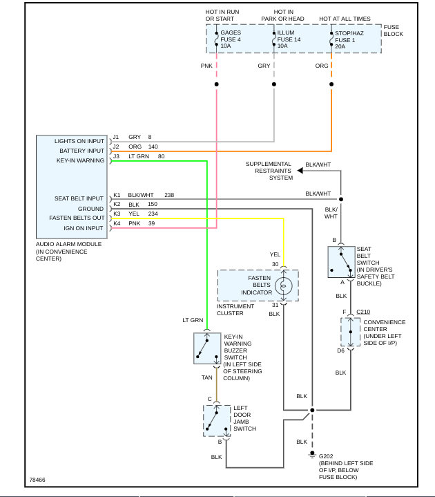

I may seem like a lost cause, I get rpm signal crazy and sometimes I don't get nothing.. noticed oil pressure gauge goes crazy too then back to normal..my test light lit up pointing to my feed for the ignition coil and ignition module and doesn't flicker while cranking. also the control wire (white) is lit with test light (key off) when turning the key on the light goes off from coil n module.. I checked the ground from module even while cranking the test light doesn't get dim.. i have no spark ..test light is lit while pointing to the 20a fuse on the ECM1.. with key on but when key off there's no light. I do not know what to do next.

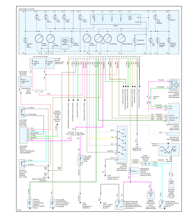

If your RPM is erratic and your other gauges is giving weird readings you might have a faulty Instrument Panel Cluster (IPC). When I worked in the Chevrolet Dealership I replace them on a regular basis. I'm attaching wiring diagrams below for you to reference and use manual external gauge to check readings to diagnose.
Please let us know if this information is helpful for you and what fixed your problem.
Thank you
Joe T.

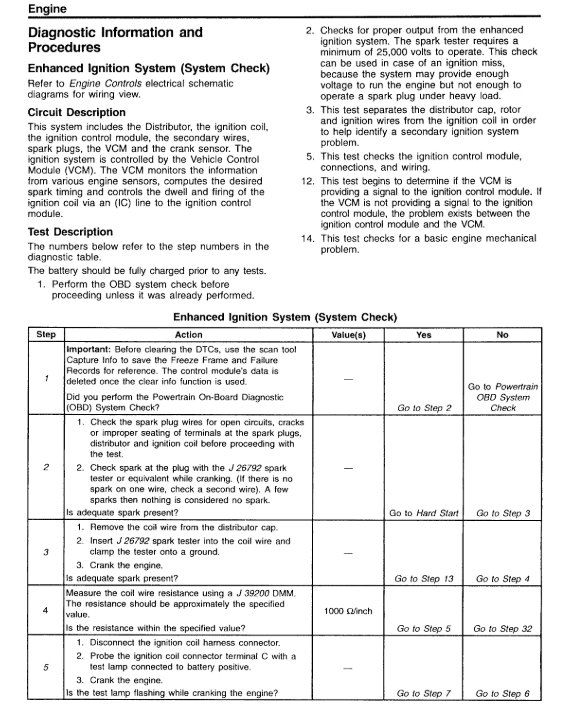

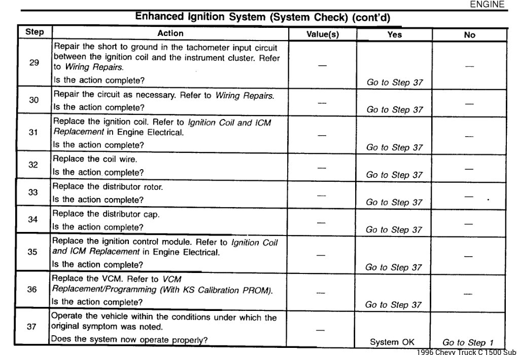

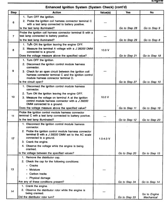

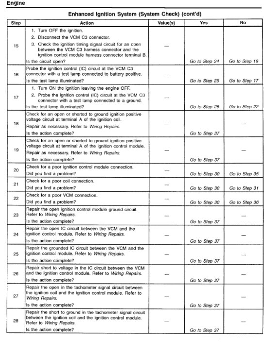

It's possible the distributor shaft broke or stripped drive gear, And not distributing spark or the crank sensor is shorted or have an open circuit and also not sending a signal, You will need to run diagnostics on the Ignition system, I'm attaching links and wiring schematic and ignition diagnostic charts for checking resistance and voltage drops on the ignition system below to help you test these components, also included information on Engine cranks but won't start enhanced diagnostics, Please let us if this is helpful and what fixed your vehicle or if you need more information.

If your not getting spark at the coil wire with a spark tester, You need to start checking primary voltage for the ignition system. Check the under hood fuse box ( Cell 10 20A ECM 1 fuse replace fuse if blown ), If the fuse is good, You need to check for 12 volts at the ignition coil connector, (Key on engine off), with a voltmeter check the pink wire to the black wire with white stripe for 12 volts, If you have 12 volts unplug the ignition coil check the resistance (Ohms) from the coil towler to the body of the coil, If you have any resistance at all replace the ignition coil, Next unplug the crank sensor check for 12 volts at the pink wire and black with white stripe for 12 volts if you don't have volts repair open wire, If you have 12 volts replace the crankshaft sensor, Next unplug the ignition module connector and check for 12 volts at the pink wire to the black wire with white stripe, (If you have 12 volts replace the ignition module),If you don't have 12 volts repair open wire, Refer to the wiring diagram it will you locate wires. Please let us know if this was helpful and if you need any more information.
