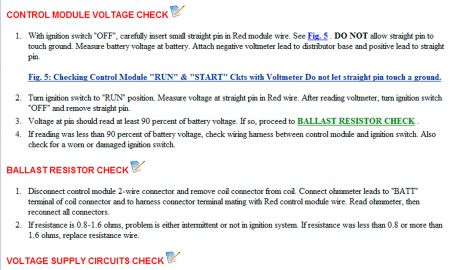

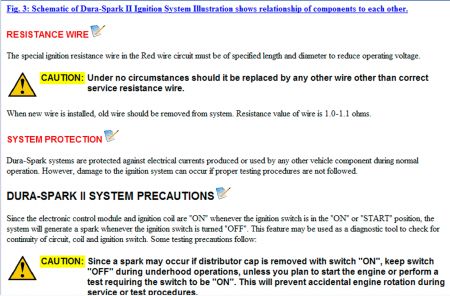

It's a ford, so there is only one starter wire connected from the ignition to the solinoid on the starter side of the switch. The wiring overall looks good, no crack's, burns or dry rot..My chiltons says to test the resistance on the ballast resitor wire ( note there is not an external ballast resistor).My diagram for the dura spark III shows the wire connected at the ignition and spliced in to the wire that charges the coil.
What color wires am I looking for and do I have to pull the instrument panel to get acces to and test the resistance of this wire ?
Sep 27, 2007 at 8:46 AM
MERLIN2021
  • CAR REPAIR CONTRIBUTOR
  • 17,250 POSTS
You are looking for a red wire, and it must be replaced with the right length and type!
