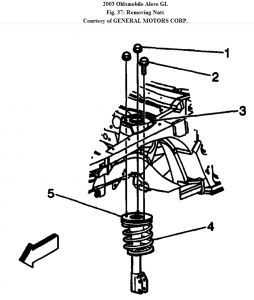

STRUT ASSEMBLY REPLACEMENT
Removal Procedure
1.Remove the nuts (1) and bolt (2) attaching the top of the strut assembly (5) to the body (3). 2.Raise and support the vehicle. Refer to LIFTING AND JACKING THE VEHICLE in General Information. 3.Place jack stands under the front crossmember. 4.Lower the vehicle slightly so that the weight of vehicle rests on the jack stands and not on the control arms.
NOTE: Care must be exercised to prevent the drive axle joints from being over-extended. When either end of the shaft is disconnected, over-extension of the joint could result in separation of the internal components and possible joint failure. Drive axle joint boot protectors should be used any time service is performed on or near the drive axles. Failure to observe this can result in interior joint or boot damage and possible joint failure.
5.Remove the tire and wheel assembly. Refer to TIRE AND WHEEL REMOVAL AND INSTALLATION in Tires and Wheels. 6.Remove the brake line bracket.
Fig. 37: Removing Nuts & Bolt Attaching Top Of Strut Assembly
Courtesy of GENERAL MOTORS CORP.

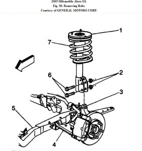

7.Scribe the strut flange. Refer to STRUT AND KNUCKLE SCRIBING. 8.Remove the bolts (6) and the nuts (2) attaching the strut (1) to the steering knuckle (3).
NOTE: Care should be taken to avoid scratching or cracking the spring coating when handling the front suspension coil spring. Damage can cause premature failure.
IMPORTANT: The steering knuckle must be supported in order to prevent axle joint over-extension.
9.Remove the strut (1) from the vehicle.
Fig. 38: Removing Bolts & Nuts Attaching Strut To Steering Knuckle

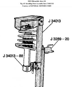

1.Remove the strut assembly. Refer to STRUT ASSEMBLY REPLACEMENT. 2.Mount the J 34013-B into the J 3289-20 . 3.Install the strut assembly into the J 34013-B using the J 34013-88 . 4.Compress the coil spring.
Fig. 43: Installing Strut Assembly Into J 34013-B

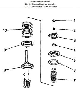

5.Remove the dust cap (1). 6.Remove the strut rod piston nut (2). 7.Release the compressed spring (10). 8.Remove the strut assembly from the J 34013-B . 9.Remove the following components from the strut:
The strut mount (3)
The dust seal (4)
The spring seat (5)
The upper insulator (6)
The coil spring (10)
The spring bumper (7)
The lower insulator (9)
Fig. 44: Disassembling Strut Assembly
IMPORTANT: Make sure that the spring seat "flat spot" faces outboard toward the strut mounting bracket, while the strut mount "flat spot" faces inboard away from the mounting bracket, when assembling the unit.
