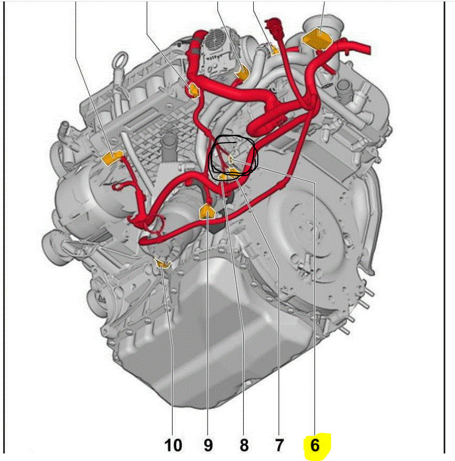

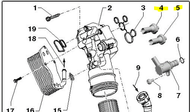

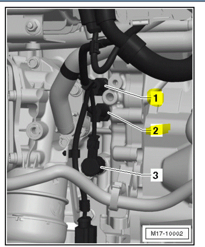

It's behind the alternator, below the intake, at the rear of the engine. See pic 1. In pic 2, I highlighted two connectors. Number 1 is the oil pressure switch and number 2 are the reduced oil pressure sensor. Number 1 will be blue, and number 2 is brown.
As far as replacement, simply disconnect the electrical connector and the sensor (using a deep well socket) will screw out.
I added pic 3 so you could get a better view of what the sensor looks like.

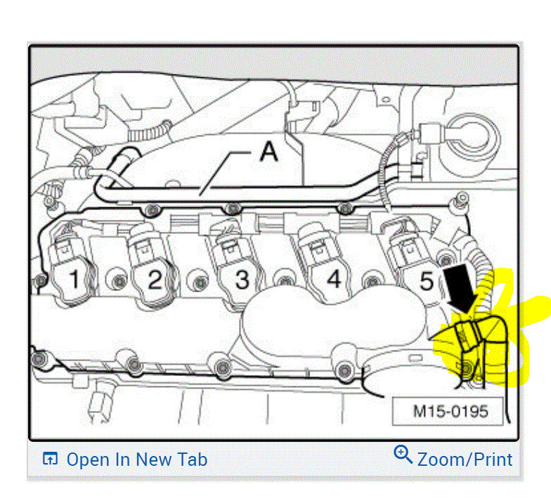

Also, make sure the PCV or according to VW (crankshaft housing vent) isn't plugged and isn't restricted.
Let me know what you find. Also, let me know how much condensation was found under the valve cover.
See pic below for PCV hose location.
Mar 7, 2022 at 4:36 PM
