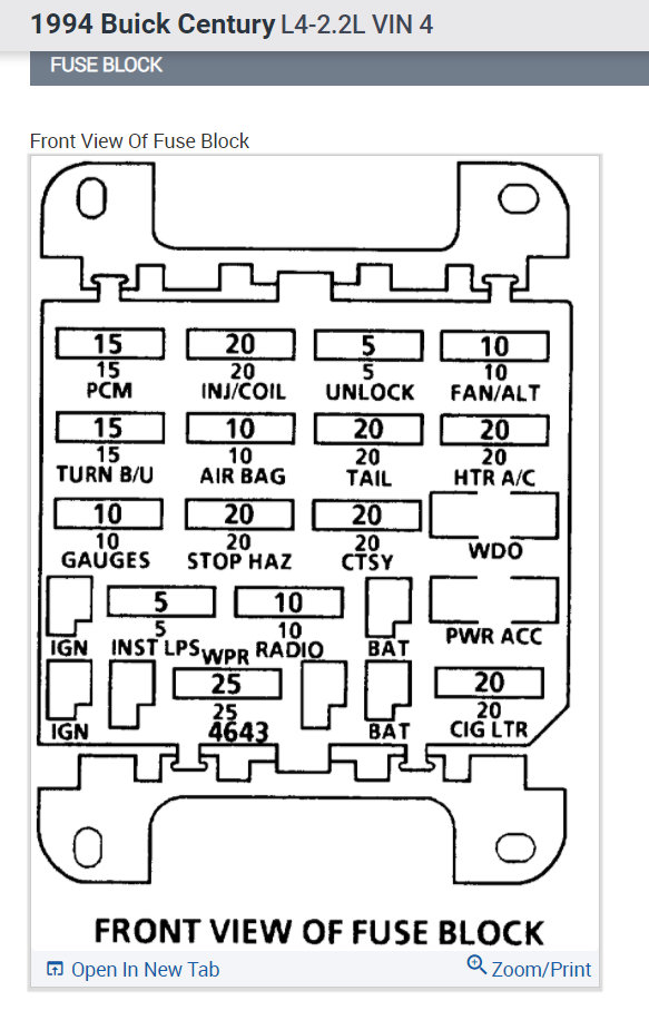

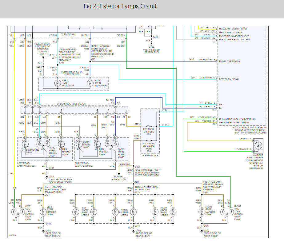

My brake lights and everything work fine. But my running lights will not turn on. I've changed fuses, traced the wires. I'm at a loss. Do I just need a new fuse box?

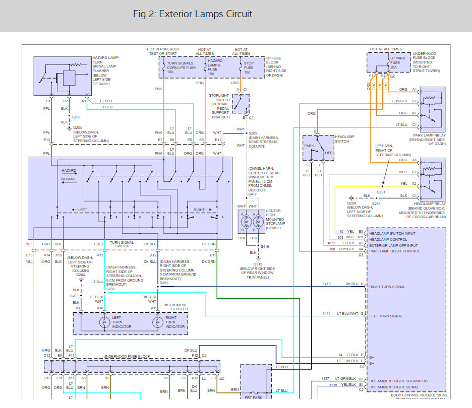

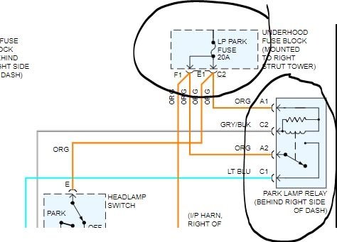

It's unlikely the fuse box is bad. Do me a favor. I attached a small portion of a wiring schematic. Reconfirm the fuse is good (power to both sides) and check the parking light relay.
If you have another relay with the same part number, just switch them to see if that makes a difference.
Here are a few links you may find helpful. Remember, a fuse can look good and be bad. That is why you need to check for power to both sides of it or remove it and check for continuity.
______________________
If the fuses are good, I suspect it is the relay. Let me know what you find or if you have other questions.

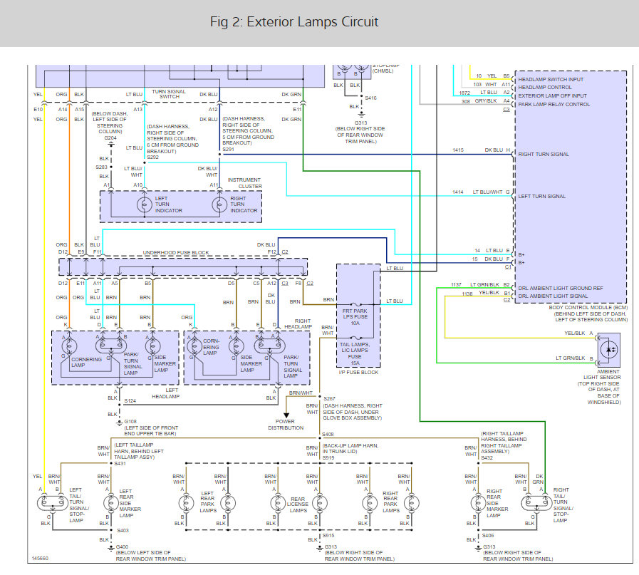

I have a 2001 Buick century custom. I have no rear 'running' lights however my turn signal and brake lights are fine. I located and tested the 'dimmer' fuse and do not have any power going to the fuse panel. Any thoughts or advice on how to fix and what I would need to do to fix it?

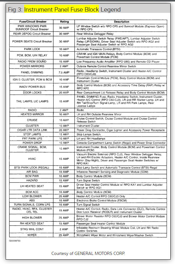

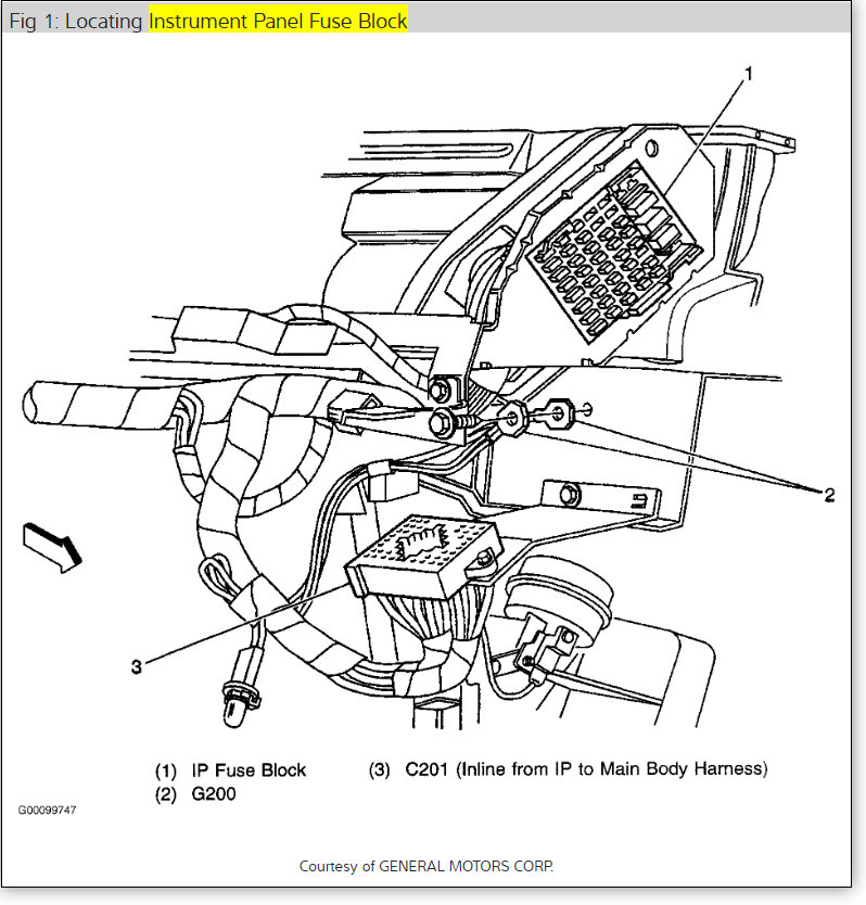

Have you checked your parking light fuse yet? Here is a guide to help you check the fuse and the fuse location and running light wiring diagrams so you can see how the system works below:

Yes, I checked and replaced fuses and it fixed two of the problems I was having the running lights now work, and the instrument panel illumination lights also now work. (They went out about a month ago, and I checked all the fuses then but It must not have been burned out completely since they went at separate times). Thank you very much Saturntech9, and hopefully me explaining this may help someone else as well! They are working now, thanks again!

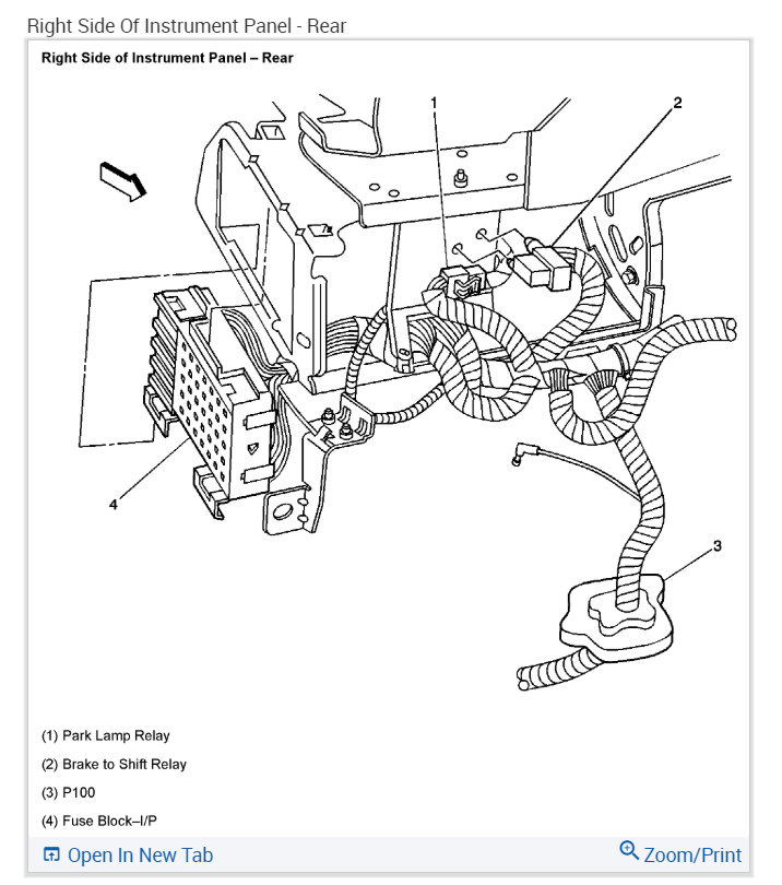

My running lights in my 2003 Buick Century dont work, but every other light does and I cannot seem to find the fuse slot for it. I just replaced the wheel hub assembly and the ignition lock cylinder. I'm not really trying to spend anymore. Can anybody help me?

There is a parking lot relay that needs to be checked. here is a guide to show you how with the relay location and the running light wiring diagrams so you can see how the system works:

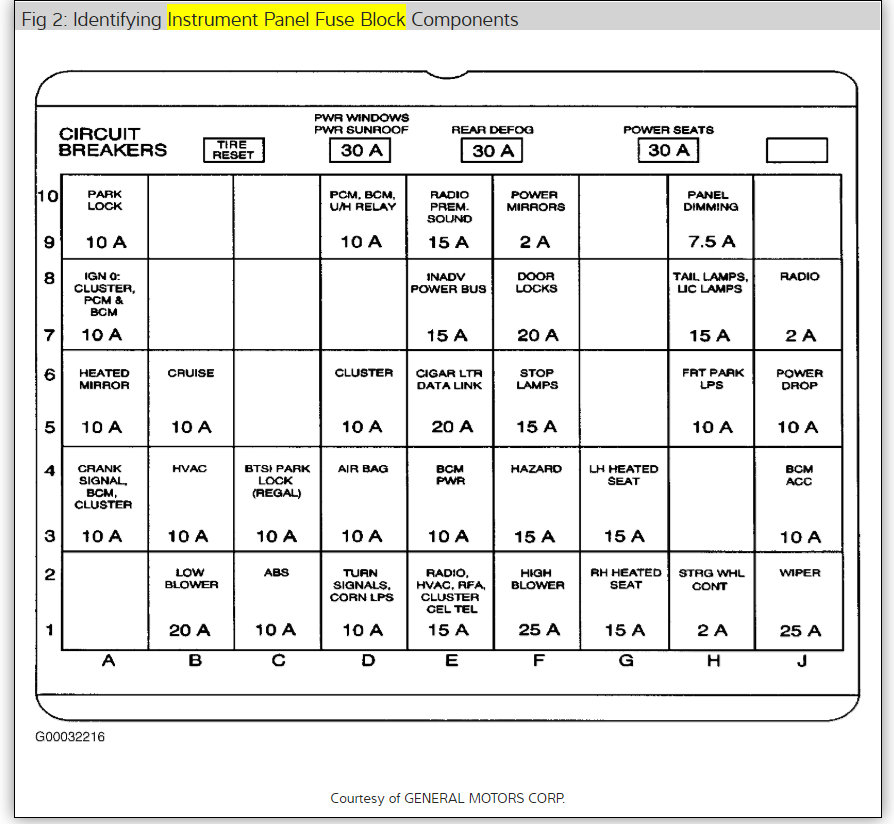

Did you find a tail lamp fuse? The circuit for that fuse, should be hot all the time. You can use a testlite on the fuse, there is usually a bare spot over each fuse leg, where you can check for voltage without removing the fuse. You can check the circuit by removing the fuse,but, only one leg will be hot, if you leave the fuse plugged in, both legs should be hot. This guide will help with the fuse locations in the diagrams below.
Check out the diagrams (Below). Please let us know what you find. We are interested to see what it is.

I believe i found the tail lamp fuse, but unfortunately the fuse prevents me from accessing it with a volt meter. if I pull the fuse and put the probes from the voltmeter in, then hit the brake, the voltmeter shows a solid ~12 volts.
May 21, 2021 at 3:28 PM (Merged)

I looked at your picture, if there is a fuse that says( tail), that should be it. You can pull the fuse and use the meter in series on the circuit terminals, voltage setting. With everything turned off, if that circuit went to ground, the meter would show system voltage. It shouldn't show that with everything turned off.
You could use chassic ground for your meter, the positive lead on the circuit leg, one at a time, see if anything is hot?

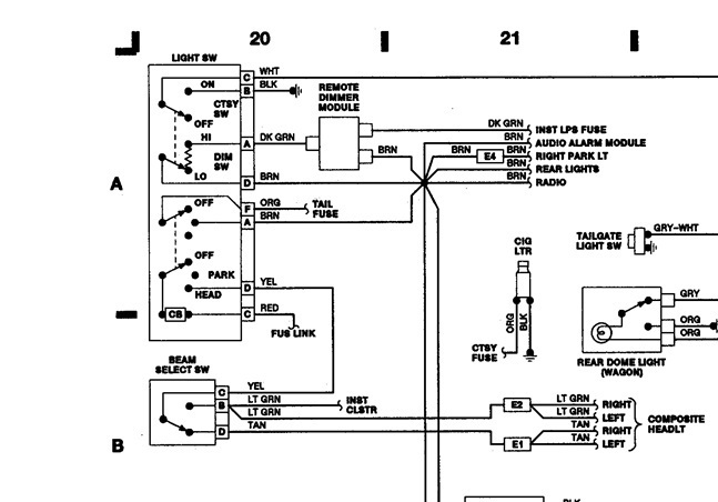

My tail lights went out as well as my dash lights. The fuses and bulbs are all fine. The head lights, brake lights, and turn signals are working fine. Any idea what my problem could be? As far as I can see none of the wiring has been pinched. Someone suggested that maybe the headlight switch needs to be replaced. Any leads would help. Thank you for your time.

I'd check the connector at the headlamp switch. You could probably use a jumper on the proper terminals to get the dash and or tail lamps to come on. Did you check the applicable fuse/s for voltage?

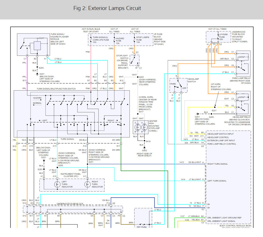

Here is some wiring. I agree with Ras.
May 21, 2021 at 3:29 PM (Merged)
  • CAR REPAIR CONTRIBUTOR
  • 75,992 POSTS
Check for additional power coming out of the switch that powers the tail and dash
CLINT BLADES
I dont think I was getting a good connection when I was crossing the contacts. I tried it again and got the taillights to come on. It has to be the switch, which I am replacing tomorrow. Thank you so much for your time and advise!
